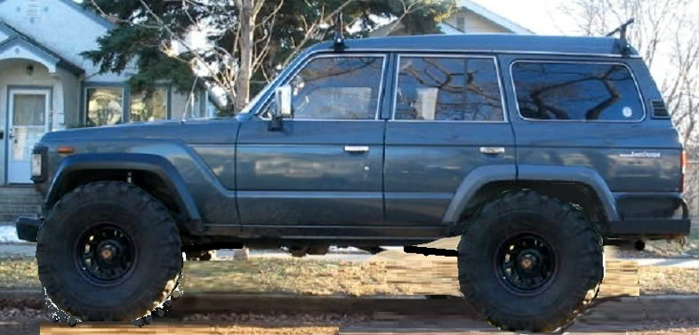

yea mine is a little tall SOA with OME springs with 37" iroks... I need to lower the back a little and i think i will be happy with it...

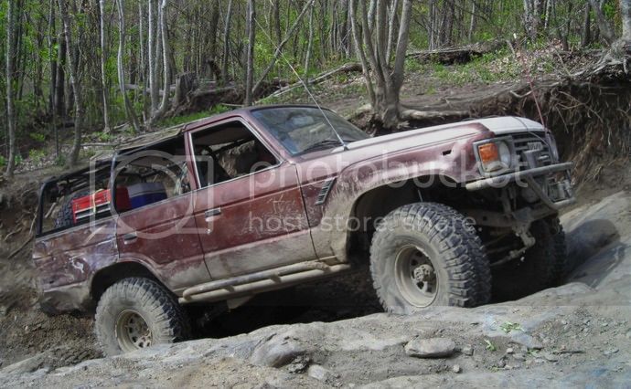

No build thread. Kind of slowly evolved in stages.
rear shocks are Ford Super Duty. I forget what year and details. Just happened to measure them the other day. They are 29" extended, 17"compressed. Mounts on frame moved up.
Wheel backspacing is 3 1/2"
Teetering truck shot. About the closest I could find to a flex shot

There is a 3" body lift. Axles are in original location. Bump stops unmodified.
Rear tires stuff well. Light rubbing on the inner fenderwells driving off camber.
Front rubbing was bad against the radiator support mounts. Now it's not as bad since i moved them up 3". It still does rub on the front springs sometimes fully compressed with the wheels fully turned.
The 63" Chevy springs are 3" lift springs with all 5 leaves left in.
The only thing undesirable is when loaded down with spare parts and gear, it was too flexy at highway speeds. Air bags took care of that. It could be the 45 deg shackle angle that made it too flexy. Just allow for the springs settling an inch or two when setting it up. If I find the 63" Chevy lift thread, I'll PM you the link.

I was running the Michelin 325/85R16 XMLs that measured almost 39" prior to the toyos. I had OME heavy/heavy and it was WAY to tall. I also have a 2" body lift that helps alot..
