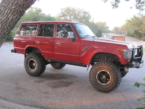

hopefully in the next couple of weeks I will do exactly that, cut and box the front corners to make a set of 39.5" iroks fit... I will keep you updated as it's pretty tight in there already. This is with 37" at full stuff and a 2" body lift. some trimming is going to be needed!
awesome! thanks for the pic, cant wait to see it done. that tire looks huge! lol

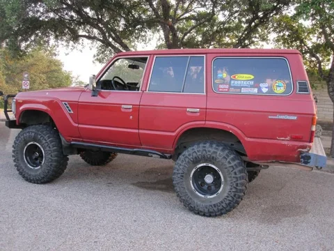

Here's the way mine sits right now. What do you guys think can I go larger without having to alter anything?
and yes I plan on removing those stickers when I get back home.
