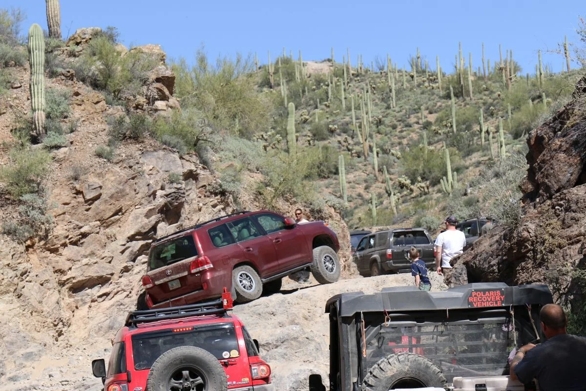

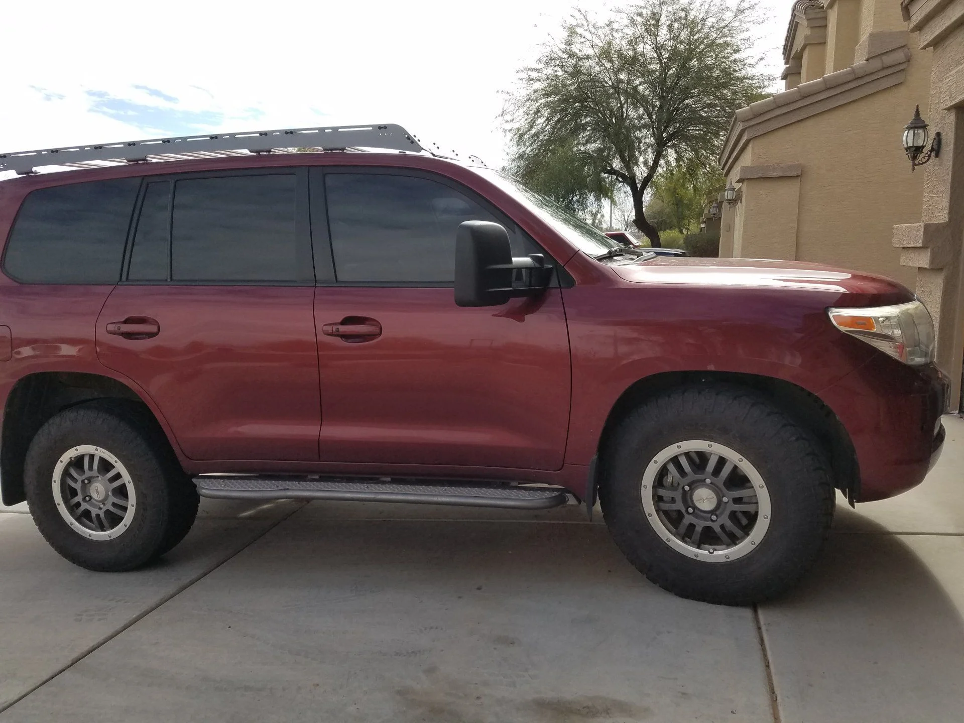

35x12.50x17 tucked in the rear. Photo credit @kreiten
