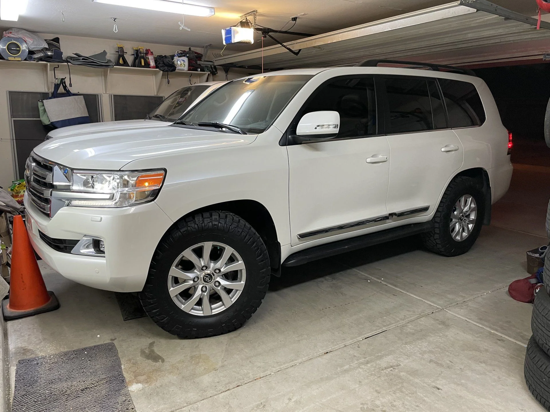

I ran 285/70/18 RGs on my stock 16 with only the mudflaps removed and only barely rubbed in the front which was easily molded away. I put BP51s on and didn't have any rubbing though it looked like Slee trimmed the front bumper slightly in a couple places which probably helped more than I realized. I eventually added the 0.75" Bora spacers after about a year and felt it worked and looked better, but I didn't have any issues stock. This picture is 100% stock on 285/70/18 RGs without running boards.

Which tow hooks are those?

I stand corrected. i had 275/65/18 and I didn’t think there was another vertical inch there to the uca.

Removing those running boards definitely improves the look in my opinion. Great...one more thing to do this weekend!
