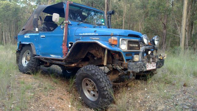

Heres mine. BFG 33X9.50 M/T's on stock steelies, stock springs, extended shackles. BFG 33X9.50 A/T's on my Expedition trailer.

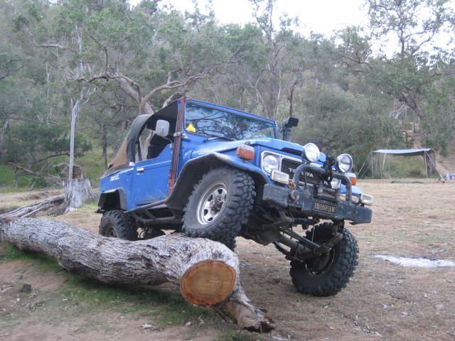

34x10.5r16 swamper ltb's
i reckon they measure 33' and are skinnier than my 33x10.5r15 jungle trekkers2's.
