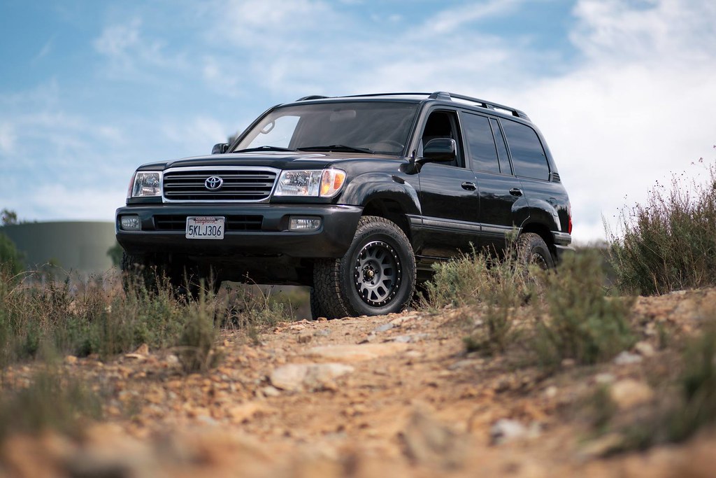

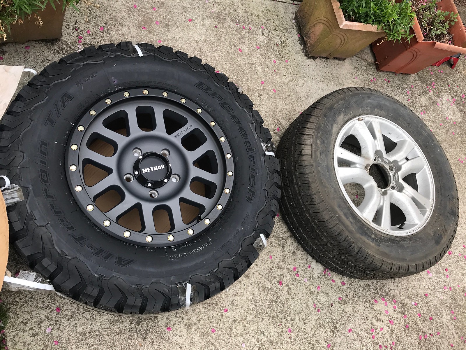

Wanted to update everyone on having trouble with Discount or other "chain" stores not mounting 305/65r18 to the factory wheels. I did some research and headed to Discount Tire to get a set of KO2s. They provided the quote and when I proceeded to order and schedule he let me know their system blocked the order and my factory wheels wouldn't work. I asked him to check their fitment guide. On Discount system he pulled up the guide which stated a 305 tire can be mounted on a rim with a minimum with of 8 and max of 11. After getting the approval from management I am getting these installed tomorrow!!! Try this approach if you have a Discount Tire near you and are in the market for 305's on factory wheels! Pics to come...
I've got Method grids +18mm with 305/65/18's in the mail, Discount tire say should be here in a week. Can't wait, probably rub with that setup but i dont think it'll be too bad.

Little early here, but lost ya for a bit lol...i know people run this setup on stock which is +60mm without rubbing but with the more aggressive +18 it'll stick out past the fender a little, i like that wide stance.

Yeah, I’m sure you will get some rub at +18. Nothing that can’t be fixed though. My methods are +25. I think that might be the way to go for no rub and no massaging of anything. Were the Grids not available in +25?

Yeah only available in 0 and 18, i think it'll be okay 7mm is 1/4" ? i'll take a BFH to the pinch weld and i'll roll the fenders if i need to.

Oh no doubt. BFH works wonders. Pinch weld mods are the best 🍺
The grids look really good, similar to the Icon 6speed but in 18s, not sure if the icons come in 18s or not, only see 17s for our bolt pattern
