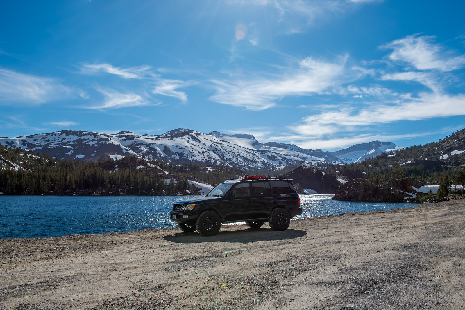

Im the original poster and I run a 2.5” lift. No issues. 4 years and 3 months later I’m still running the same set. They have about 35,000 miles and still have over 50% tread with 5 tire rotation.
Are you running stock or aftermarket wheels? I'm planning to run 18" SCS Ray10s. Can you please post a pic of your rig now? Thank you
Aftermarket wheels rarely have the proper offset for these tires. Stock makes them work perfectly. If you have any other, make sure they are exact make.
Thanks for the pic. Great looking truck. Offset on the Ray 10s are +25, and I was told will be aggressively sticking out a bit from the wheel well. Do you think that will rub or be an issue? Thank you
