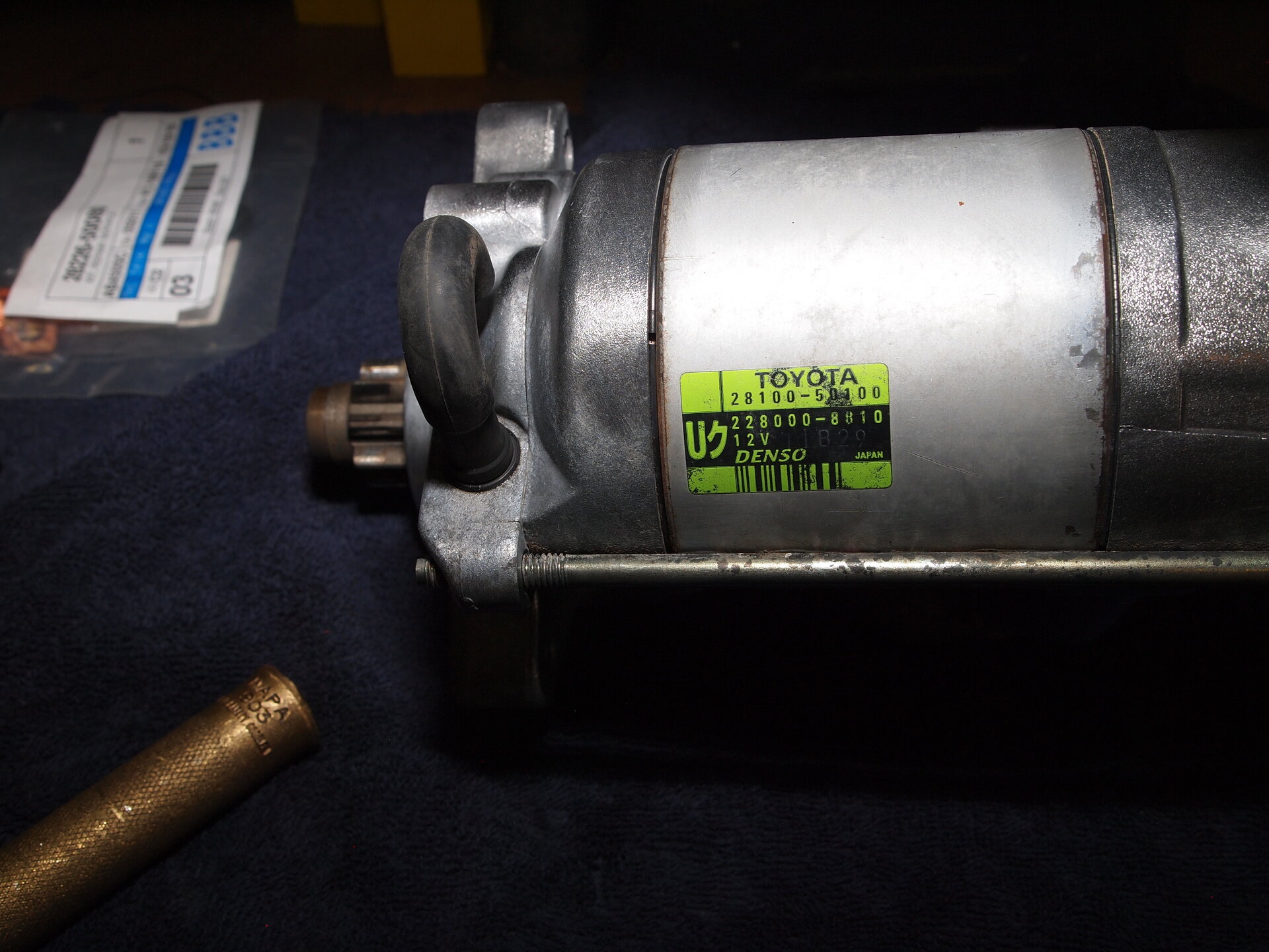

All parts suppliers sub to the newer 28100-50101 starter, for all years. Which has different size contacts, OEM not sold separately. In those newer starter, Toyota sell the whole "SWITCH ASSY, MAGNET STARTER" which houses contacts, plunger and gears. Cost is about the same or more, as a remanufactures Denso starter. Aftermarket contacts & plunger, are available for them.
The older 28100-50100, we can buy OEM contacts & plunger. It's has more parts available, so more readily rebuildable. These are found in 98-02, verified by part number on them.
No USA suppliers sell new OEM starter. They're all -84, which denotes remanufactured.
Denso remanufactured starter. Rebuilder has discretion on what parts replaced.
Toyota Denso remanufactured starter. Rebuilder must replace parts specified by Toyota, at minimum.
