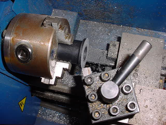

Got some grade 8, 3/8" bolts and turned the head down in the lathe and made some spring pins for the rear springs. It actually didn't take that long to put the springs back together. Used a clamp to hold the springs while I got the pin in and started, used the impact wrench and tightened them up. Cut the remaining bolt off with a cut off wheel.

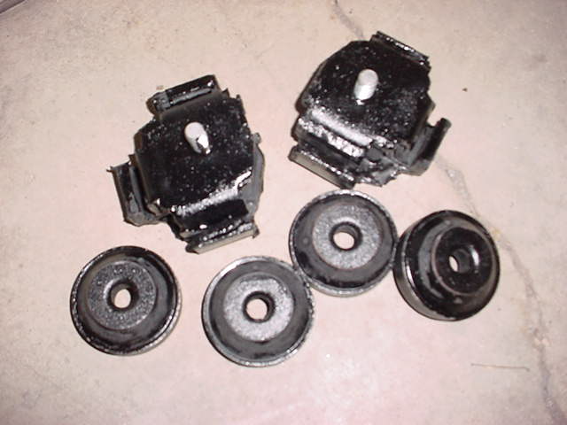

Few parts showed up today, mostly spring pins and bushings. Also motor mounts and tie rod ends. The paint was coming off the motor mounts in the box so I threw them in the cabinet blaster and cleaned them up. Hung up the mounts and tie rod ends in the booth. Waiting for a couple other parts to show up and plan on painting them all black at the same time....other parts should be here Friday and plan to paint them that night. All of the bushings had a 1/8" flange except 1 set of 4, had to turn the flange down in the lathe also.

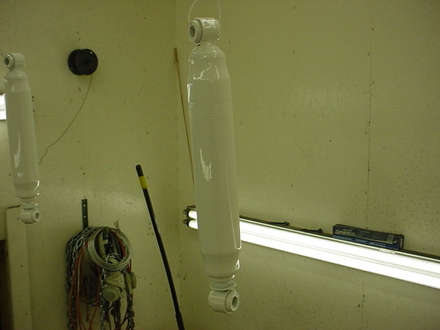

Shocks came today, which I expected. My eperience with shocks is that after a couple years of driving...most of the paint has flaked off and they look like sh-t. I took a scotchbrite pad and scrubbed/scratched them up. Shot a couple coats of DP48LF (white epoxy primer) and then a couple coats of clear/DCU2021. Look pretty much the same, but hopefully will last a little longer.
