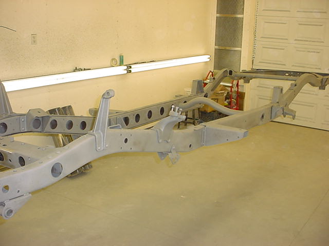

;) Got about 5 hours on the lpb this afternoon. Not anything major, but pretty much wrapped up what I needed to do on the frame.

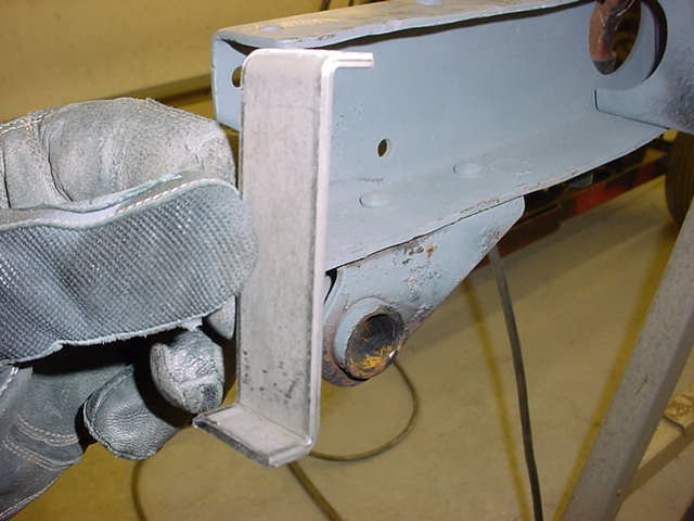

Blasted and primed the bracket that gets welded to the drivers side frame horn. Had to bolt up the center arm to make sure everything lined up. Once I had it where I wanted it, removed the center arm and welded it in.
Made the bracket for the passenger side. Not a big deal, but wanted it like factory. Pics pretty much say it all.
Cut out he key hole in the rear for the spare tire carrier crank. Used a 7/8" hole saw in the center and then the die grinder into the edges. Once I was close I used a hand file to get the corners square.
Torched the spring pins off the rear springs......just a bit of rust in between the springs. Drilled out several busted off bolts and re-tapped....few other misc. things to trivial to mention.

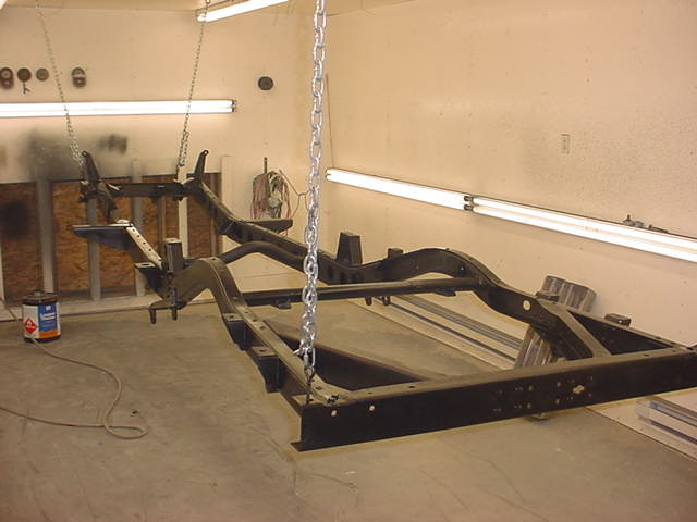

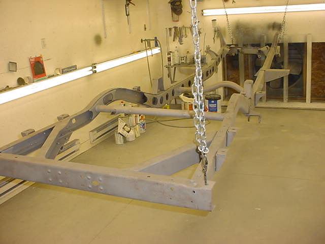

Pics of the frame hung up in the both, freshly sandblasted and then a couple coats of DP90LF epoxy primer.
Matt
