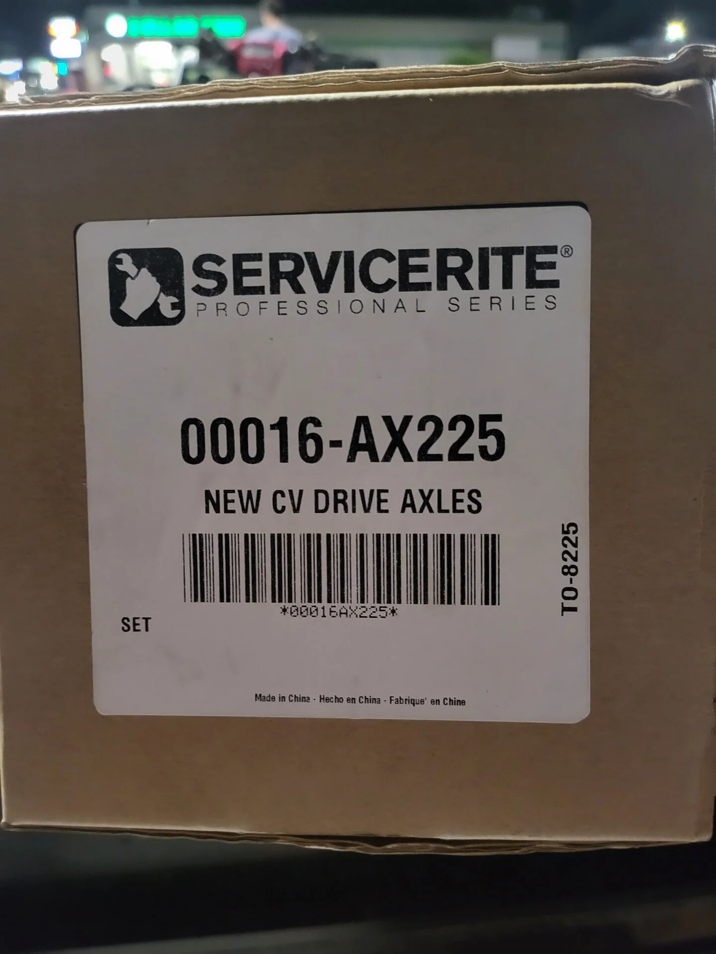

Just went look at the box the CV came in from the Toyota dealership.... You'll never guess what I found.
Well that's almost unbelievable, perhaps a call to Toyota corporate? Might see if you paid the price for OEM too.
I'm dumbfounded. I can't believe Toyota themselves put this s*** on my truck. I can semi understand the local shop, but the damn dealership!!!

Turns out all shafts were aftermarket. I was able to take a pic of the aftermarket shafts vs OEM not even CLOSE!!!
