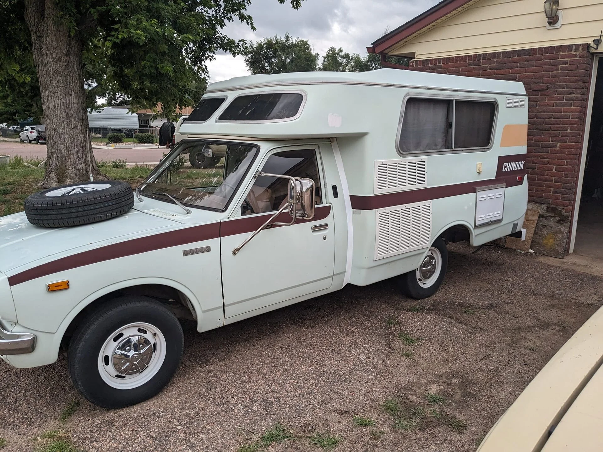

I just scored a 1977 chinook that is pretty cheery. I really want to SAS it. Can you SAS the 1977 2wd frame? I have everything to do a SAS for a 87. . Ill leave it alone if I have to swap the frame
