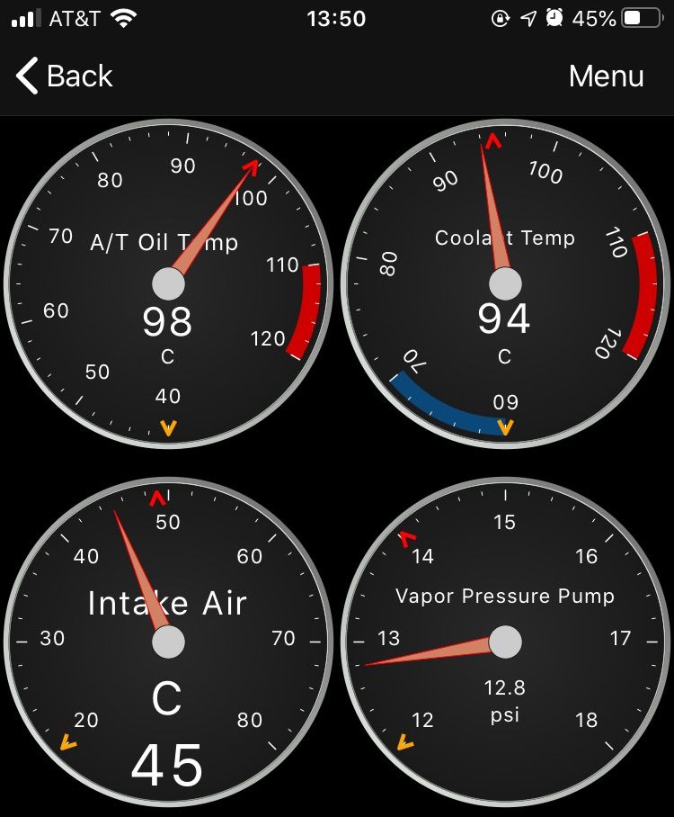

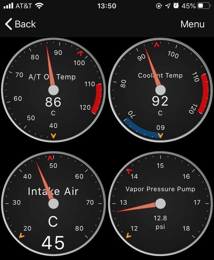

Thanks for the detailed information. How are you measuring trans temp, car soft, techstream bluetooth OBDII? I have a icarsoft but as best I can tell it does not measure a/t temperature-it says it does but the a/t and engine temp are the same(always) on my reader.
A/T fluid temp can ramp up very quickly as @geanes mentioned. Unlocked torque converter = quick ramp up, lock, quick ramp down. Some screenshots from last week's Baker grade I referenced above. First photo is 5th gear unlocked, second photo is 4th gear locked. Within the same minute time frame.
Scangauge mounted on steering column. You have to program the X-Code to get the transmission temps. I monitor Engine Temp, Intake Temp, Voltage and Transmission Temp.
