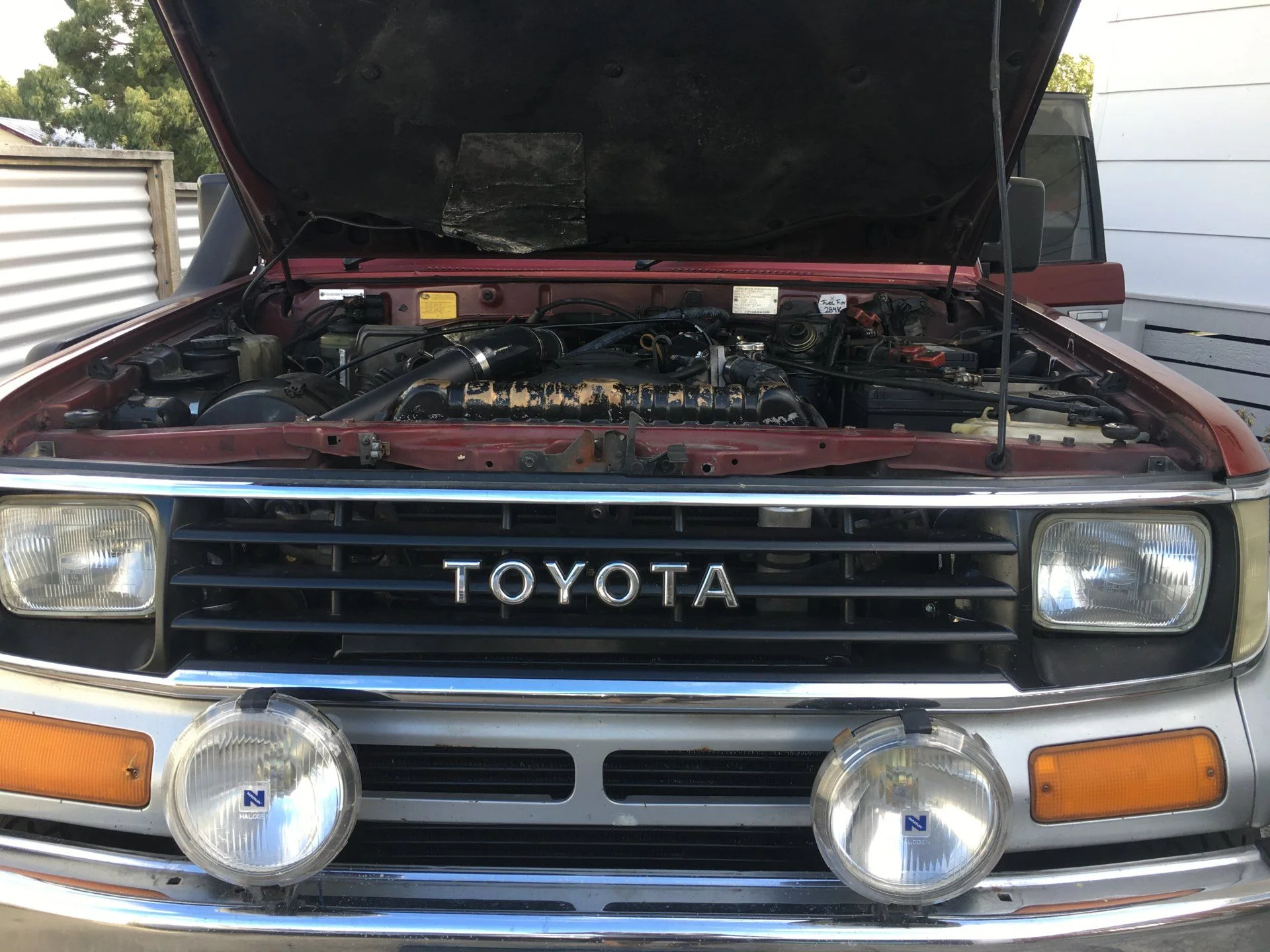

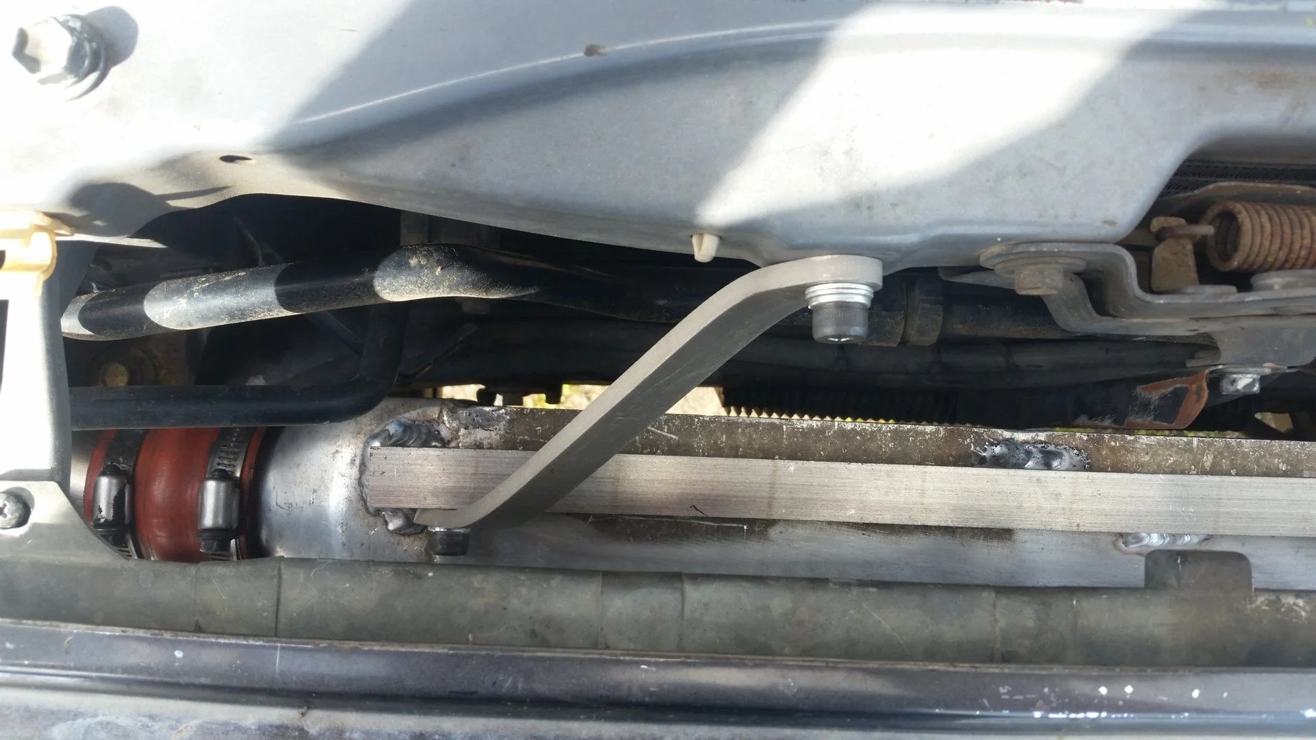

go for the front mount, im halfway through mine, just got to finish of the pipe work, minimal cutting on the front plastic grill and airconall still there with a good amount of space between radiator heat exchanger and intercooler
Intercooler is actually a modified aftermarket upgrade for an xr6 turbo ford falcon
Are you able to do a bids eye view looking down with the bonnet open? Also do you find that reduces the airflow to the radiator more/ any impact on running temps?

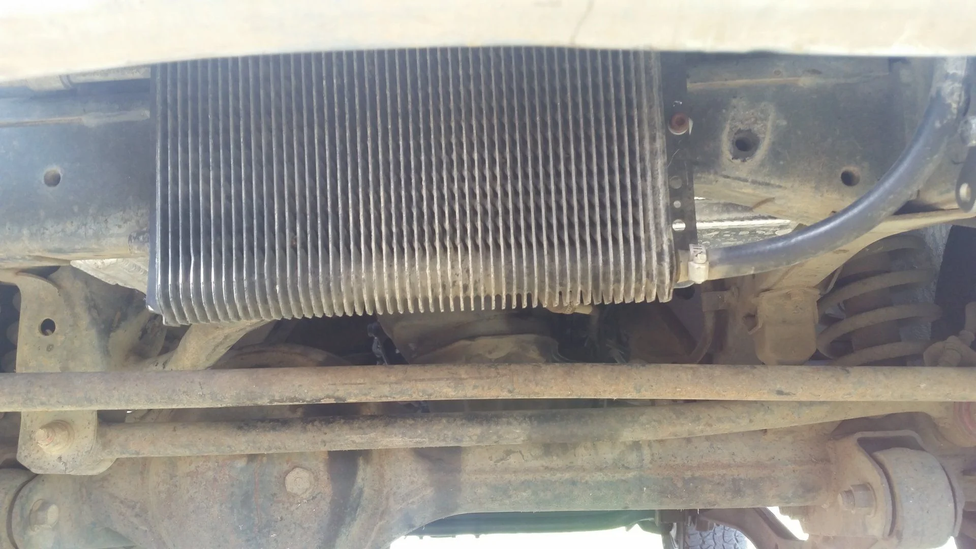

transcooler location, bolted to bottom crossmember, potential to get smashed to bits with serious off roading but the location seems to cool really well and its out of the way of the intercooler and aircon

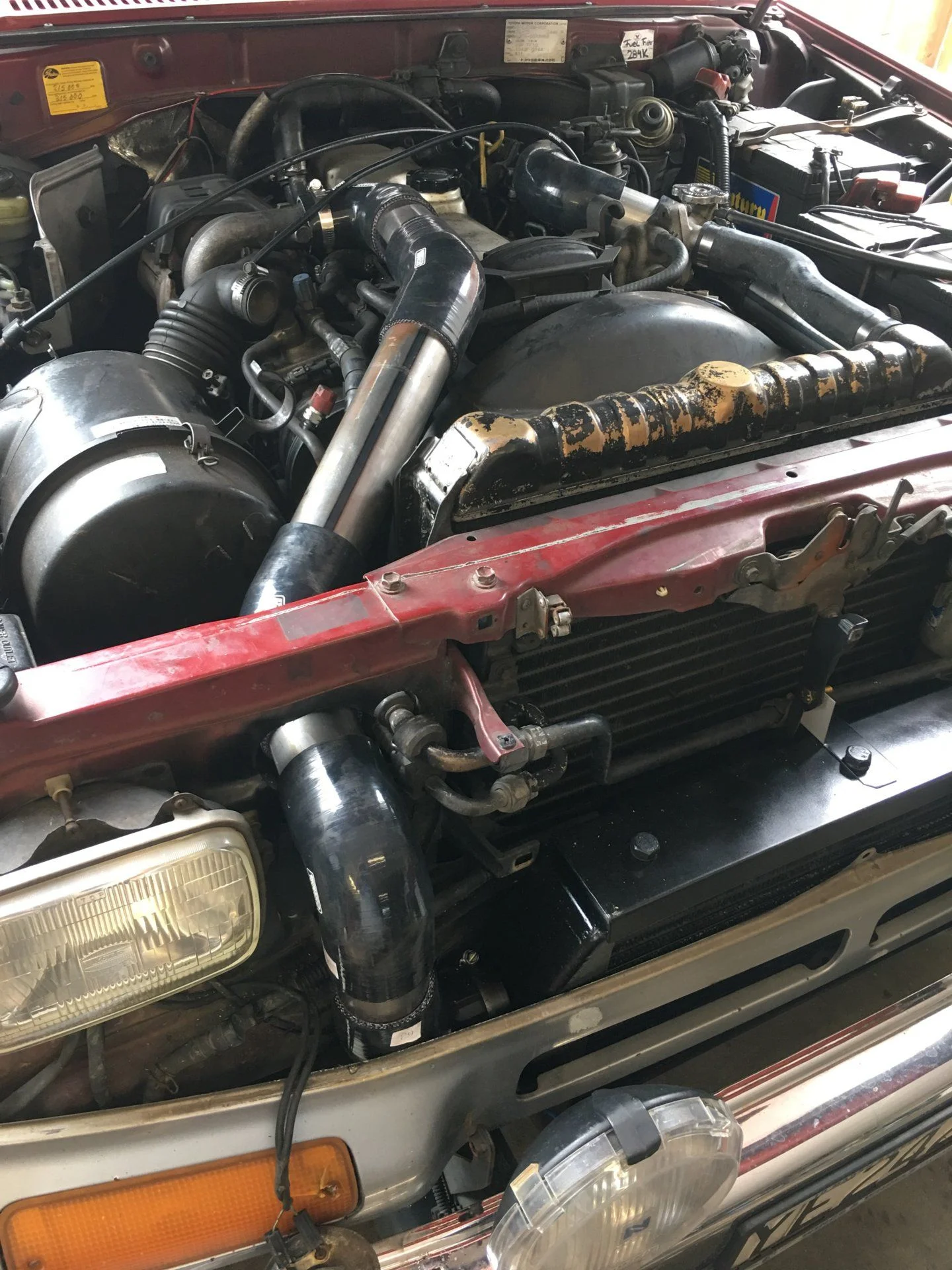

top view

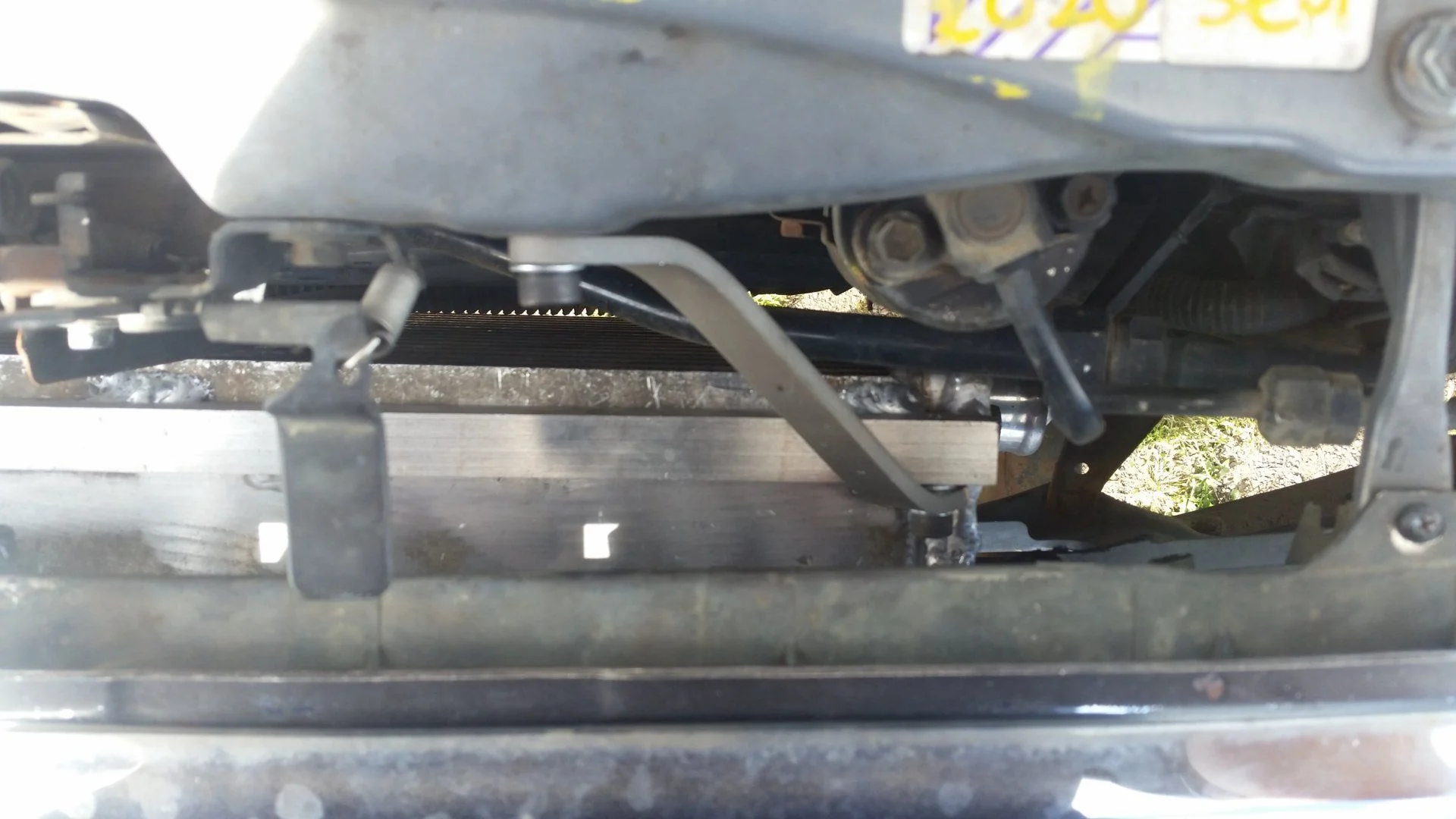

i had to trim the bonnet catch brace and i just bent the aircon pipes out of the way

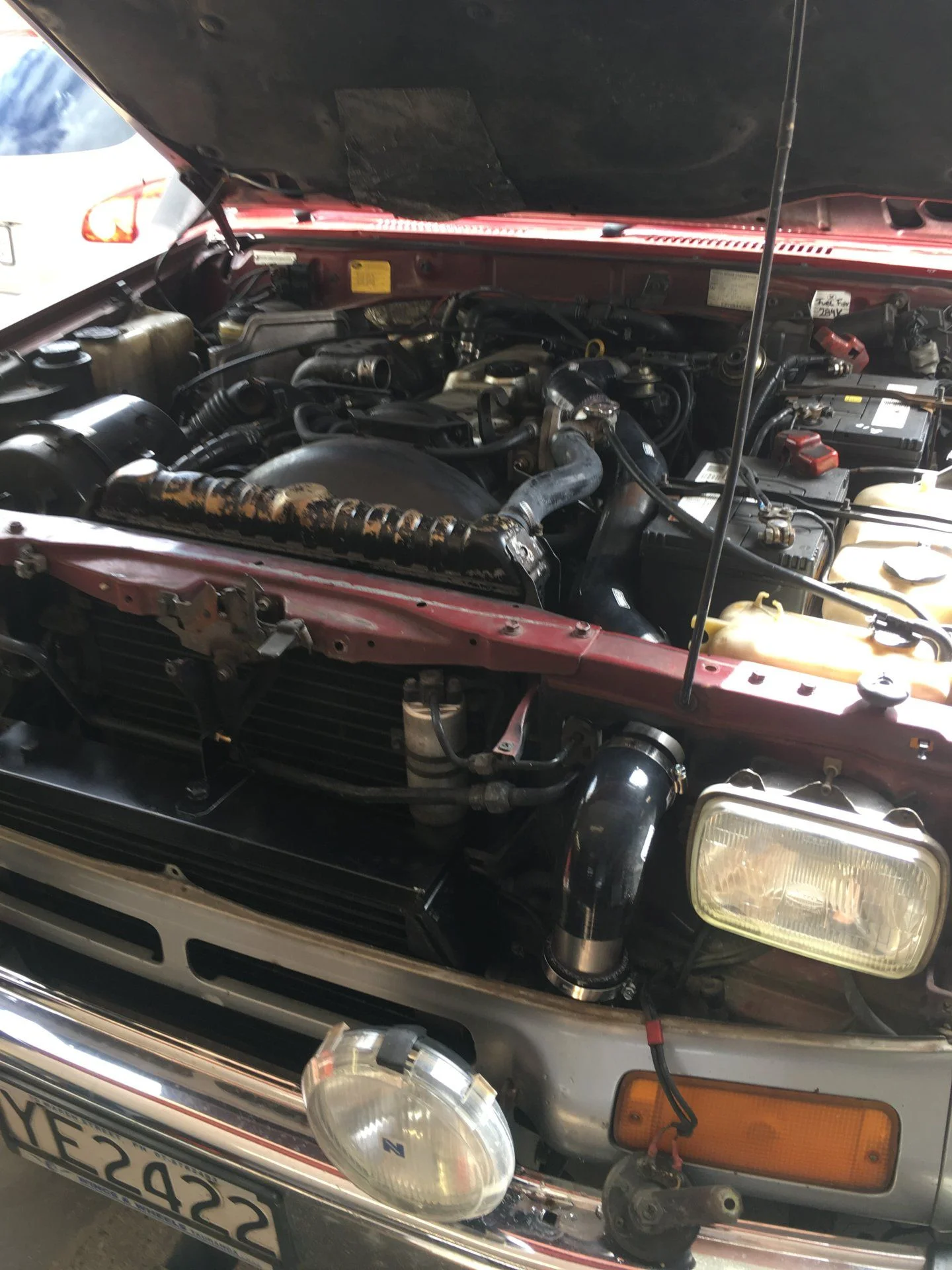

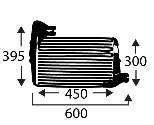

Thought I’d post the recent install. Just finished up last night. Seems to breathe well, will look at playing with the boost soon also.
Went for a 600x300x80 front mount. It’s a tight fit but not that bad. Did have to shave the back of the grill 30mm though where the pipes and cooler sit, along with modify some of the brackets/ move the horn and radiator overflow.
Went with silicone joiners and 2.5”/63mm pipe for ease and welded spots to the pipe ends to stop the hoses popping off. Took x4 45 deg bends, x5 90 deg bends and x1 90 deg reducer from 2-2.5” at the turbo.
One bend above the ac pump sits a little high and just touches the matting on the underside of the bonnet, but nothing major.
