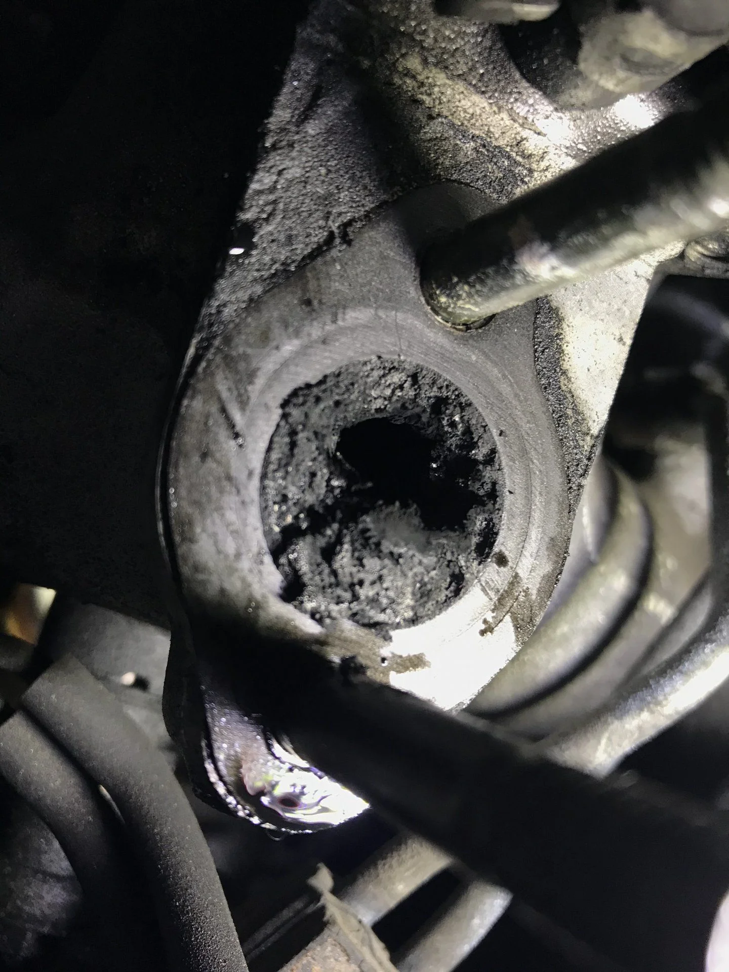

Did you or the PO remove the EGR System? I had a "ticking" and it was a bad design block off plate at the rear of the exhaust manifold in combo with the OEM gasket flapping. If you re-used the OEM gasket, take it out and use 1/4" block off plate with a bit of RTV. Not saying this is your "ticking", but it could be.

Looks like the EGR is untouched. Thanks for the info, I plan to remove it.

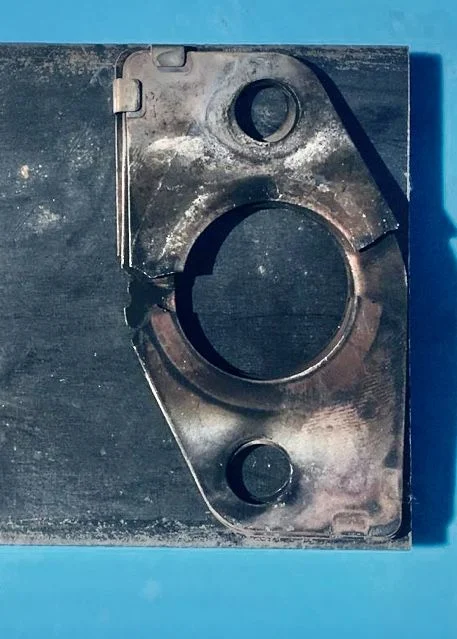

@Cascadia , I'm not trying to sound like a know it all, but before you starting digging around further, it may be worth an hour of your time to remove the EGR tube at the back of the exhaust manifold. You will see a "layered metal gasket". If it looks like this one (cracked), that is the source of your "ticking". I had this same problem, and guess when it started? Above 2000 RPM. If you were already planning on removing that system, mind as well do it now. Nothing lost. Let us know.
Indeed it’s probably the best place to start. Worst case scenario I get something off the to do list. Should be able to find time on the weekend, will keep posted. Thanks for the reference picture, cheers.
@Cascadia , In the posted photo, behind that gasket is a piece of 3" flat bar 1/4" thick. Just trace out that gasket and you will have a perfect block off plate. Just use RTV, do not re-use the gasket. I trust you will solve the issue or at least have a better fuel-air system! Cheers!

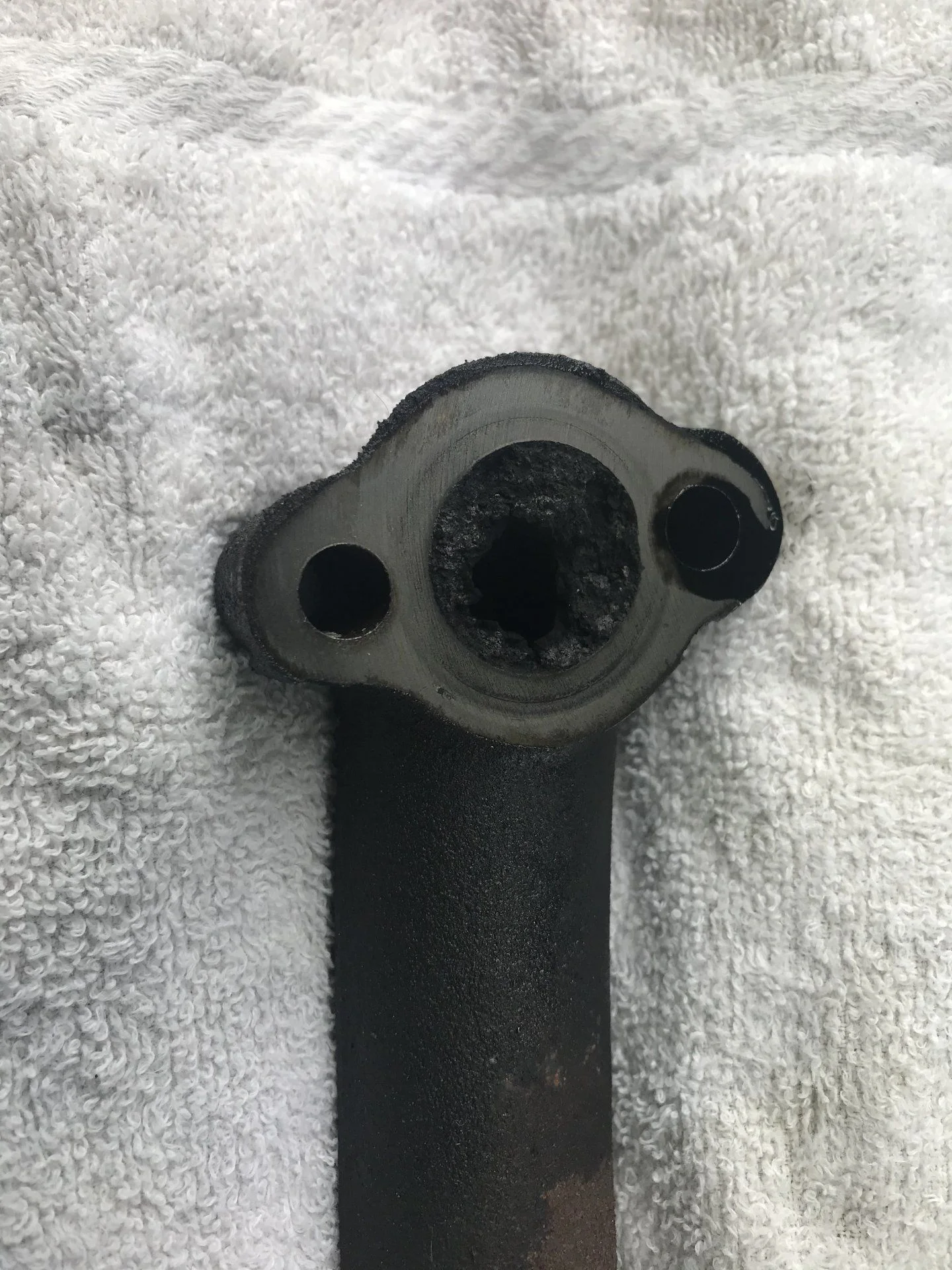

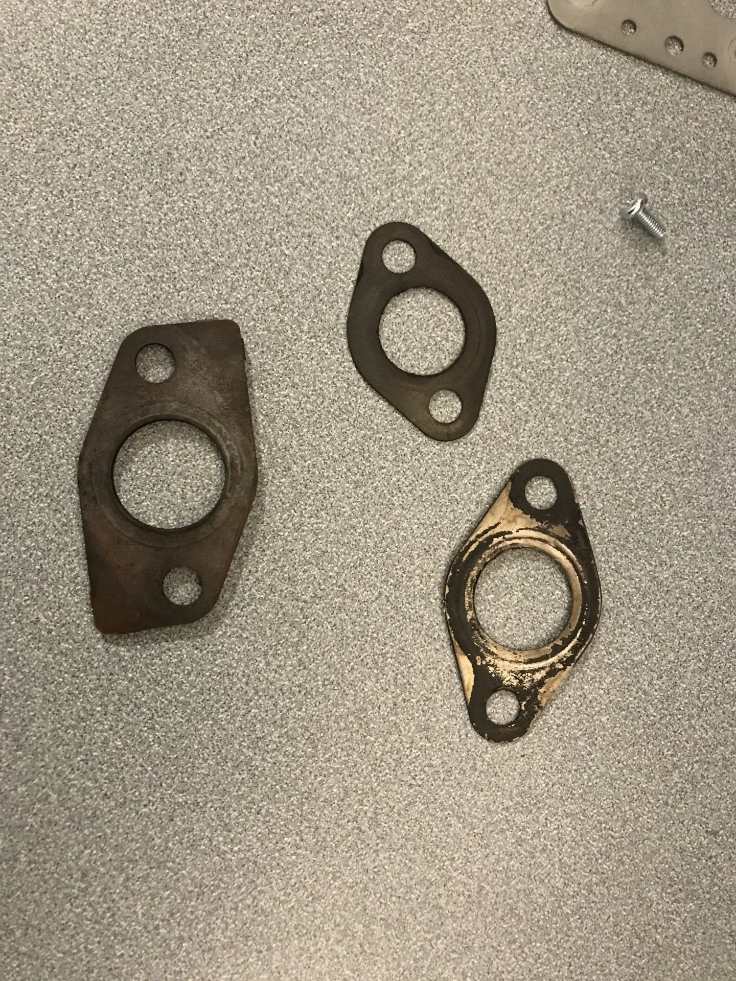

Did an EGR delete this weekend, unfortunately the sound remains. All good just the same as it needed to be done, plus it gave me an excuse to buy a new angle grinder. Lots of build up in the intake, nice to get it cleaned out. Gaskets all looked okay though. Thanks @Dprio34 for the suggestion, like you said, nothing lost.
