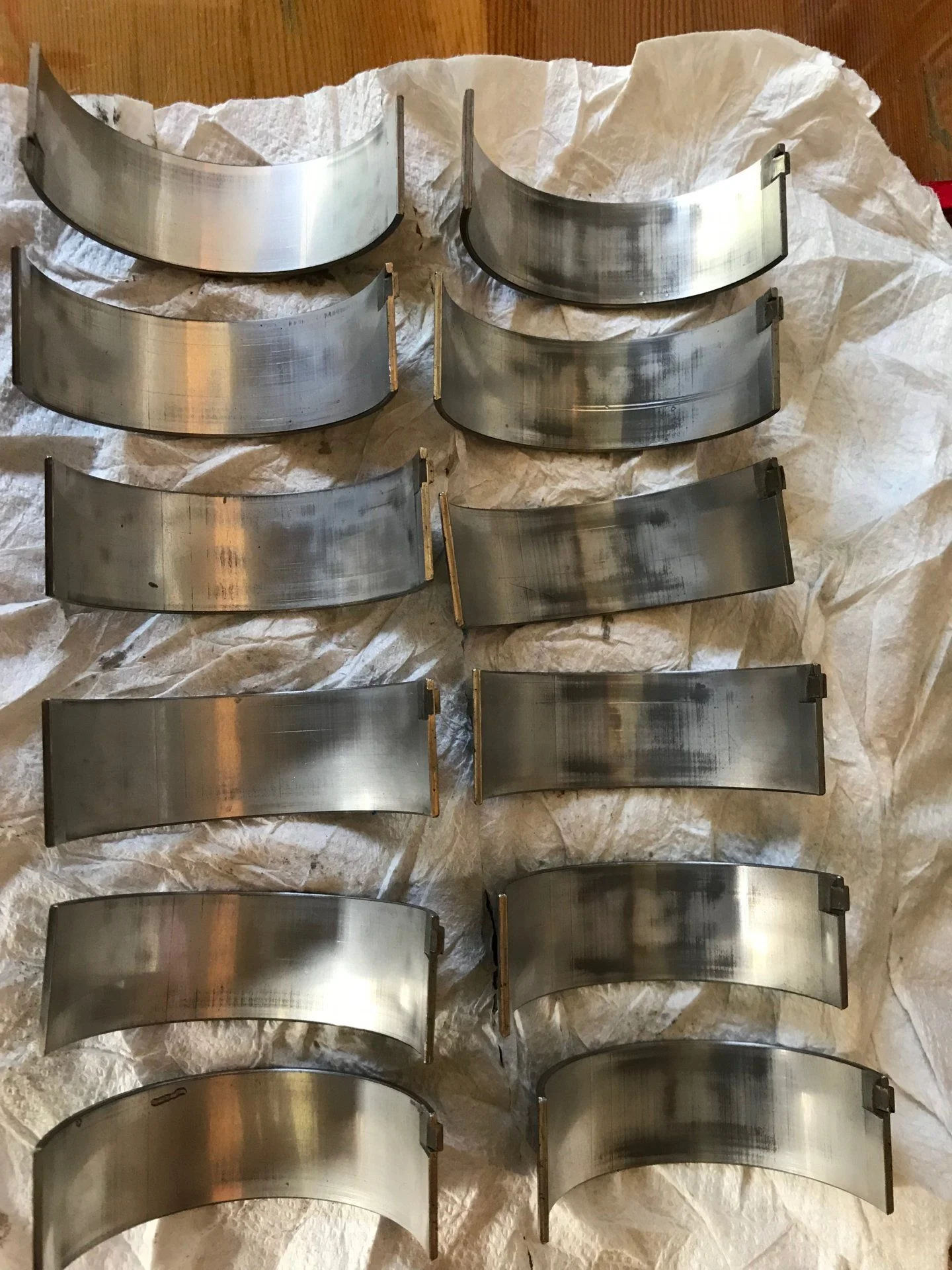

So I changed my big end bearings last weekend and need some advice.
I Replaced the original OEM bearings (marked with "4", BEB Pictures Here) with standard size taiho. The old bearings looked ok and all of the rod journals looked good. I plastigauged only cylinder #4 and it was right in the middle of the range at .0015”. Cleaned the caps and journals with brake cleaner. Reinstalled each of the new bearings with engine assembly lube ( Permatex ultraslick ). Torqued new oem bolts to 27 ft-lb, then additional 90 degrees. Put it all back together (w/ new oil pickup gasket and fpig on the pan. Filled with new Delo 15w40 and new oil filter. Cranked it over by hand many rotations. Re-installed glow plugs and injector relief line (had them off for ease of hand turning the engine). Cranked it with the fuel cutoff switch unplugged several times until oil pressure came up. Started it up and everything sounded good the first few days.

Below are pictures of the old bearings (Cylinder 1-6 is top-bottom, Cap side on left, Rod side on right)
1923624
Sounds like the ticking I get in my 1hdt. Mine is always worse right after an oil change. I also used taiho when I changed my beb. I changed them as soon as I got the car and its been about 30k klm so far.
The ticks in my 1HZ s were never regular like yours. Those old bearings look like they were replaced just in time.

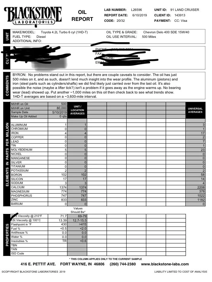

Just a quick update... I have put ~1000mi on the truck since the BEB swap. Tick noise has not changed noticeably. I sent in a oil sample at 500 miles to Black Stone and they didn’t find any issues (report below). I will probably take it to 3600 miles, send in another sample and then change the oil. Probably will switch to another oil type and weight, maybe amsoil 10w30 if I can find it for a reasonable price.
Anyone else have suggestions of an oil type that may reduce the ticking? Or an alternative oil in general (currently running chevron delo 400 sde)
Anyone else have suggestions of an oil type that may reduce the ticking? Or an alternative oil in general (currently running chevron delo 400 sde)View attachment 2001137

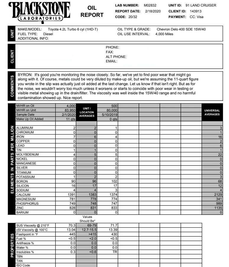

Quick update. I have around 5000 miles on the truck since the BEB change and the tick has not gotten any worse in a gradual manner over time. I changed the oil at 4000 miles from Delo 15w40 to Rotella T6 synthetic 15w40. I had hoped the ticking would go away with the change in oil brand. But it came back just the same (more noticeable right after changing the oil, less so later on). On my truck the ticking never goes away completely.
I haven't cut the filter open to look inside (threw it away before thinking about it), but will try that on the next oil change. I have checked compression (480-500psi) as well. Some of the valve clearances are out of spec, but not by much (cyl 3&4 clearances are the best), so i don't expect that will affect it. Updated Oil analysis at 4000 miles after BEB change (make up oil should of been ~2qts not 11qts as i was confused). Oil loss was due to leaky valve cover gasket after checking the valve clearances (need a new gasket and correct shims). Everything looks good in the report.
