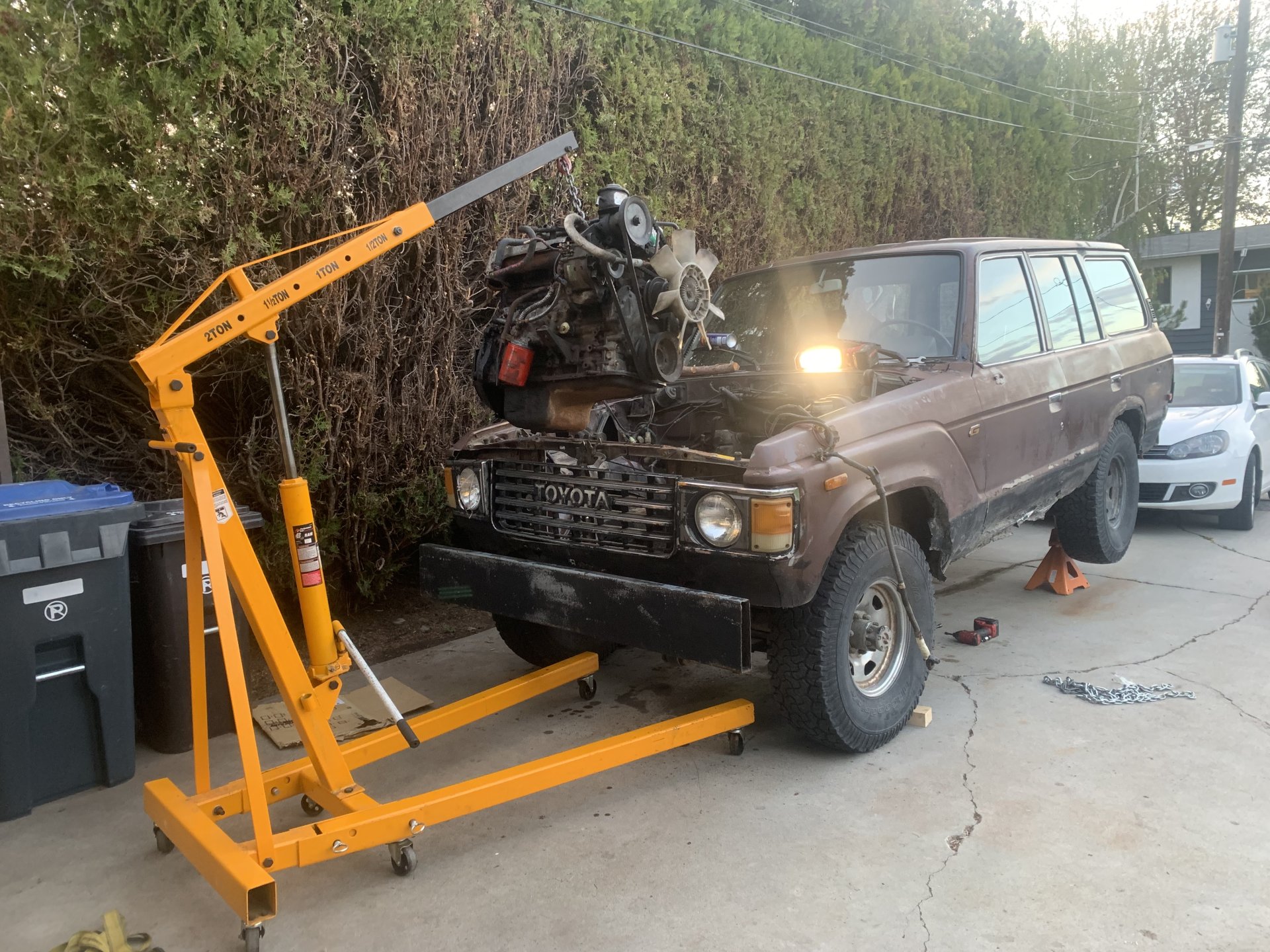

A while ago, I drove a naturally aspirated BJ 60 with 300,000KM. We started it up, I was SHOCKED about how much the damn thing rattled. The shifter shook, the dashboard rattled, and the steering wheel vibrated like a hyperactive toddler on gummy worms. The truck felt like it was alive, it wanted me to buy it, it was begging me to test drive it. I DID, ups and downs left and rights, bounces and bumps and all. I loved it, I have never been so connected to a inanimate object ever before. At the time, I was driving my 1993 Toyota pickup, the BJ did not feel much slower. There is just something charming about having the slowest vehicle on the road. It did not feel like like it was impossible to drive, it felt fine, something cool about shifting though the short gears on a old diesel 4x4. A feeling I just never got from my Toyota pickup.
However, my parents would not let me buy it. They called it a “bio hazard” and they were right. It was too rusty, and overrun by small woodland creatures. If Todays fuel prices were dirt cheap, I would still be doing this swap. My personal driving experience with my 62 was much worse that BJ experience. Even though my FJ62 has a rebuilt drive terrain, it’s slow, clunky, and shifts harsh. I don’t have the same connection to that has I had with the BJ. I don’t understand why you guys here on mud think the 3B is a bad power plant. For me, it is great, and a much more suitable option for me. For those of you who are familiar with me and my plans. You know I asked for opinions. Lots of you say to buy a 1HZ or a 12HT I can not afford that. But I can afford a 3B and I LOVE it.
P.S I have driven family members Teslas, and Corvettes. Nothing is more fun for me to drive than my old Landcruiser.
