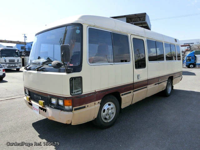

2H. It's what was powering these 29-seat Toyota Coaster buses.
Always wonder details on tranny and R&P coz 2H ain't a power plant ..
2h, I like the 6 cylinder sound.
But that bus, 29 people with luggage, 3000 kg, bus 3000 kg, I am surprised it would get past a stoplight before it went red again.
