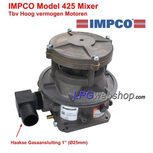

I may have missed it. What carb are you running on the turbo set up?
It's a holley 390 4 barrel butterflies and a impco 425 propane mixer.
Do you remember how you jetted it?
There is no replaceable jetting in the mixer. Just screw adjustments.
The Holey 390 is just the throttle plate. secondaries are converted to mechanical instead of Vacuum. The Mixer bolts to the throttle plate.
There is no replaceable jetting in the mixer. Just screw adjustments. View attachment 4046015
The Holey 390 is just the throttle plate. secondaries are converted to mechanical instead of Vacuum. The Mixer bolts to the throttle plate. View attachment 4046014
