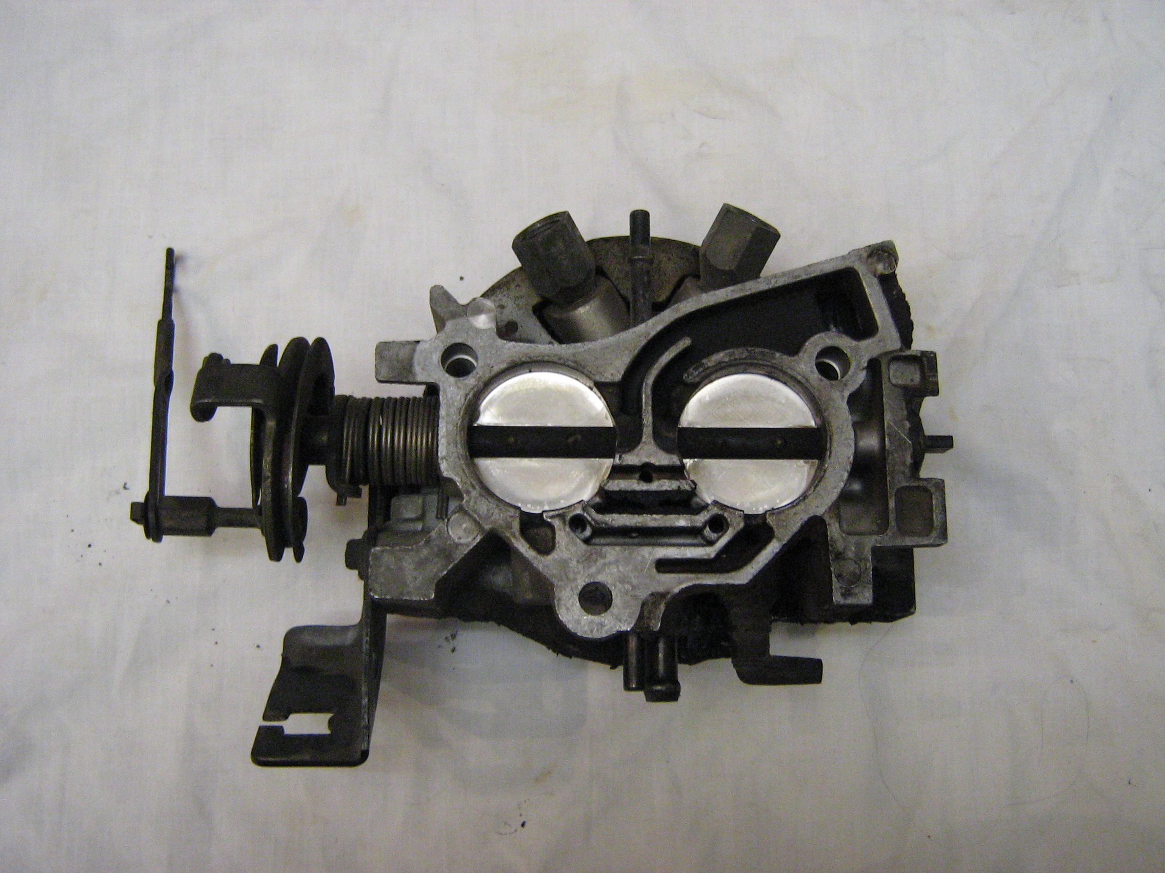

Another option is to use a stock 4.3 setup with all the sensors, as Jim ( Downey ) said. Last time I checked DUI ( Davis Unified Idnition ) still made an HEI unit with the GM TBI connector for a 2F motor. This allows a direct connection to the GM harness. The 4.3 throttle body from a van is the easiest unit to use because it has the throttle linkage bracket bolted to the side of the TBI unit so no hack-job throtlle cable mounts are necessary.
A stock GM cable can be used...You need to cut a small square hole in the firewall for the cable. That is a little tedious since no one seems to carry a square hole saw. I probably still have stand offs for GM knock sensors that mount to the driver's side of the block. You'll need the knock sensor if you want the full potential of the ESC.
It will run best with a complete system . I've run the one we built from about 2000 to 2005. I've also run the Howell, Turbo City and a couple setups I'll keep unnamed as a courtesy to them. Sorry Jim, I never got a chance to test yours. Our system was a full system with the ecm driven HEI from diversified and a stock 4.3 S-10 ecm and chip. I did try ours with and without VSS and frankly whether just luck or a fluke I didn't see much difference. However, with all the sensors retained and full spark control , it ran the most like stock and free of glitches. All the others ran better than the carb with respect to mileage and off road manners but each had it's own particular annoyance, none of which were bad enough to ditch the application generally related to idle flares or erratic idle. Frankly it would have been difficult to determine with the other "partial" systems which omitted individual sensor was the biggest problem since the provisions to add them back one at a time for testing were eliminated in the harness and programming. My opinion is that GM probably spent a whole lot more on developing the system than any of us aftermarket guys so we approached the design assuming GM did it right rather than think I was smarter than them and their multi million dollar research team I even had the opportunity to test one TBI upside down... it's passed with flying colors.....but that's another story
Van TBI with cable mount
