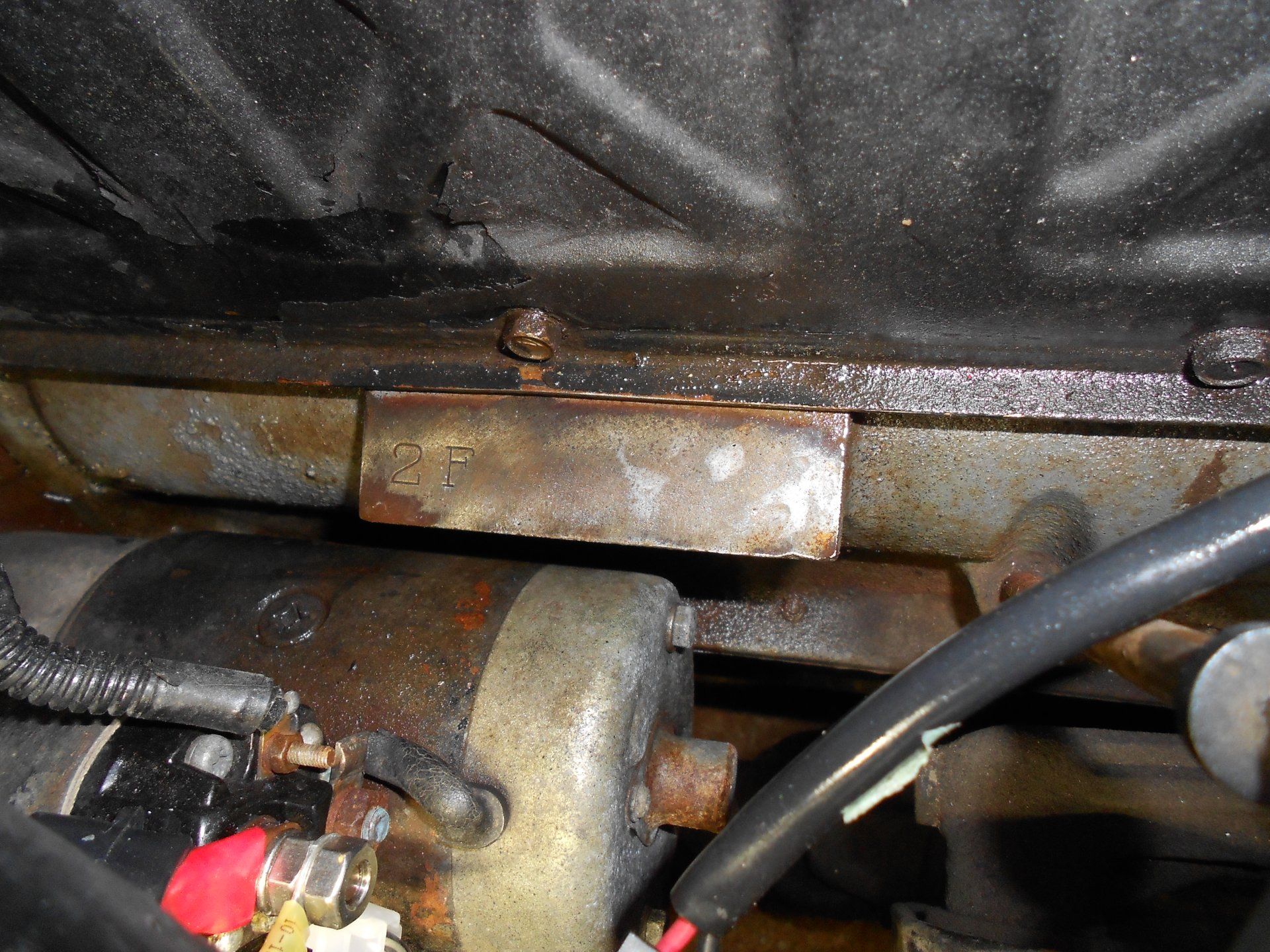

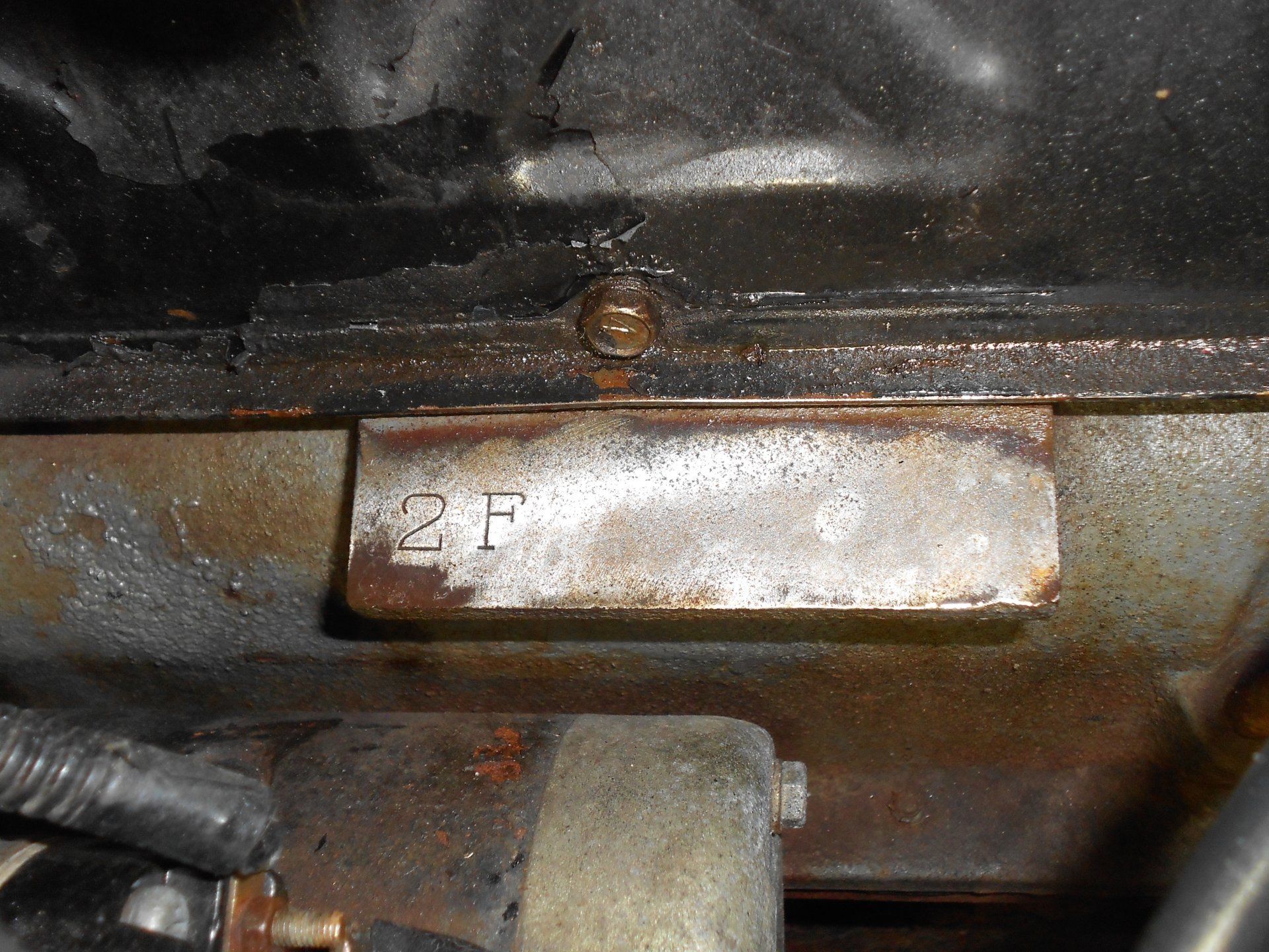

Hi Fellow 2F Mud Registry Thread folks !
Here is a Unique unmolested Live specimen I have not run across before ?
- I have received several different Explanations & Reasons From Toyota Motor Corp. , Torance CA
- The Toyota USA Muesuem
- The land cruiser Heritage museum in salt lake city Utah ( Privately Owned )
- My trusted long term Tech contract @ SOR .....
- All provided basically a different reason , with some similar supporting facts
- To eliminate the possible PO grind OFF for smog reasons , I used me machinest stratghtb edge , and there was NO depression from
the Correct location 2F stamp to where the serial # ID should be .....its simply left blank ?
- it is a later / late 2F , oil cooler equipped .....
- NO Door Jamb A pillar data ID plate
- Engine bay one matches frame
- its currently in a 1/79 FJ55 W/ a split case and late aluminum type top shift housing
- please suggest any additional pics of info i can add confirm or verify yea or nea ?
factory replacement block. I have a 3fe like that...prolly .5mm over pistons and .25mm under on the mains and rods...at least, that's what I found in the 3FE...it has a toyotareman label on it.
