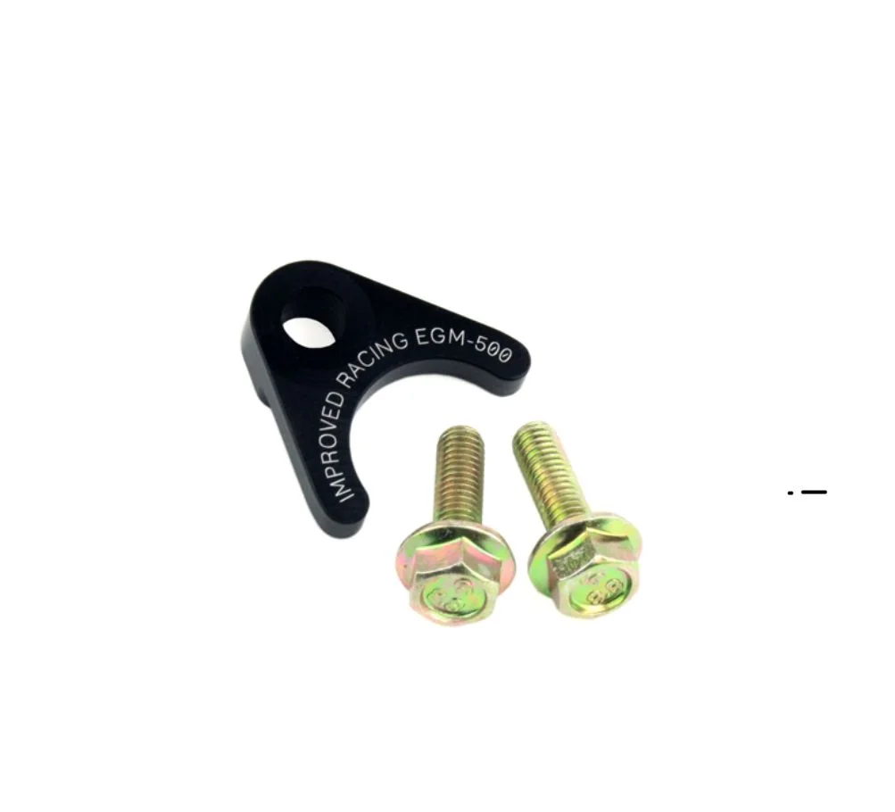

... Ultimately, it was the o-ring on the oil pump pick-up tube. Apparently I did not seat it fully when I installed the Camaro pan and pick-up and this created the problem. To ensure this never happens again I added this clever little guy:
An old friend of mine, Michael, owns and operates Improved Racing.
Cool little piece there.
He has lots of neat stuff to solve issues like this (mostly for LS motors). I keep looking for a reason to buy some stuff from him for mine!

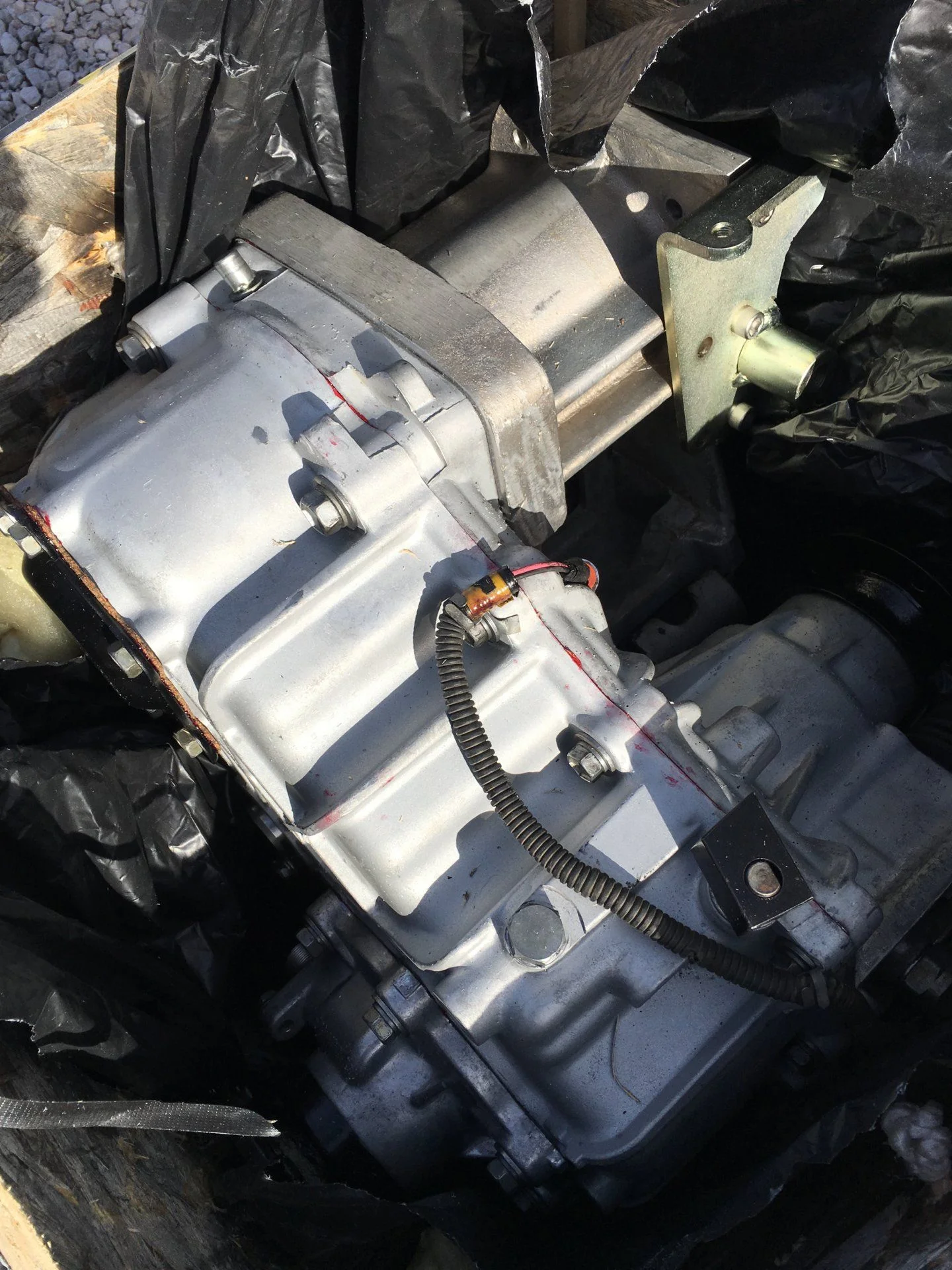

So to pick up where I left off...my tcase developed a nasty whine about 25k miles after doing the swap. I had rebuilt this thing once already but simply didn’t have the time or desire to do it again.

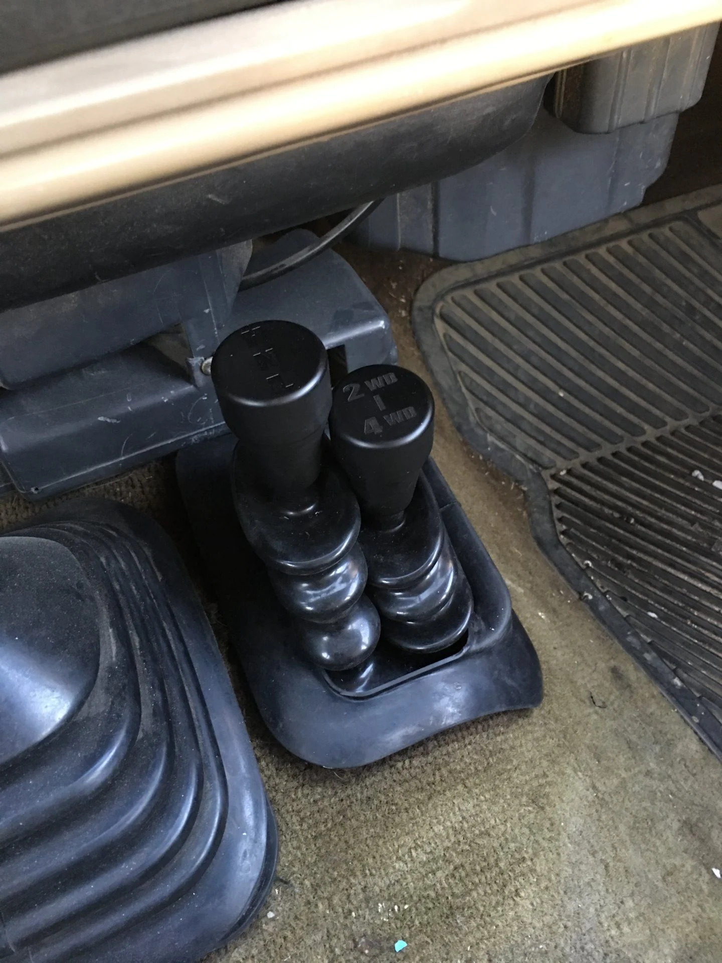

Fortunately, the AA adapter makes it possible to drop the case without splitting it. I dropped mine and shipped it to Georg at Valley Hybirds for a rebuild. He also added the twin stick shifters while he was in there.
Special delivery:
Inside the box:
Twin stick goodness:

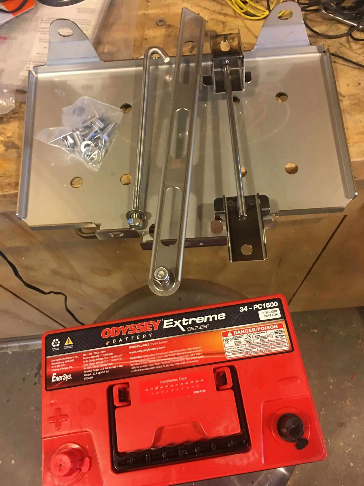

Stainless tray (sooo beautiful) and Odyssey battery added:
Both items are extremely badass. The Odyssey battery gives a great level of comfort when far from home and the battery tray will last forever.

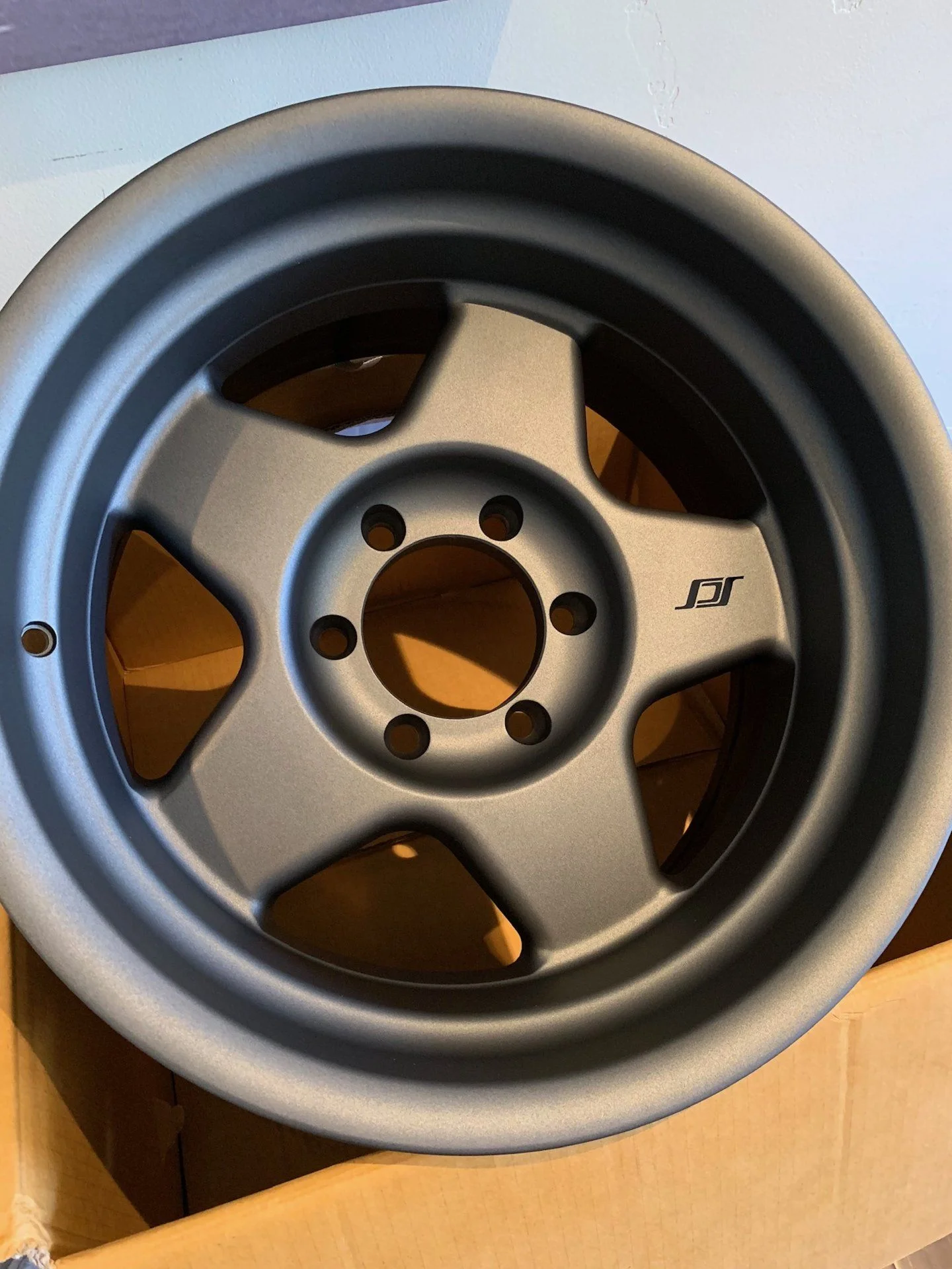

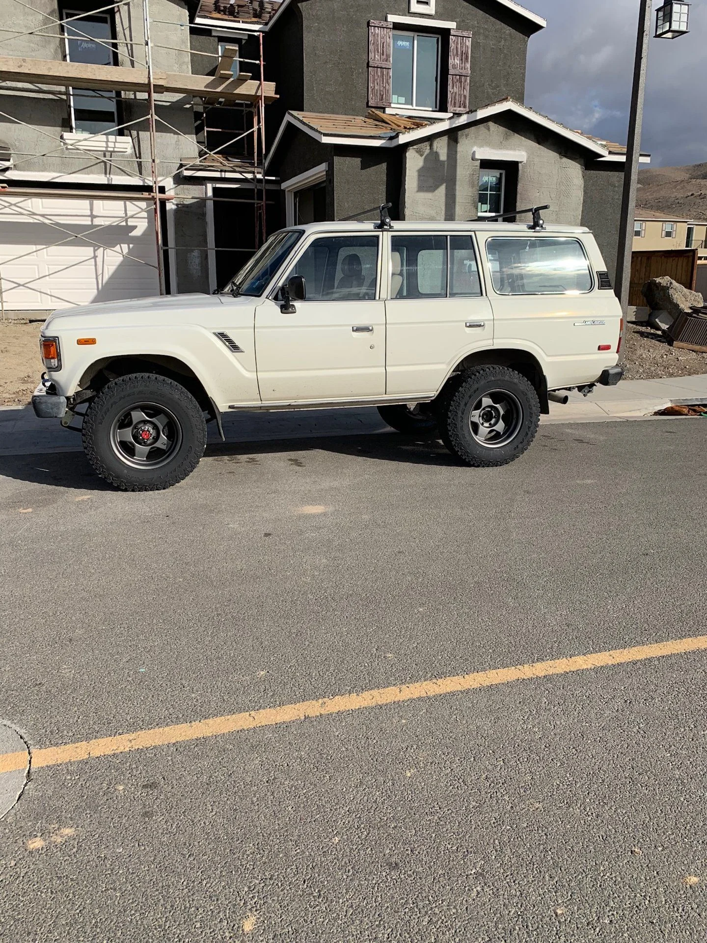

More recently I invested in some SCS f5 wheels. These things are gorgeous. I don’t need to tell this crowd how difficult it is to find wheels with the correct back spacing for our old Toyotas especially in a 17” diameter. SCS deserves big props for being a manufacturer willing to do it.
I wrapped them in some in 285/70/17 Goodyear Ultraterrain tires and I’m super happy with them so far:

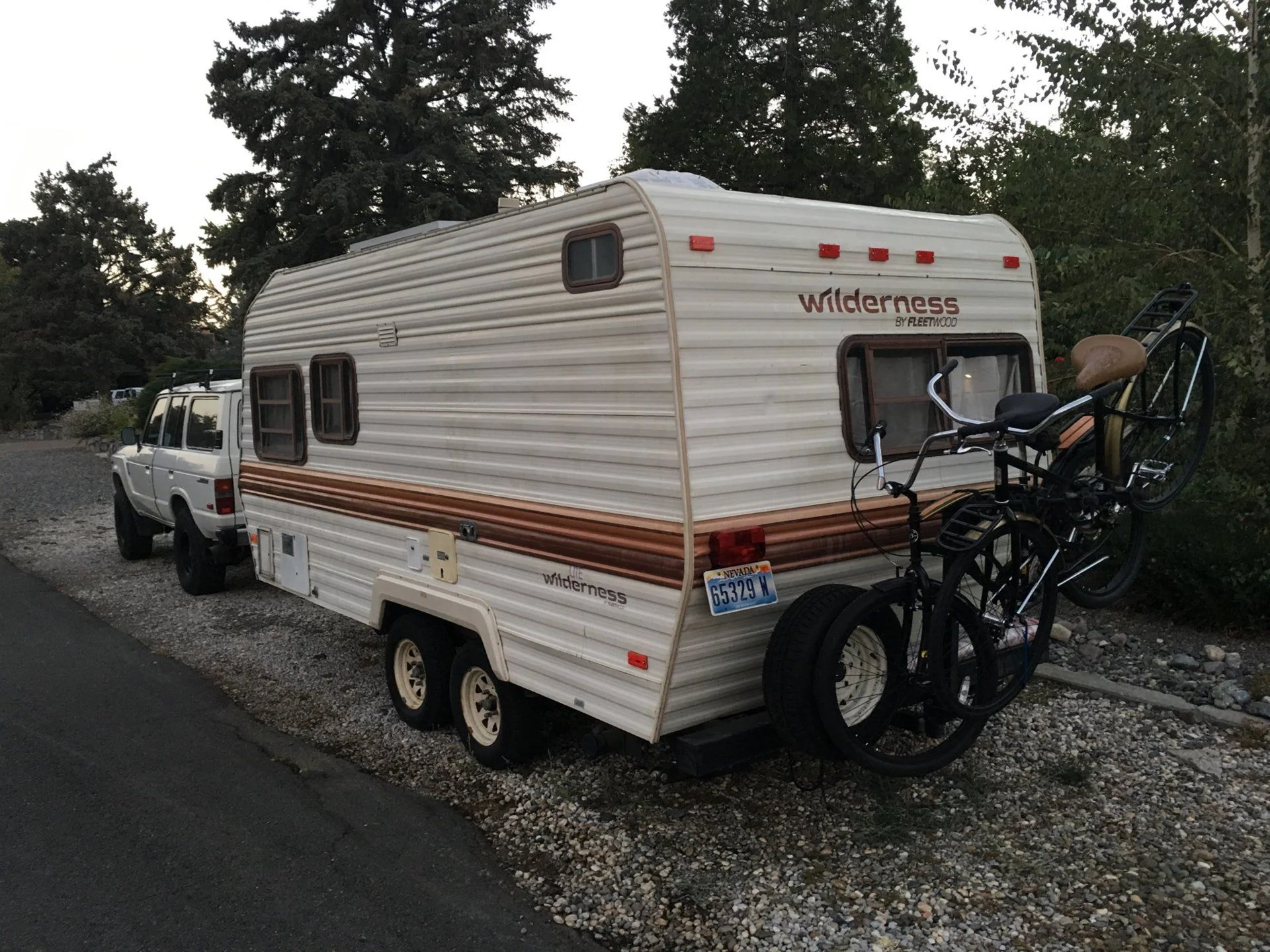

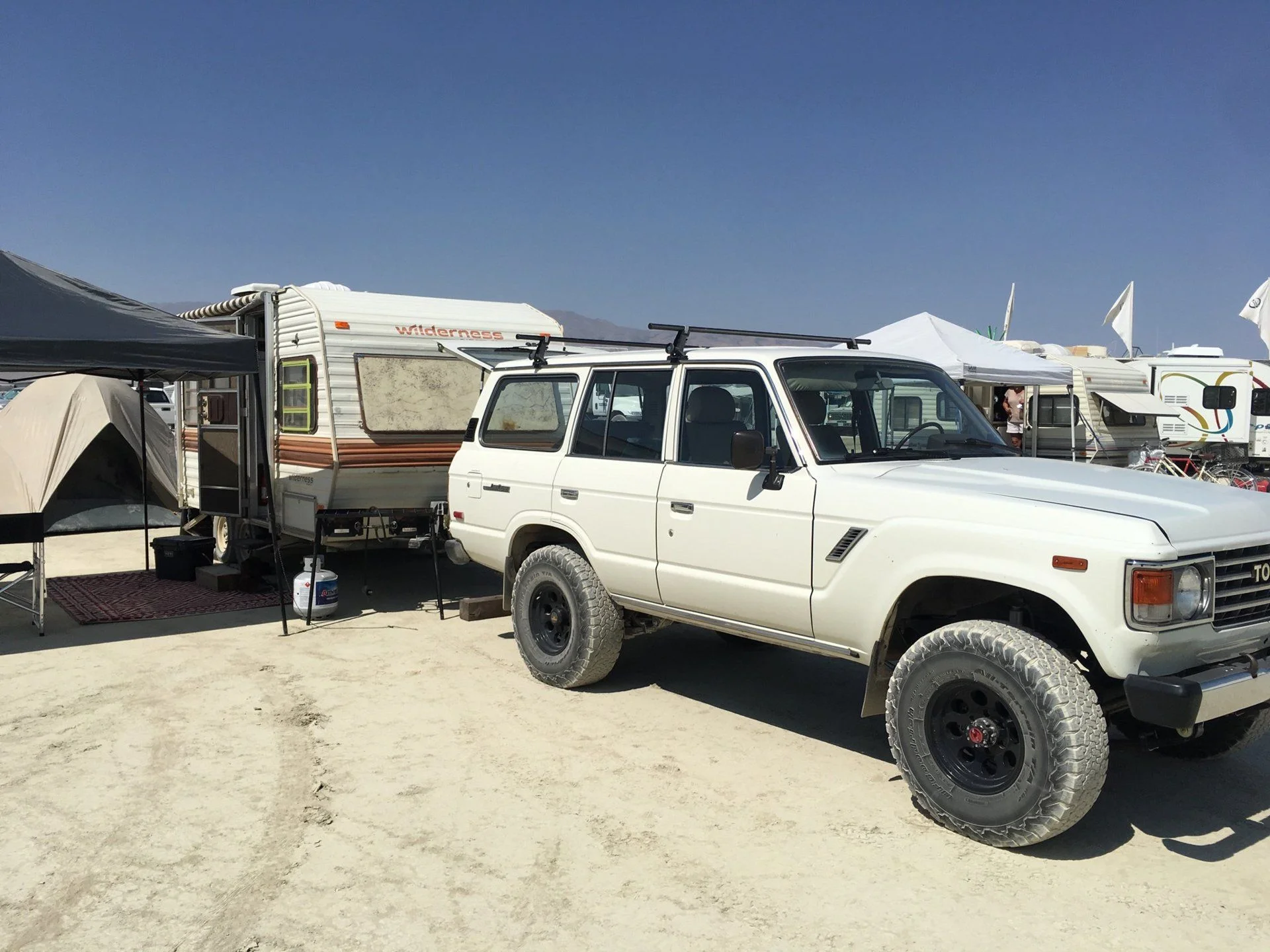

This post is a little out of chronological sequence but I forgot to mention that we dragged the old travel trailer out to the Playa last Labor Day weekend. What a blast we had out there! Pulling the 3000+ lb trailer along with all of our gear for four nights of camping was easily accomplished with the 5.3l and 4l60e. The LS upgrade has added a ton of versatility to this old rig. I also welded on a 2” receiver to the rear bumper of the trailer for our bike rack that worked out perfectly.

Yeah, probably about 3200 lbs. Power is definitely not an issue but I don’t think I would want to tow much more weight than this with a 60. The road out to Black Rock is really rough in places and I got some sway going with the trailer. I’ll be adding an anti-sway setup for the trailer for future trips.

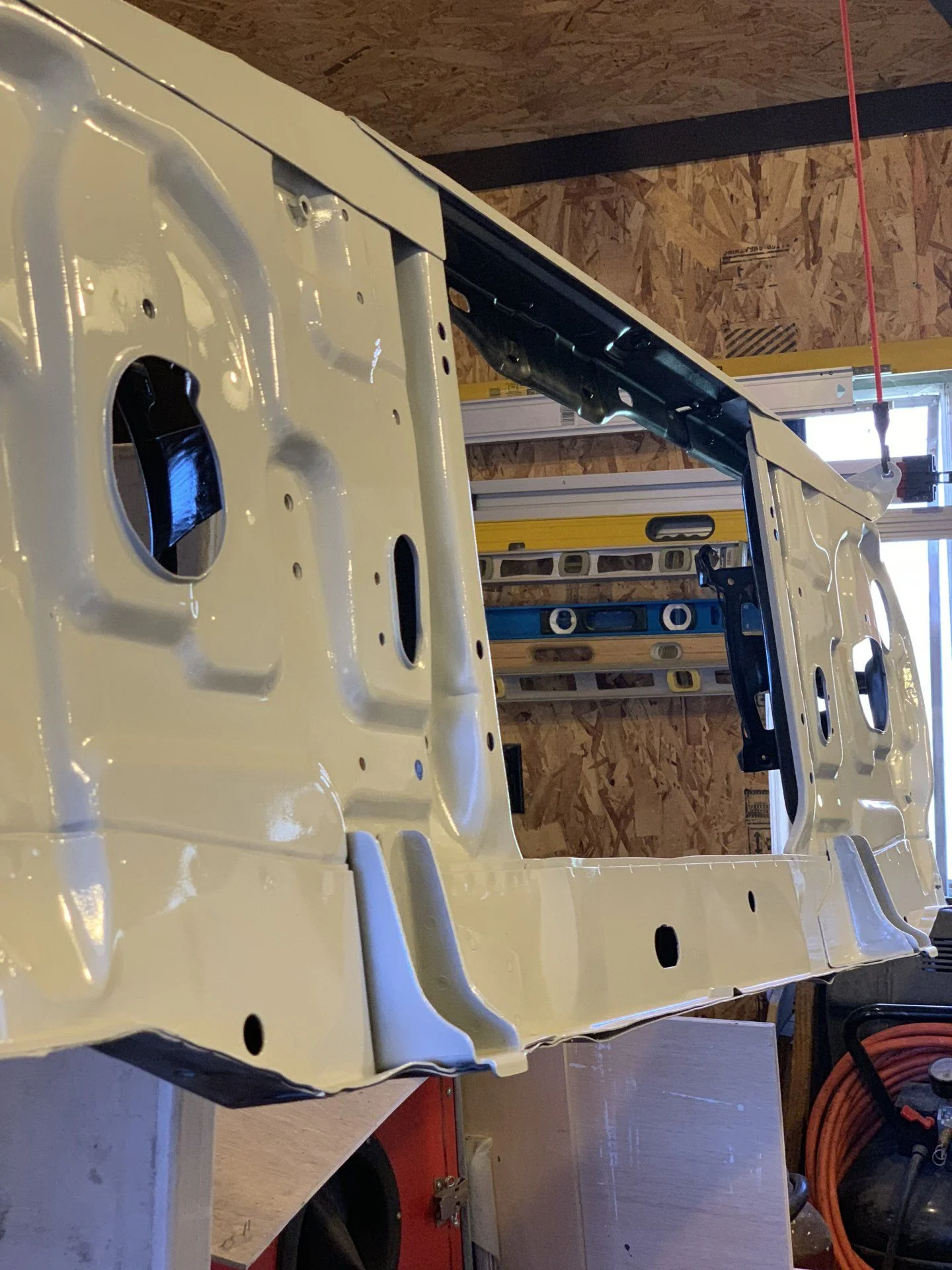

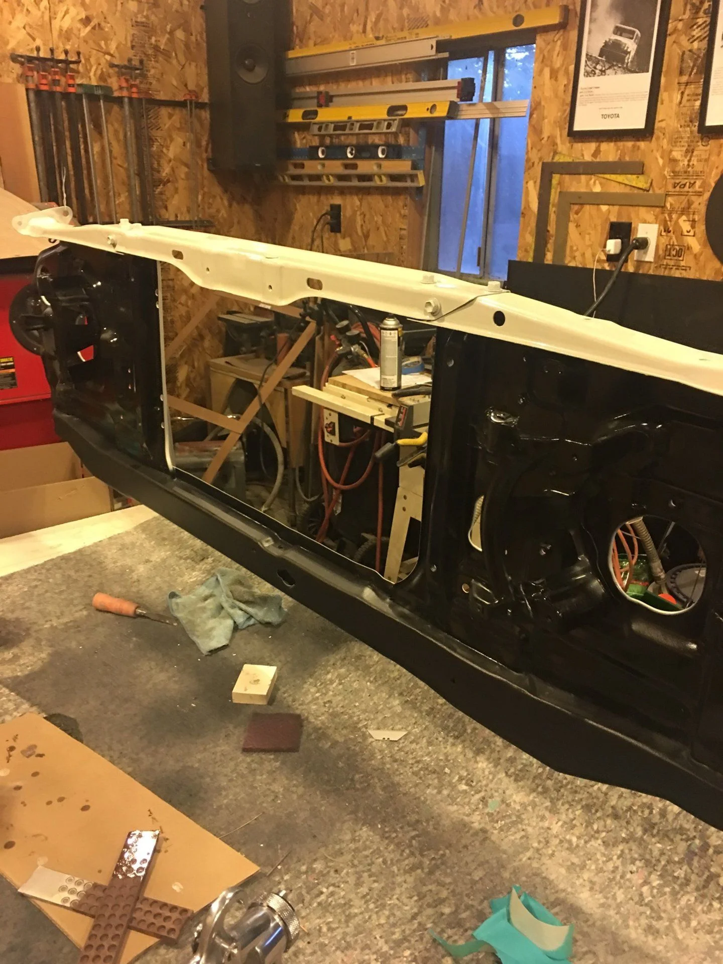

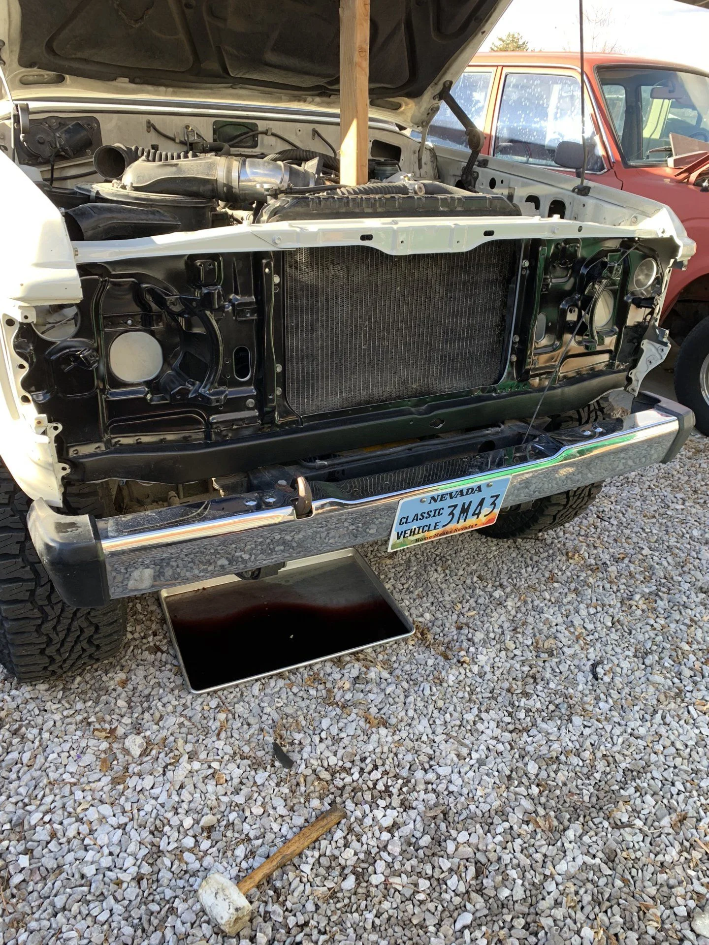

Much earlier in this thread I mentioned some front end damage at one time in her life. I had replaced the damaged lower valence panel but the radiator core support was also a bit jacked. Before getting too far in this process I wanted to address this. I sourced a nice used one from Mud classifieds, did some minor body work to it and painted it. Came out really nice.

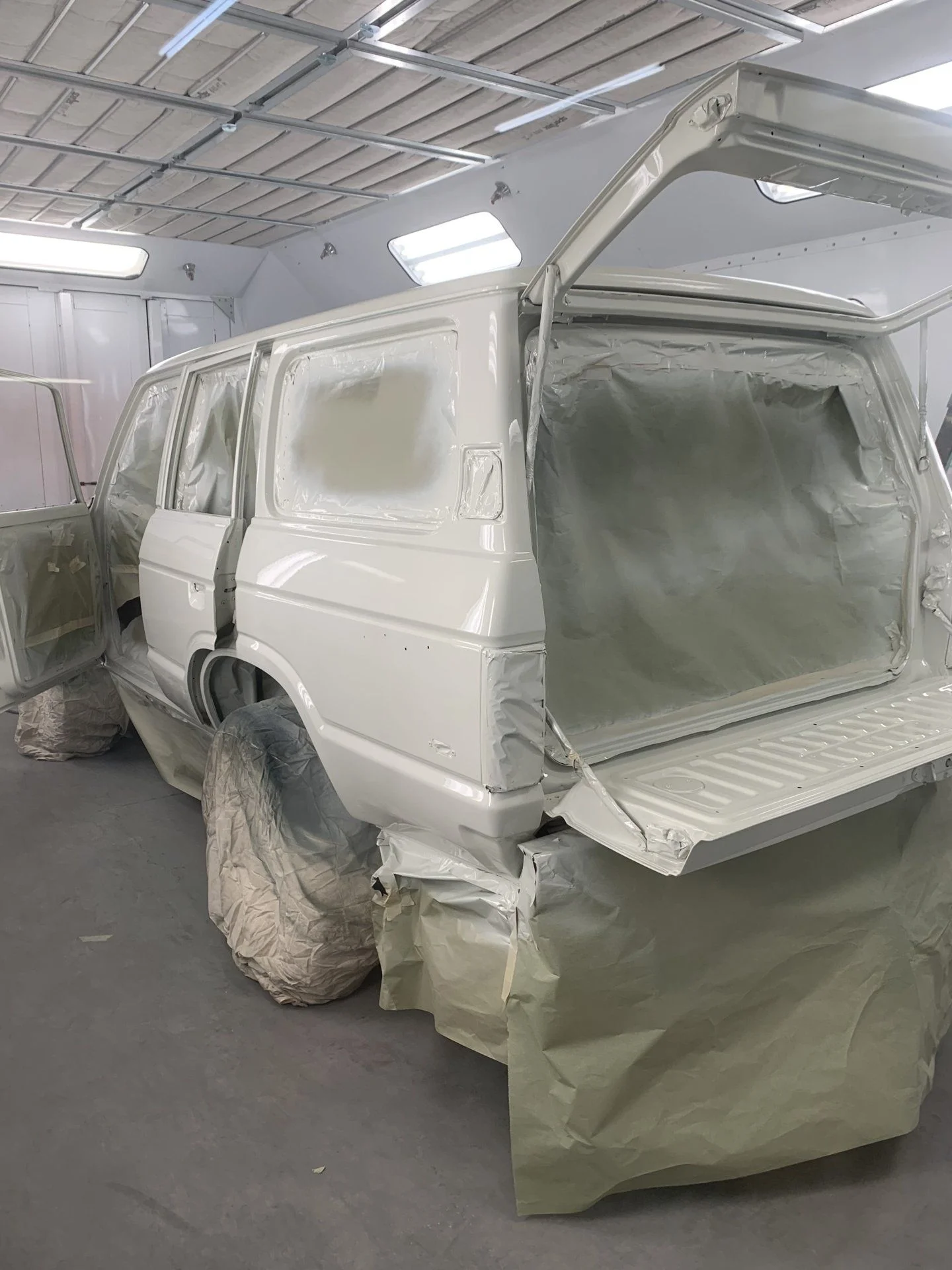

I dropped by the paint shop this afternoon to check progress. Holy $hit! It’s almost done! They had just sprayed it that morning.
Sneak peek in the booth:

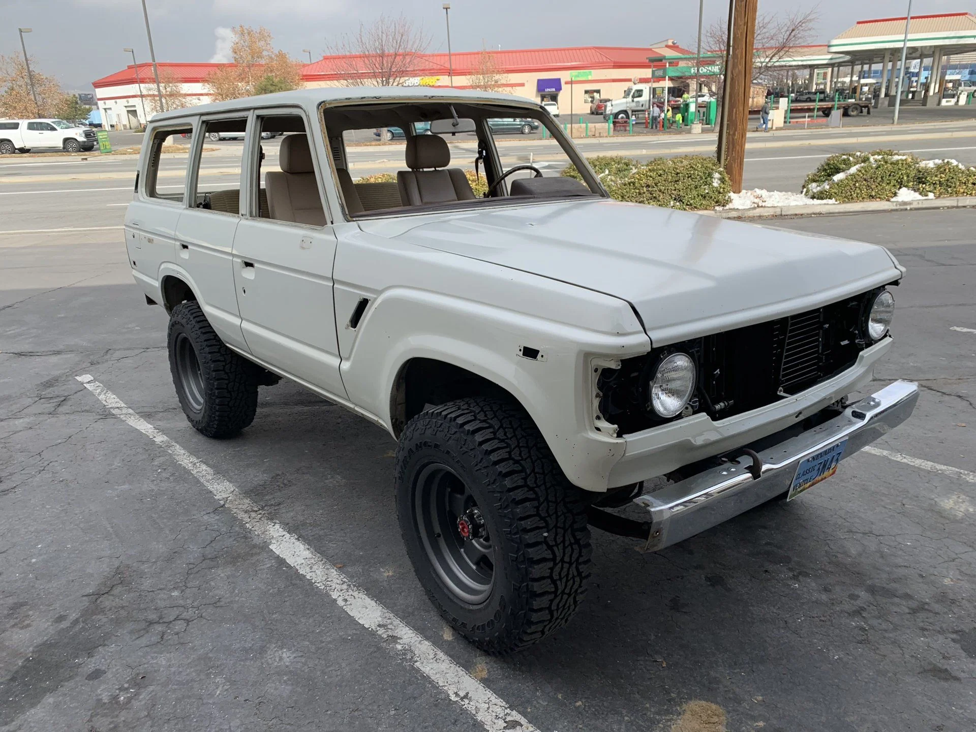

Truck is back home and the Paint looks amazing! I don’t have any good shots to share yet, sorry. I’ll save that for a sunny day once it’s all back together. Suffice to say for now that it’s better than I expected and I’m very happy with the job the shop did. The old girl literally looks like new.
Reassembly has begun! My first step was to take it to the glass shop where they installed a new windshield and new rear glass. I had to source the rear hatch glass on line, the glass shop told me it was discontinued. Onur confirmed that OEM is gone. Found a Chinese made piece that looks decent. I would have kept my old Toyota one but the defrosters were jacked. Front windshield gasket came from City Racer LLC, rear gasket from Toyota. I ordered the black lock strip from Trail Taylor and it worked perfectly.
