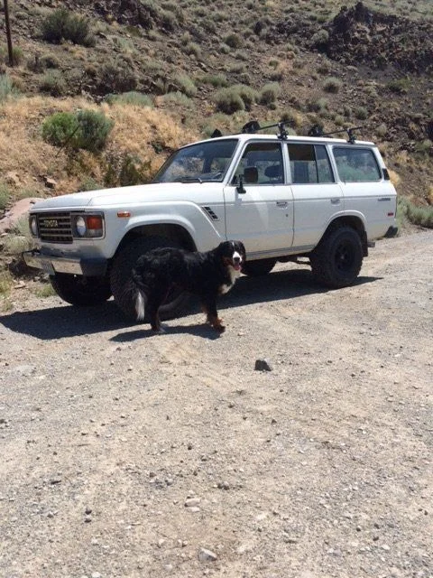

Took the dog hiking.

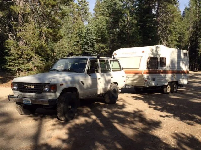

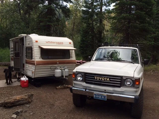

Towed our 18' travel trailer to Lakes Basin Recreation Area. Just got back this afternoon and had a blast! The new power plant handled the load with ease even up some serious grades. An FJ60 is maybe not the perfect tow vehicle but for a lightweight trailer like ours (2800 lbs. dry) it handles it just fine. This is the added versatility that I had wanted for our truck. Makes all the hard work worth it for sure!

We were in the Diablo Campgrond near Packer Lake. Such a great area and still a lot of places we haven't explored.
