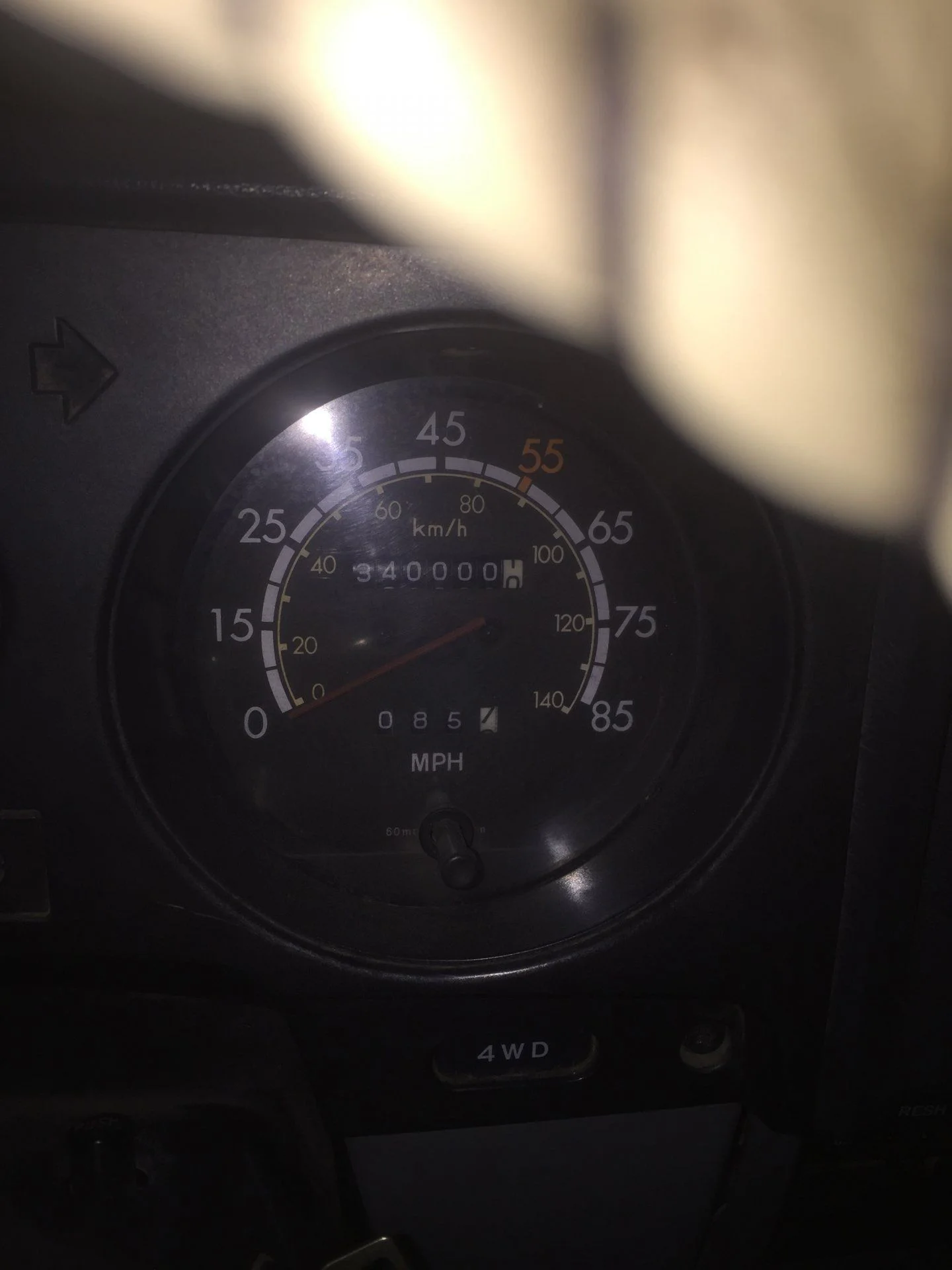

1984 FJ60. I am the second owner. Still running great after 340,000 miles. Desmogged with JimC carb and dizzy, but decided to be prepared for the inevitable. I bought a wrecked '85 that had a factory replacement block cast in '88. The head is off of an '87.
