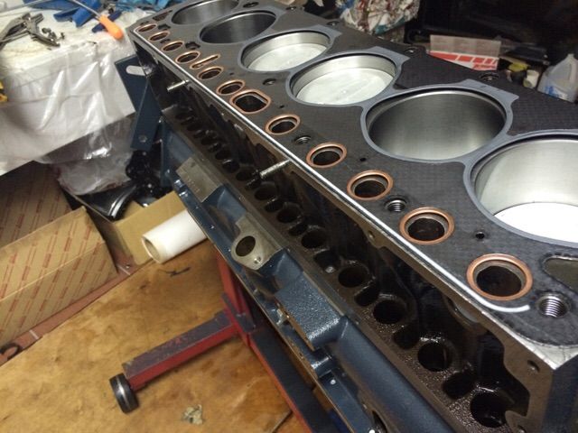

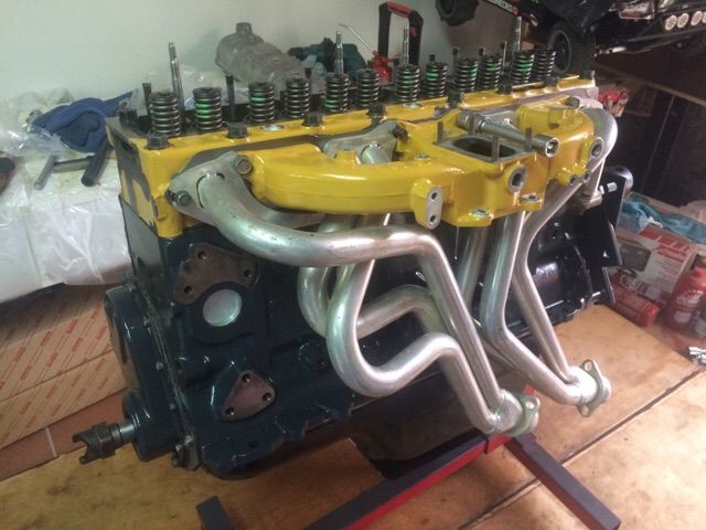

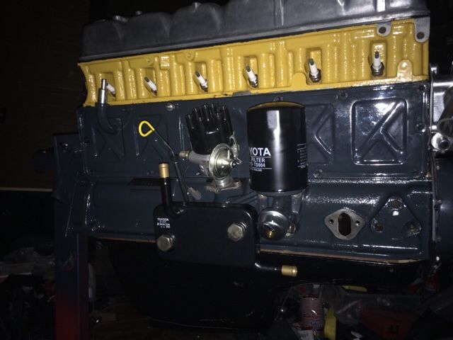

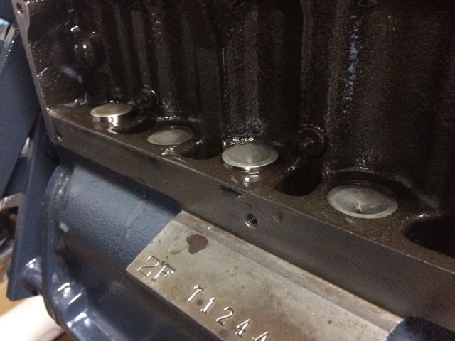

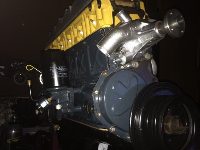

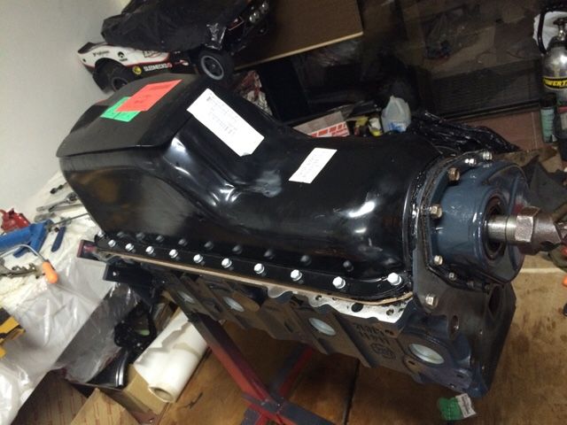

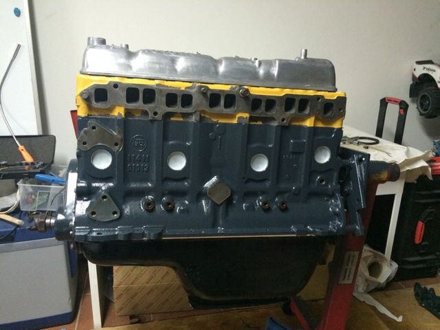

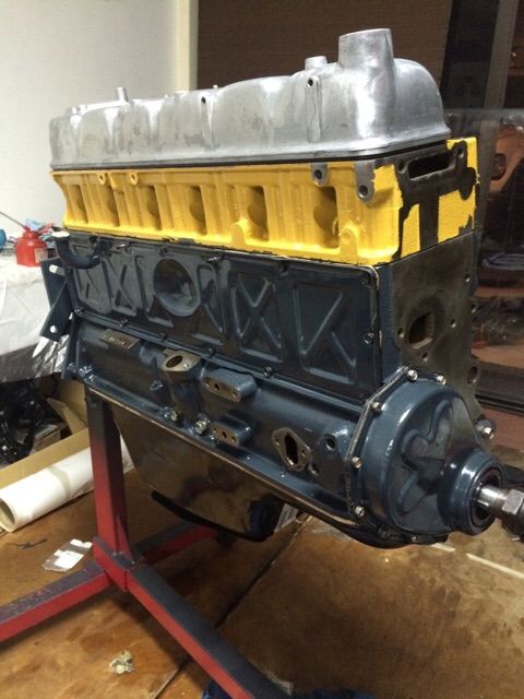

Ok a lot has happened.
Nearly there.
Waiting on two push rods that I need to match the other 10. For some reason I got 2 that have shallow buckets at the top. So once they arrive i will close her up and fill her with oil.
View attachment 1061374View attachment 1061375View attachment 1061377View attachment 1061378View attachment 1061380View attachment 1061381View attachment 1061383View attachment 1061384
That's it for now
Where in the world did you get those headers???
