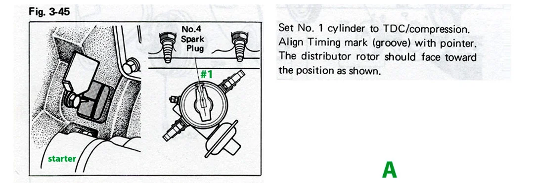

I am looking for 0* TDC to install the Hyperspark distributor. Looking at the drawing it depicts the flywheel, the pointer and the BB
Is this 0* or 7* for cylinder #1……..i just can’t remember since i time it so infrequently

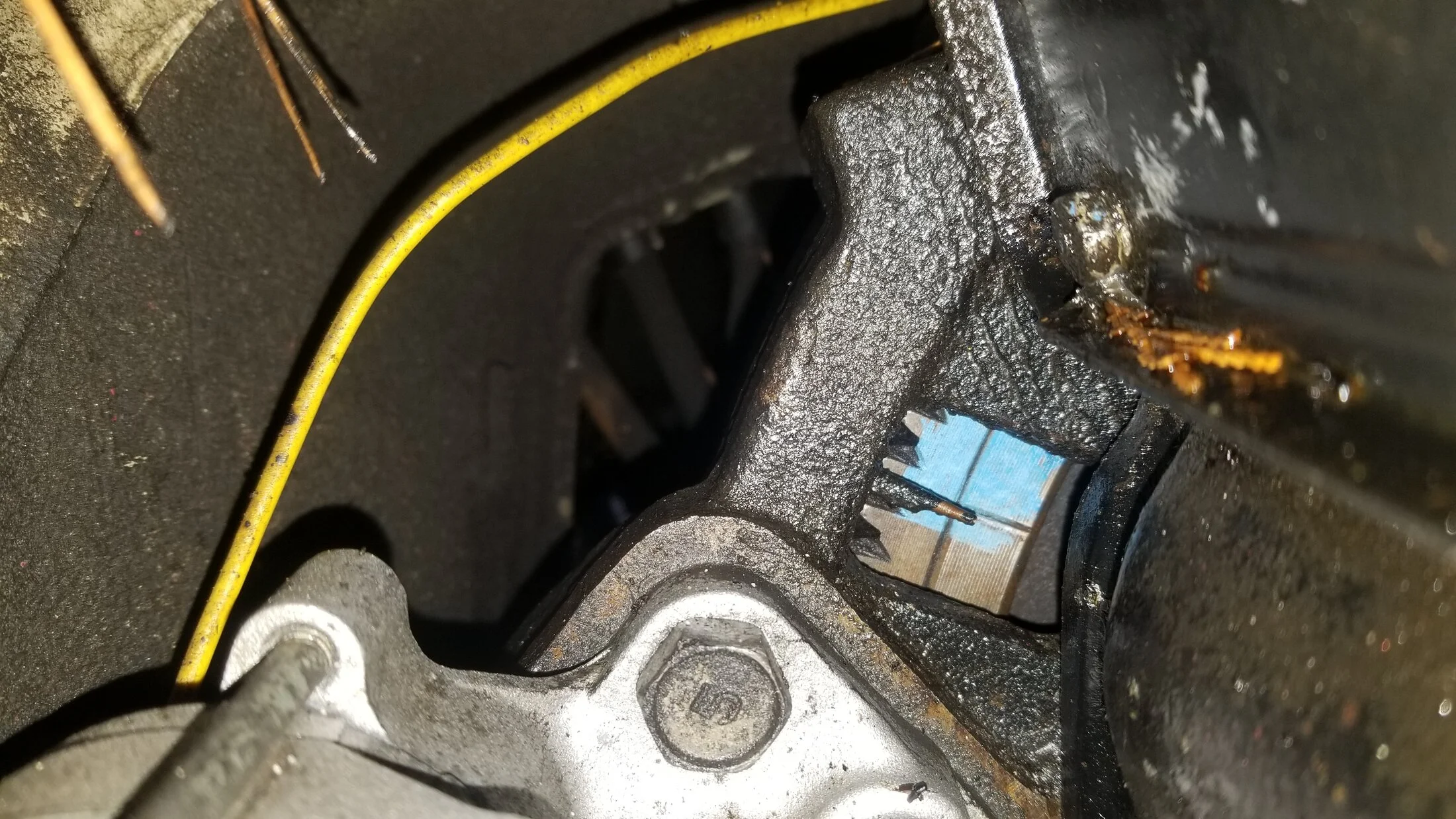

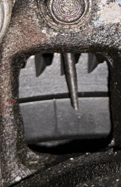

The BB is about an inch to the right of this line

I have in my old decrepit foggy memory that the flywheel turns two rotations for every one rotation of the rotor. (I'm probably wrong on that) But I was thinking that a quick way of ensuring that you are at TDC is the line on the flywheel combined with where the rotor is pointing. Comes in handy when adjusting valves too. :)

Alternatively, if it ran with the old dizzy then you could simply snap a photo of the rotor position (wherever it is) then match it with the new dizzy installation and not worry where the timing marks are.
I need to correct myself. I was thinking of the times I’ve pulled my DUI for various reasons and then re-installed the “same” dizzy when the engine rotation didn’t change. “BUT” if you’re changing dizzys, you can’t depend on the dizzy gear’s position matching up with the rotor’s position exactly the same as the other dizzy so it’s position could be as much as a half tooth off.

Well tomorrow is another day…. It’s about 11:20pm Saturday night so all I have done is read and think about the process since about 7pm. I have also read all of you guys’ generous suggestions and will employ them tomorrow. I pulled the battery to give better access to the distributor area ( THAT was an hard lift) and a better look into the timing site hole .

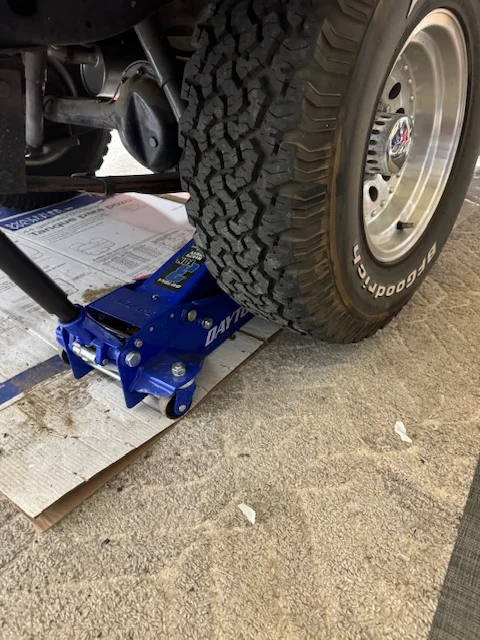

Everything is wired up and ready to go once the new distributor is locked in place and setup on the handheld. My problem is working alone again. In order to get the BB in place, I had to jack up my right rear tire, place the truck in 4th gear then rotate the tire to turn the flywheel.
I had to have made 20 trips between the rear wheel and right front fender to see when the BB would show up in the “window”.

This one only helps after you have the flywheel mark/pointer lined up... put a mark of some sort on the harmonic balance or crank pully that lines up with whatever arbitrary point works for you as an easy to see visual; indicator. For getting things approximately right that is often a lot easier than trying to peak at the window in the bellhousing. After you are close, you can watch for the pointer/line to fine tune it.
