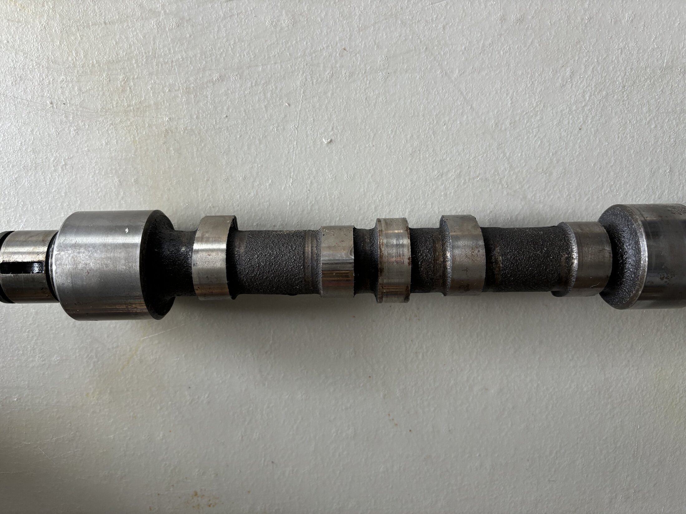

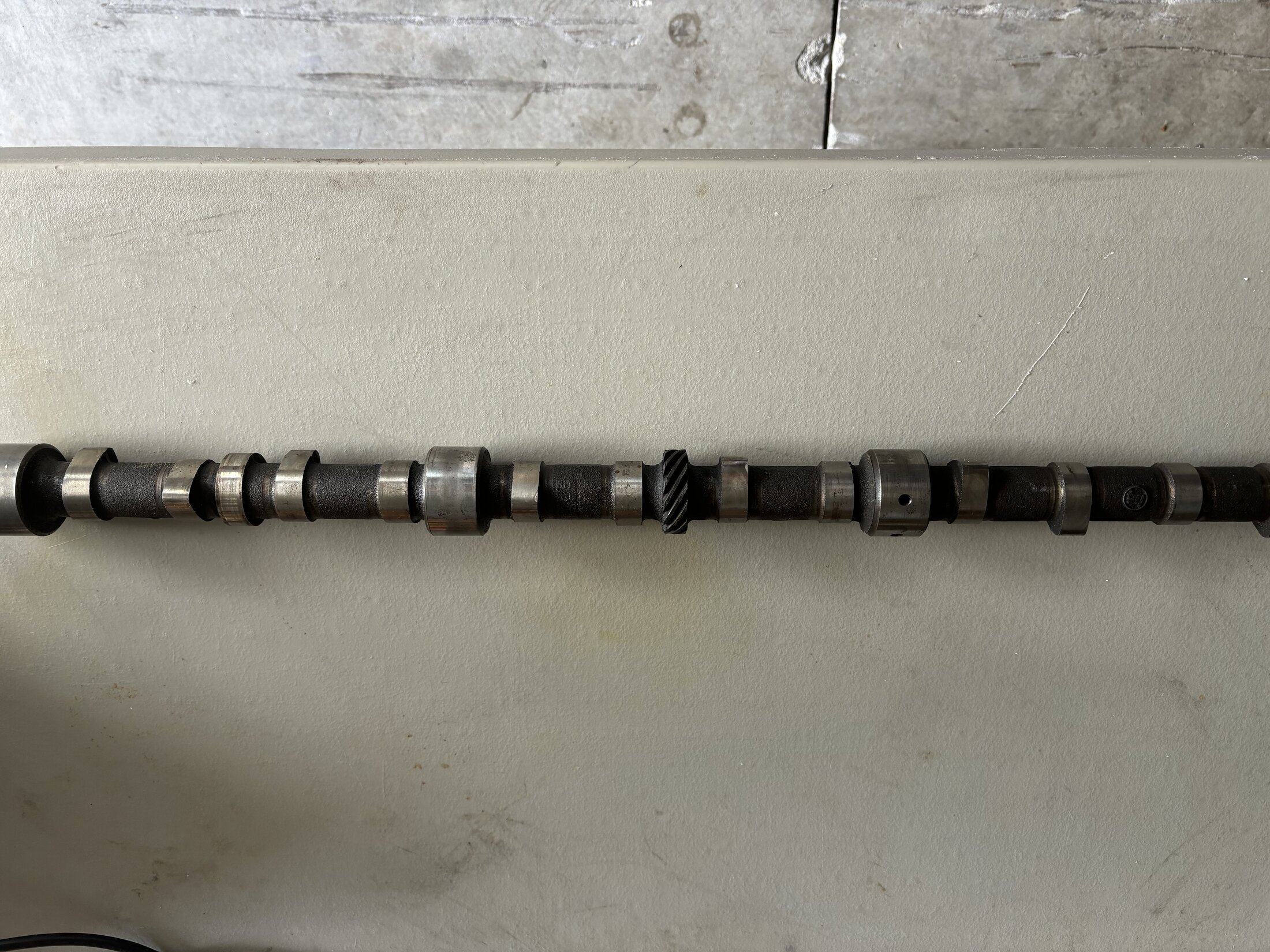

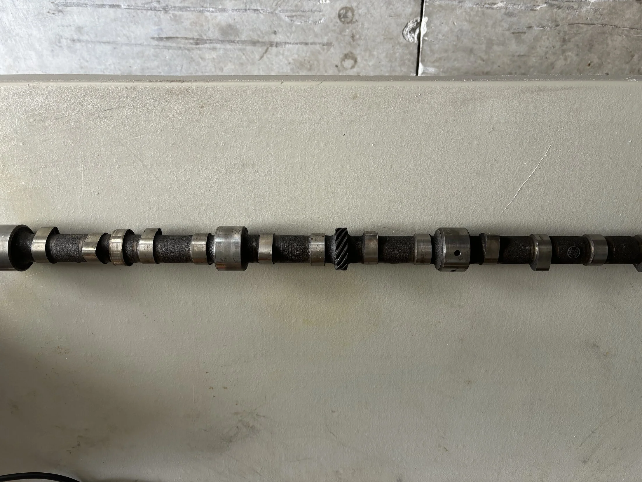

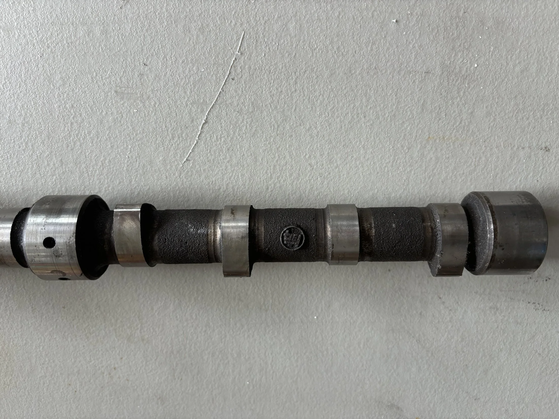

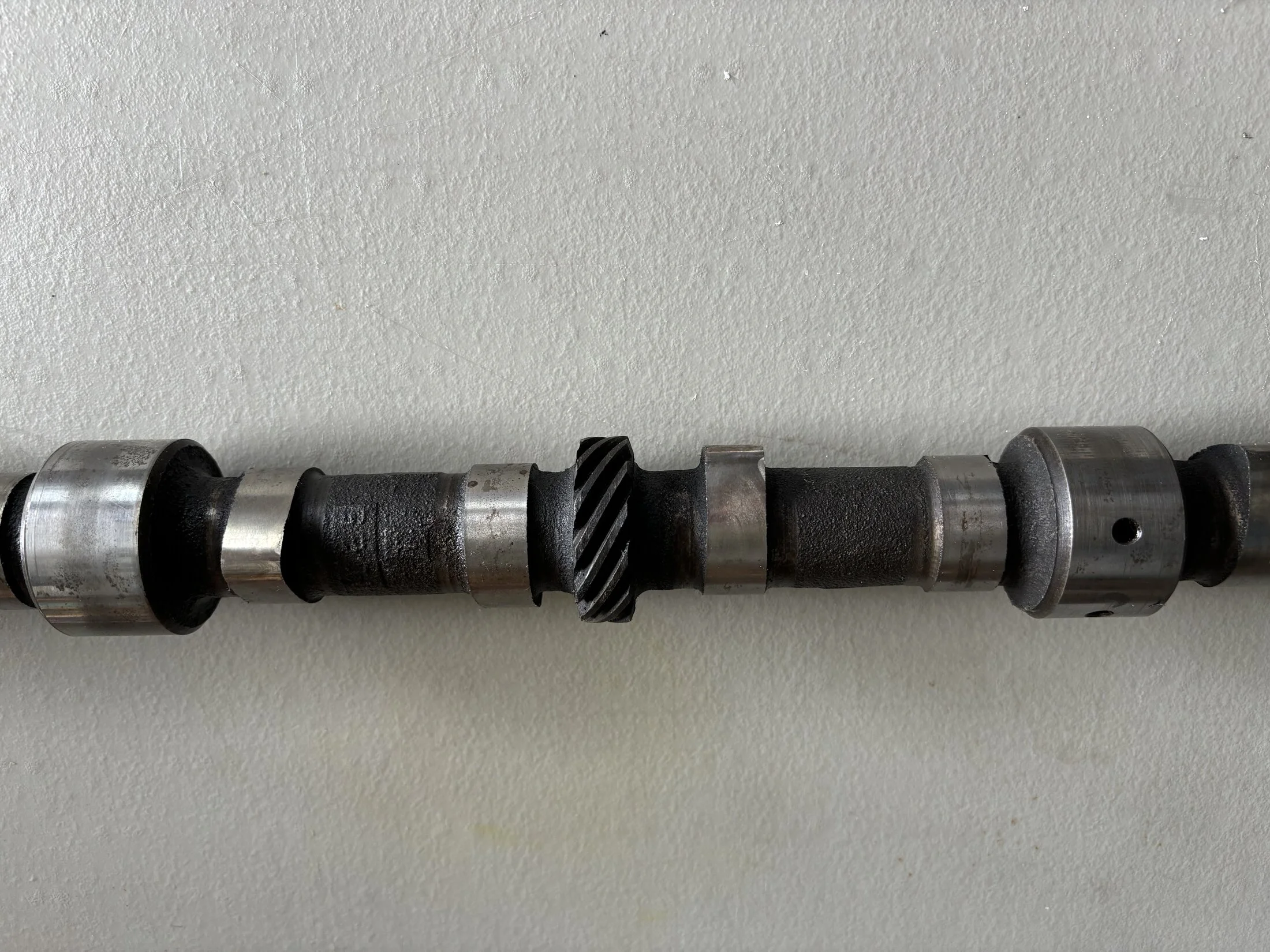

Does this camshaft that we took out of our recent rebuild look decent enough for a regrind (to keep as a spare)? Came out of a 1977 FJ40 2F engine. Thanx in advance.
Um there are lobes that look rough to me. Time to measure its actual spec's. Could be reground maybe, price a new cam.
New cam $300 plus shipping. Regrinding $200 +$50 per lobe that needs welding and shipping both ways
When my 2F was rebuilt, the engine shop "reconditioned" the camshaft by adding metal and regrinding. I'm not sure what process was used to add metal - perhaps welding or plasma spray. I know he sent the camshaft out for that but don't know where. Or maybe he was just pulling my leg...
As previously mentioned, the only one that would know if the cam can be saved is a shop that can do the work. Let them evaluate it and give you an estimate on cost, then you can determine if it is worth it to you.
