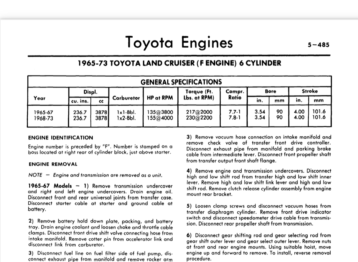

Here’s a screen shot of Mr. Toyota’s HP and Torque for an F. I don’t think the 2F is that much different.
Max torque at 2000 and 2200 for the F. These engines pull great from idle to 3000 with stock accoutrements. If you want to rev to 5000, then that’s your opinion…..I’m looking at it from a conservative angle, non-counterweighted crank, low compression, unequal intake and exhaust runner length, push rod valve train…..ain’t no OHC BMW IL6….and although 200 HP may be a target, Mazda is getting that out of 1800 CC, half the displacement of these cast iron beasts.

I do know that the 155/230 claimed numbers above are... let's be gentle and say... just a wee bit on the optimistic side. ;)
The 2F was rated (more honestly) at 136hp @ 3600rpm and 210ftbls @ 1800 rpm
