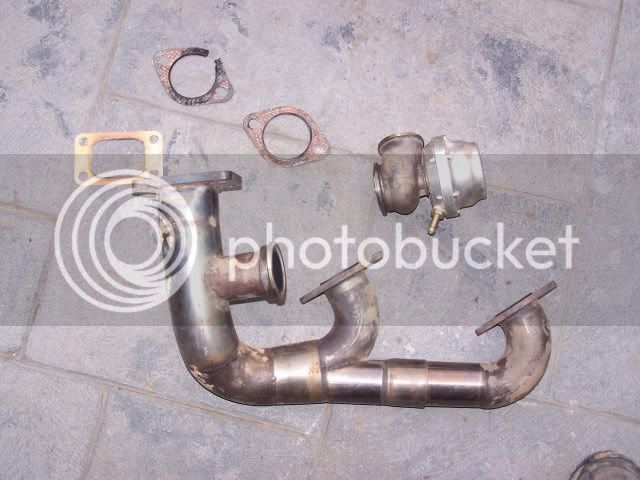

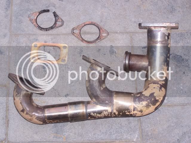

I finally got into the turbo manifold, MPC who made this up did a great job on the whole but missed the boat when it came to the details.
First they used Nylocks for the exhaust bolts, when they fixed that and the exhaust leak as result of it, they said the wastegate valve seat was missing and therefor not sealing properly, I pointed out it was in the box I gave them when they originally fitted it and they were they only company to have anything to do with it, and it had never been touched by anyone else, they say it was never there. I asked why they fitted the system without it if it was not there in the first place. I also pointed out that all the dyno work setting it up would have to be checked and adjusted at PGS.
Have to say there attitude was very poor in regards to rectifying there mistakes so when the exhaust leak returned shortly after them fixing it I did not return and just put up with it until now.

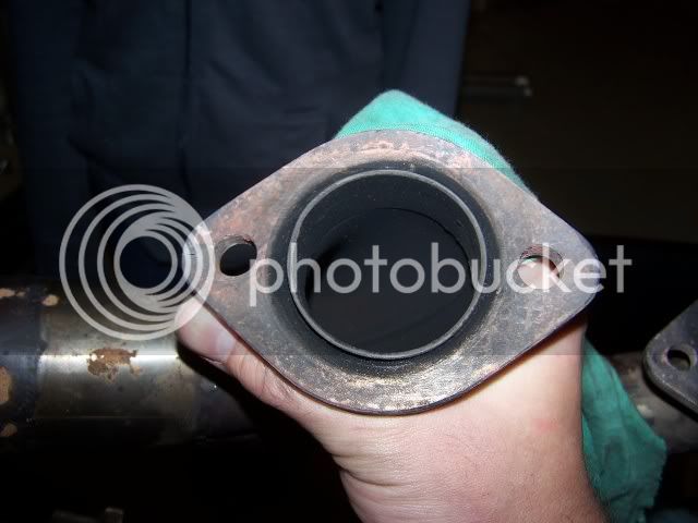

Yesterday I removed the turbo manifold, as you can see one gasket held and the other did not, but that is more by look thank management.
The outlet from the 3FE headers is bigger than the inlet to the turbo manifold, you can see this clearly from the black ring on the turbo manifold.
This should be equal or larger than the 3FE outlets for good flow, this is just so wrong and for a company that tunes circuit racing Lambos and V8 supercars MPC should know better.
The O/D on flame ring on the gasket it's self is actually about the the I/D of the 3FE headers, too close for comfort to guarantee a good seal.
This means poor flow to the turbo and there for less power than it should have, and the gaskets are forever going to fail due to the stress on them even I used one that was sized correctly.
Anyway now I know the problem and with the history of errors I think I may just be *issed off enough to seek legal advice if they are as disagreeable as last time. But first a letter of complaint to see if they will do the decent thing.
As for the manifold I have a few ideas to improve it, first though I will buy a couple of genuine 3FE gaskets.
