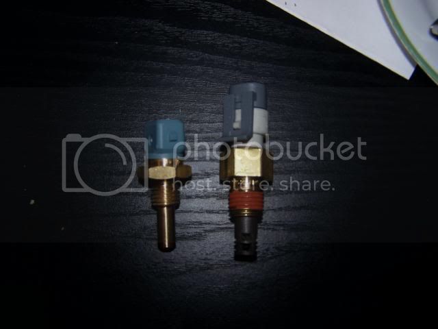

Also picked up the air and water temp sensors today too.

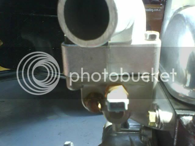

Their will be one air temp sensor in the 80mm out of the intercooler, one water temp sensor for the ECU in the thermostat housing and one temp sensor for the instrument gauge also in the thermostat housing.

Air Temp sensor is here on the feed from the intercooler.
All up there are 4 sensors, air temp, water temp ECU, water temp Gauge and Throttle position sensor (Factory) not including the Dizzy.

Water temp sensor and sender are here one for the ECU and one for the factory gauge.

Just a note, that is a 3FE thermostat housing bottom with a late post 2F 1980 top. The stock 3FE top had for me too many holes in it for sensors for the 3FE ECU

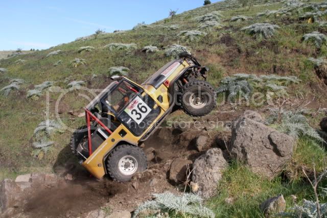

Actually my Navi is responsible at Vic winch 08 I got stuck and had to winch here this year my Navi drove it and still managed to claw his way to the top to the finish line.
He actual drove that section without getting air but just a little further he snapped the left front, I like the rule you broke it you bought it :D
Wow, how?
I am just so skilled LOL
My navi made the comment at the start of the weekend "what happens when you let 2 nissan drivers into a 40 series with 180kW?"
Well, it seems we know now.
