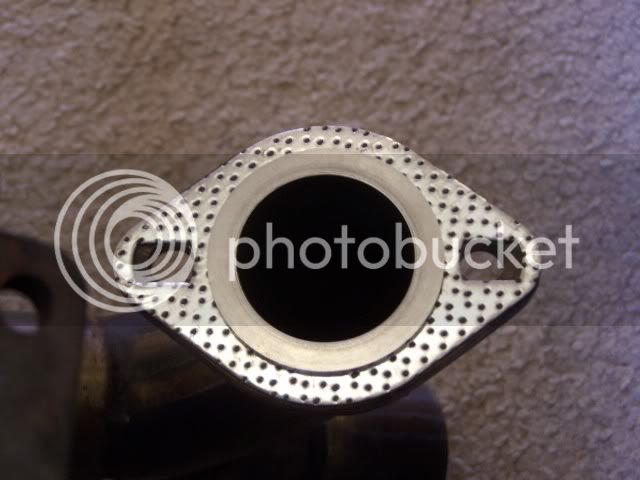

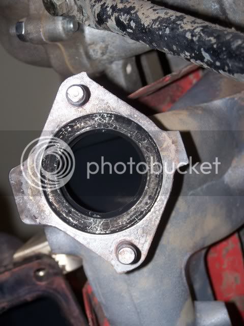

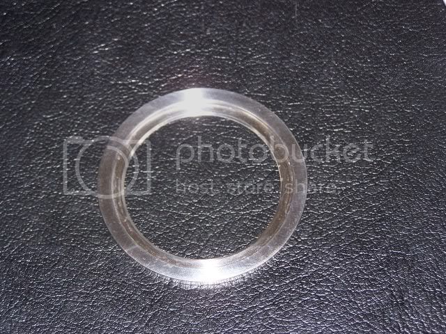

Also in this week are the 2 collars I have had made to fix the exhaust leak. These will sit flush inside the 3FE headers and give a much better transition between the two systems. It also means the correct sized gaskets can be used rather than an over sized one trying to cope with 2 different sizes.
The issue is the 3FE headers were never designed for a flat gasket rather a compression ring that sat in in the large grove.
The problem was the area with nothing in it was bigger than the exhaust it was entering, so poor flow and a build up of heat, along with a poor fitting gasket as it was trying to cover both sides rather than fit one side well was always going to cause trouble.
With the collar in place a stock flat exhaust gasket of the correct size can now be used.
As you can see the fit is far better on the Turbo manifold with the flame ring clamping against the collar rather than before where the flame ring was inside the exhaust on one side.

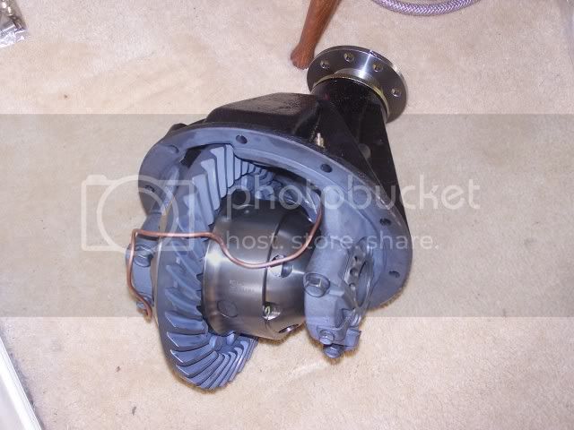

Well have to say big thanks to Hann's for lending a hand today, the new diff was a not as user friendly to fit.
Infact it's a real step backwards in my opinion. Getting the copper air line in is hmmmm a $hit of a job and you can't guarantee it's not going to rub on anything.
The old copper line was all too easy and did not hinder fitting.
The new is very hard to get into the diff housing as it goes over the crown wheel and does not slide into the diff housing without having to push it under even while tipping the diff backwards. PITA of a job.
Infact in the position in the above photo it actually pushed into the crown wheel in place in the diff housing, yes easier to fit with it there but not going to last 10 seconds. Luckily I rotated the diff by hand and you could hear a clicking.
Took it all apart again and you could see a rub mark on the inside edge of the copper. Moving the line to a better place inside the diff so it will not rub means its a $hit of a job to get in.

Funny little thing that copper air line. I would be interested to look at a few of them side by side and see just how precisely they actually bend those things up, one after the other. Reeked a little of a stab-in-the-dark she'll be right sort of engineering. Real good thing you noticed that clicking.
