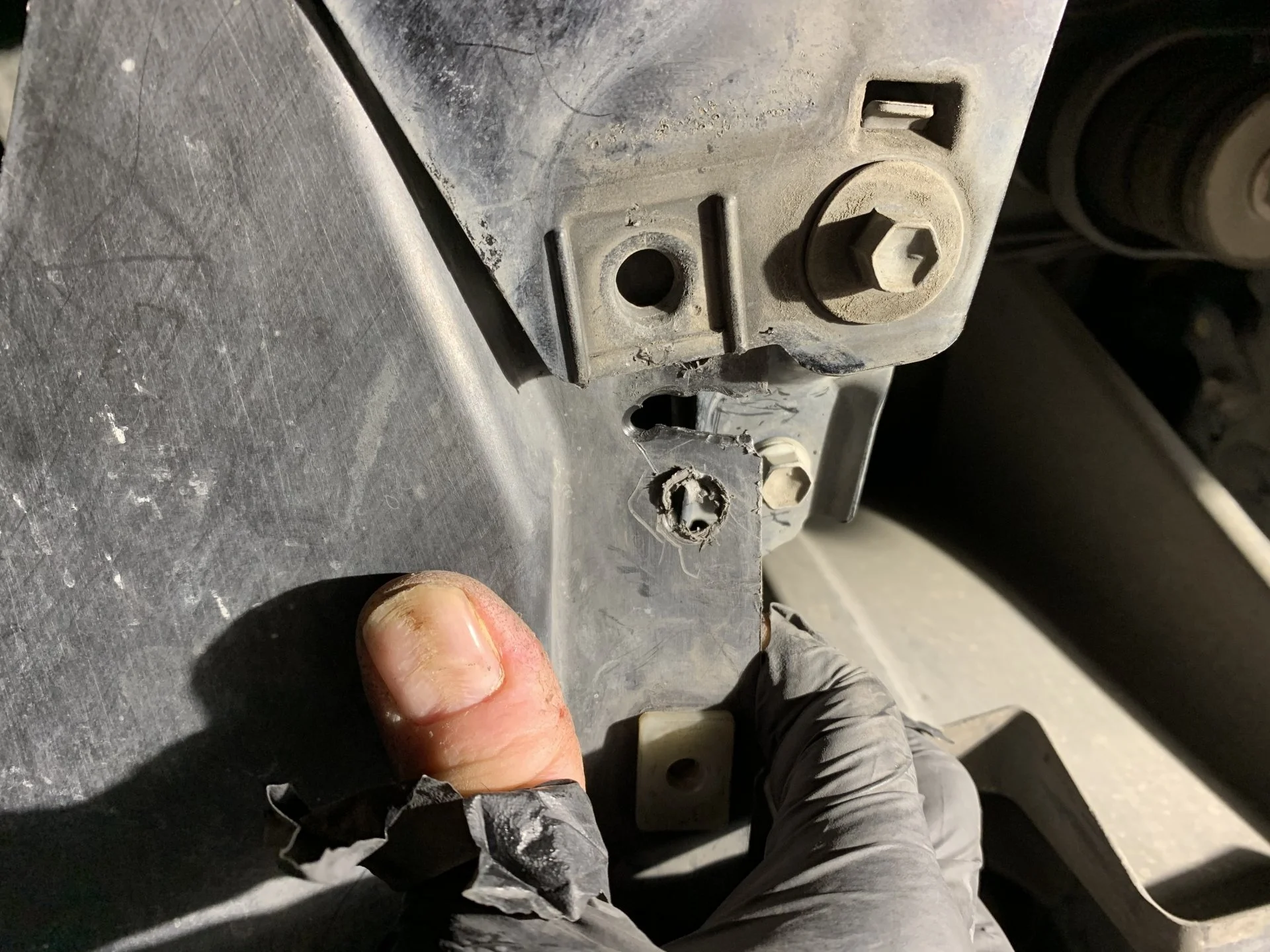

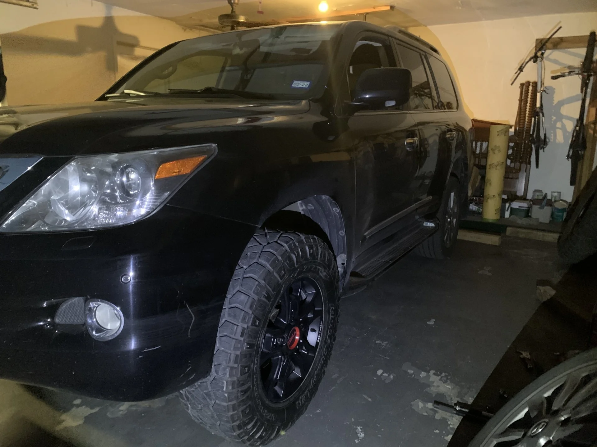

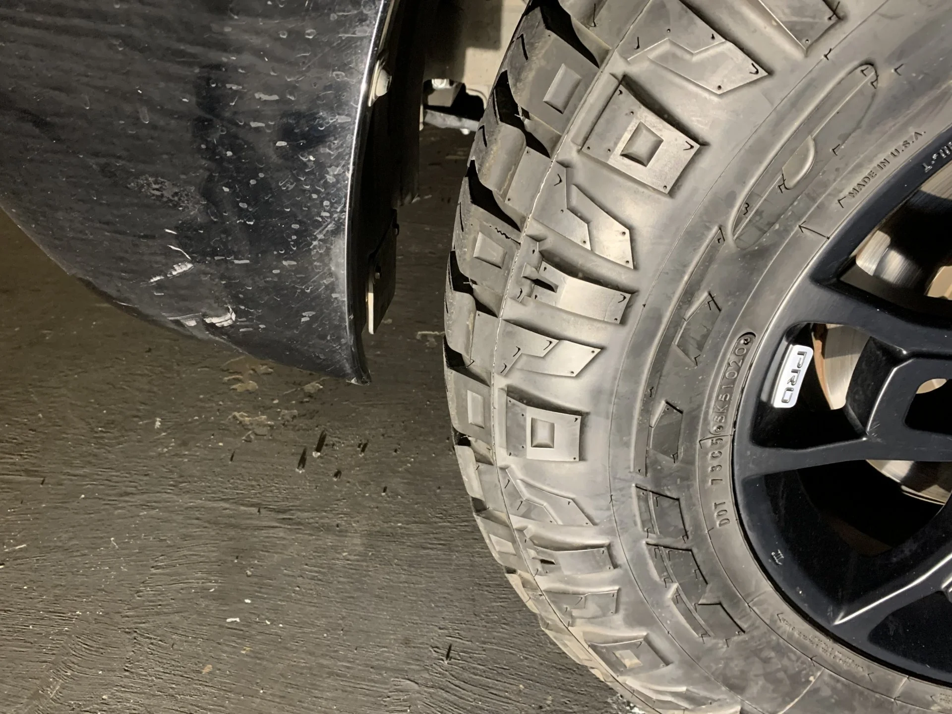

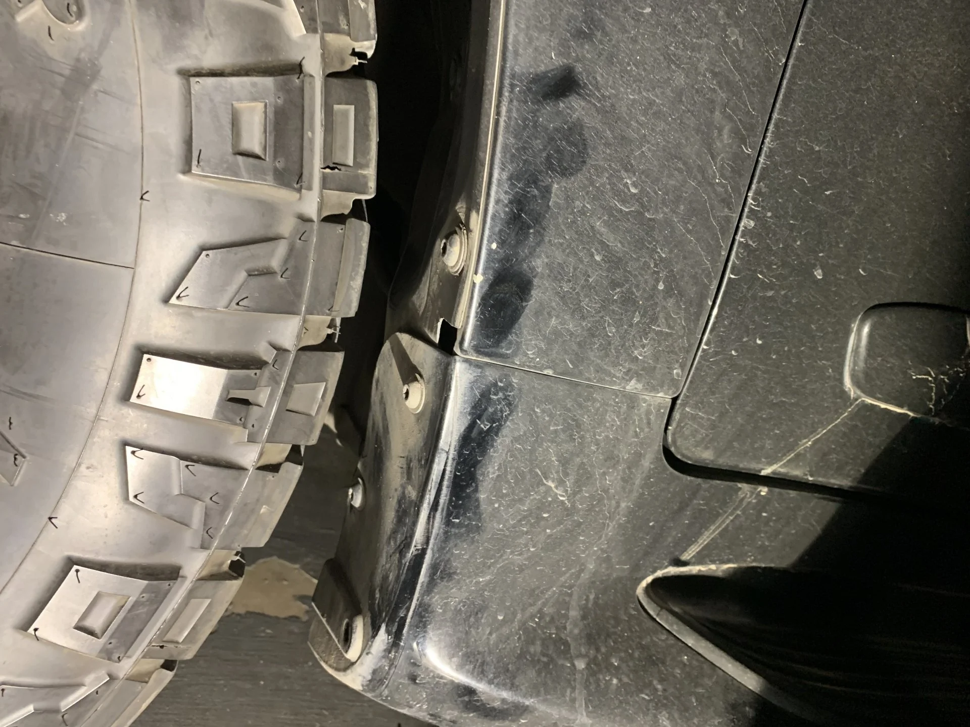

I installed the front tires/wheels today, but with a 1.25” spacer and ridge grapplers. I’m not seeing how this could fit without work, and not at all in some spots. Then It dawned on me that I have a 100% stock LX and @tbissacs is running an aftermarket bumper.

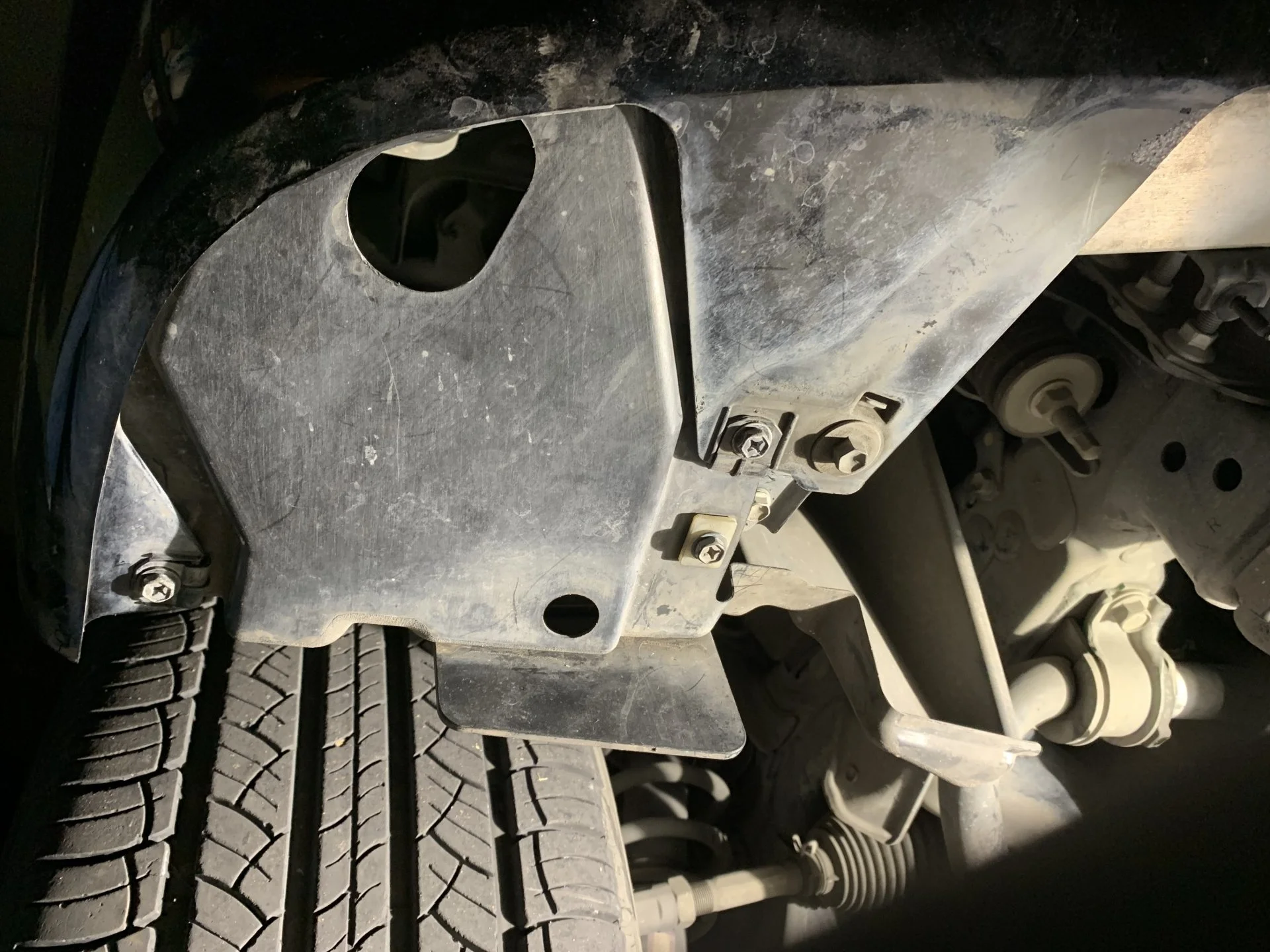

there is interference at the front, but I know that there’s a few common mods to deal with that. I need to look those threads up. I think I can figure that out.

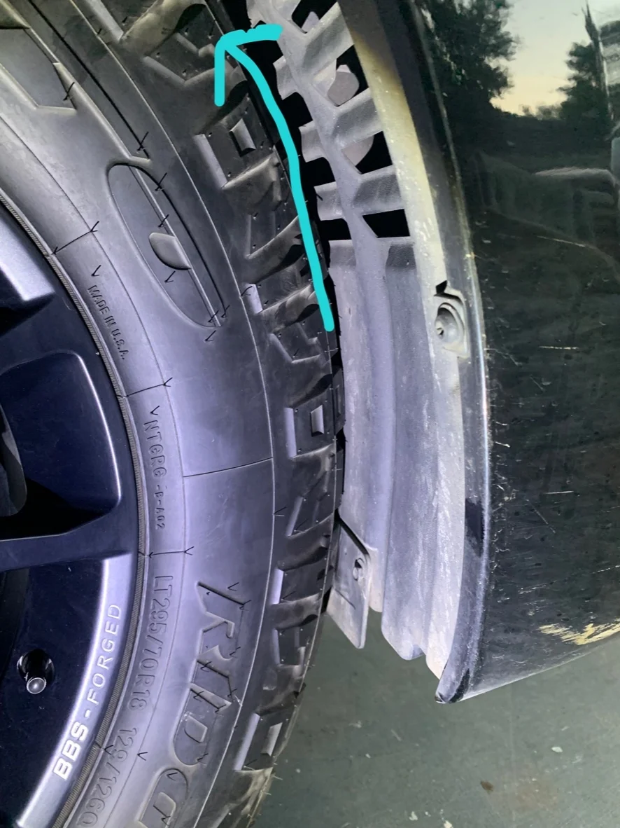

it seems like it was so close to the front upper fender liner that it will hit if I bottom out. Maybe not. I’m not sure how much further the truck can drop from the low position.View attachment 2703155

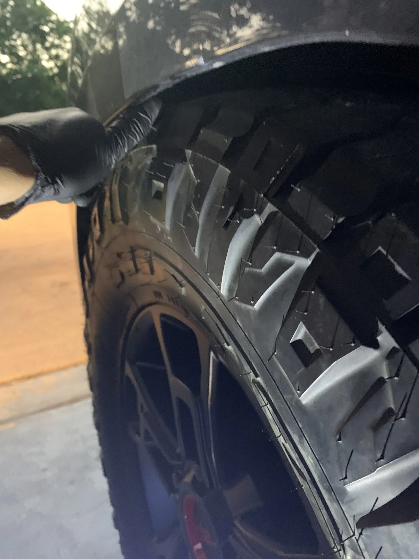

The other spot that seems like a bad day waiting to happen is near 12 o’clock at the fender. It seems like it will hit the metal fender but again, it could just be very very close. I can fit a thumb in there. Maybe this indicates that 1.25” spacer is just a touch too much? Again, I’m not familiar with how to measure such that I can make sure it never hits the fender.

I think it will look awesome if I can get it to work and perform properly and safely.

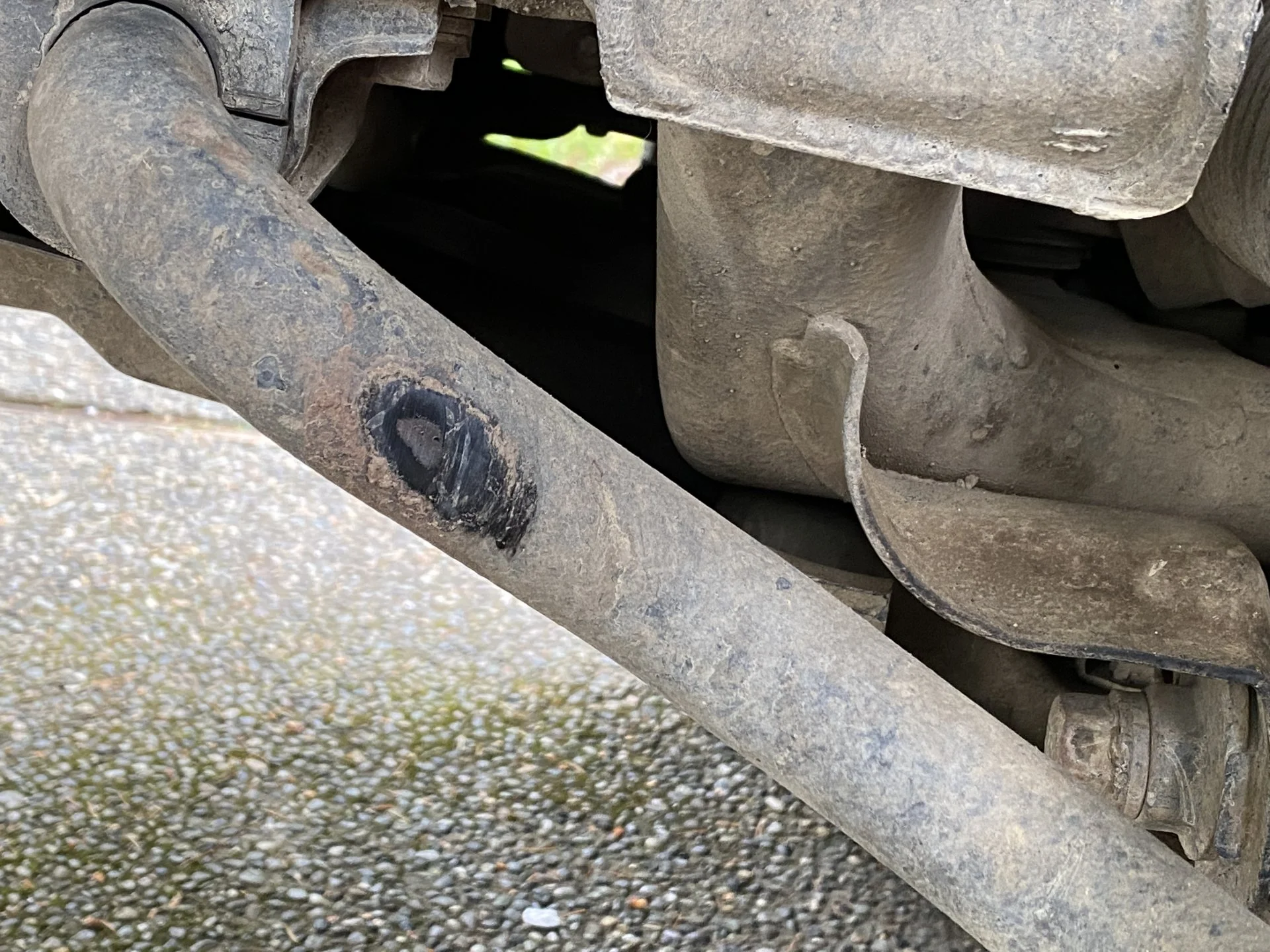

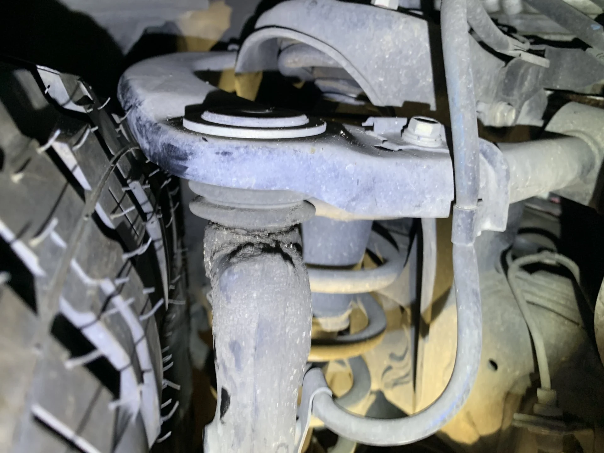

How is the fitment treating you? Thinking I may upsize from my 275/70/18 to the 295/70/18s as well.Following up, doing brakes today and noticed slight rubbing on the sway bar. Not too concerned but I do think a 1.25” spacer would fix it.
