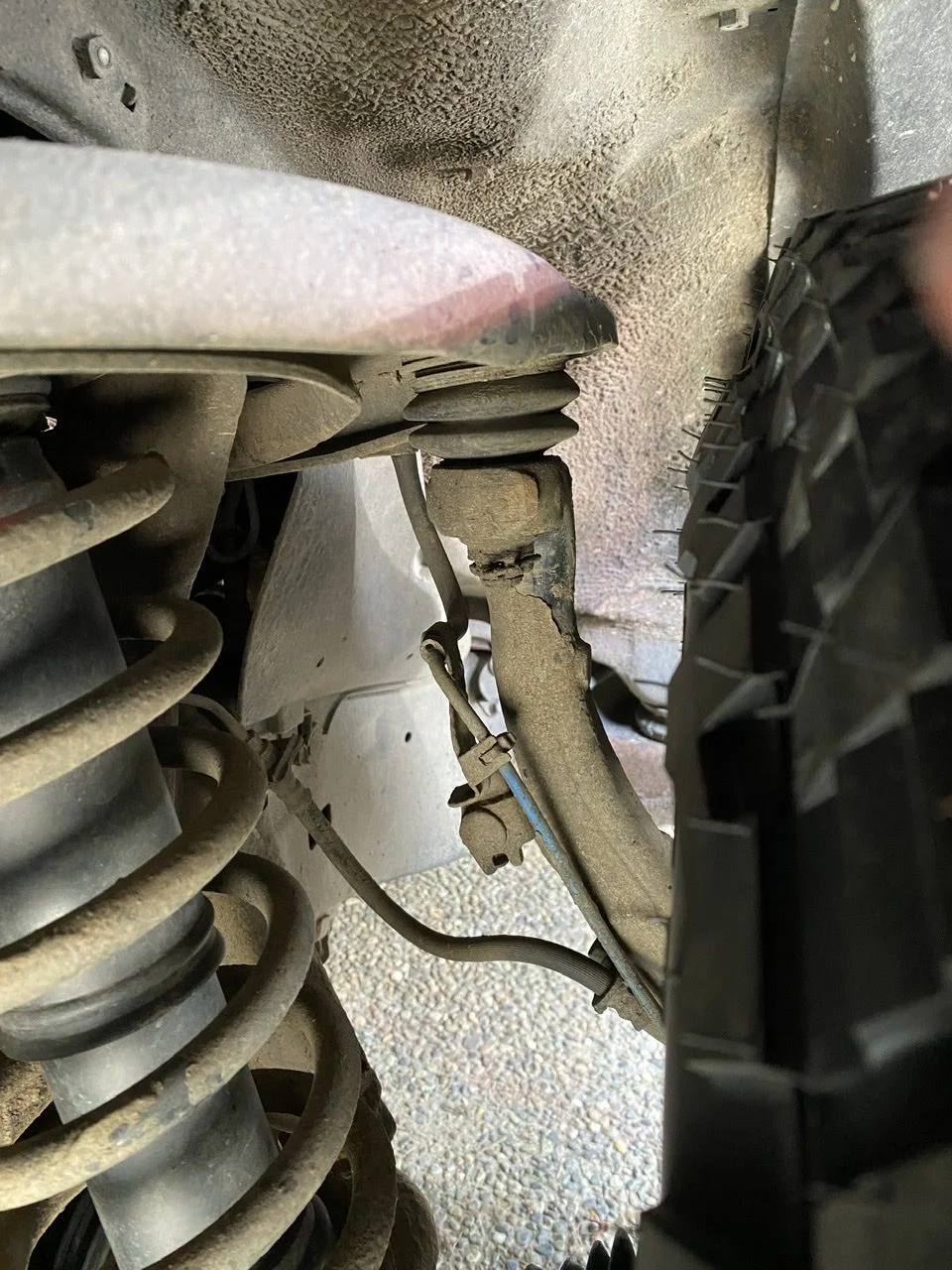

@tbisaacs is it possible to get a picture of how close the tire is to the UCA?
Lots of room
Looks great. LCs (and LXs) look so much better with bigger rubber.
Looks like plenty of clearance and I think you'll be just fine.

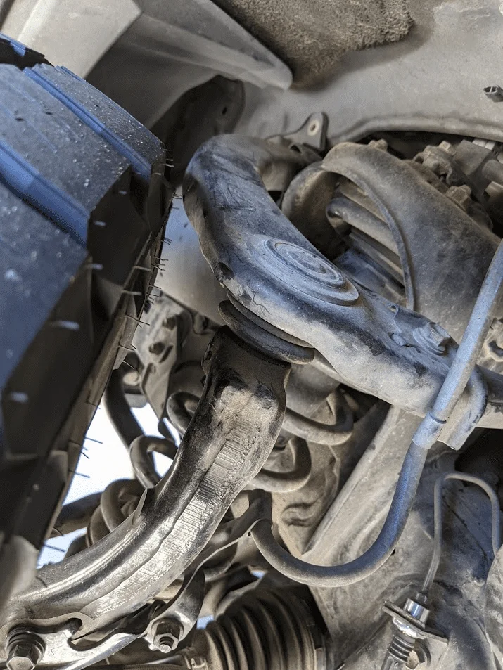

To be sure, the tightest clearance to the UCA will be at full steering lock, with suspension fully compressed. You could probably check it quickly at ride height with full steering lock and see what the clearance looks like. My incrementally larger tire looks like this, which does interfere with the arm at full compression. I suspect yours will be very close but okay.
Very good point - will check but not expecting any issues. Especially if you are fitting a full fat 12.5" latte.
