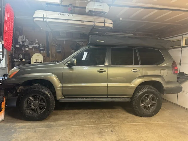

Been reading for a hour or so on the tire thread. About to go get new tires installed and looking at Toyo RT in 255 80 17. I have the 1” Dobinsons lift. What needs to be modified to fit this tire on stock wheels?
Edit: I’m currently running 275 70 17 KO2s with slight rub ant fulll lock in reverse.
You may get a little rubbing at the back of the front wheel wells... quite possible all you need to do is massage a little plastic, would only be at full lock, and while backing up. That was my experience at least.

We’re in business…
Nada….slight rub in reverse at full lock only.

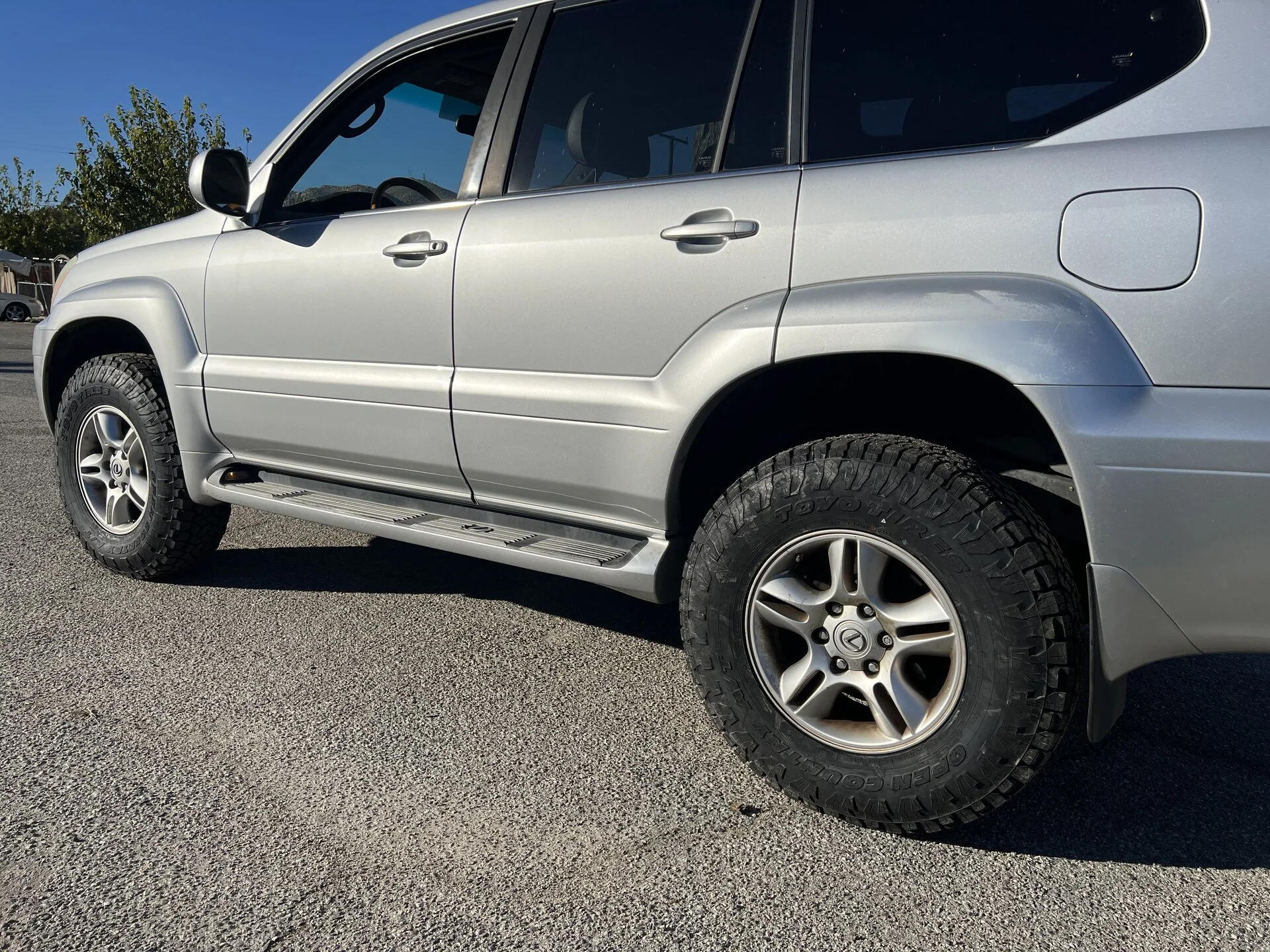

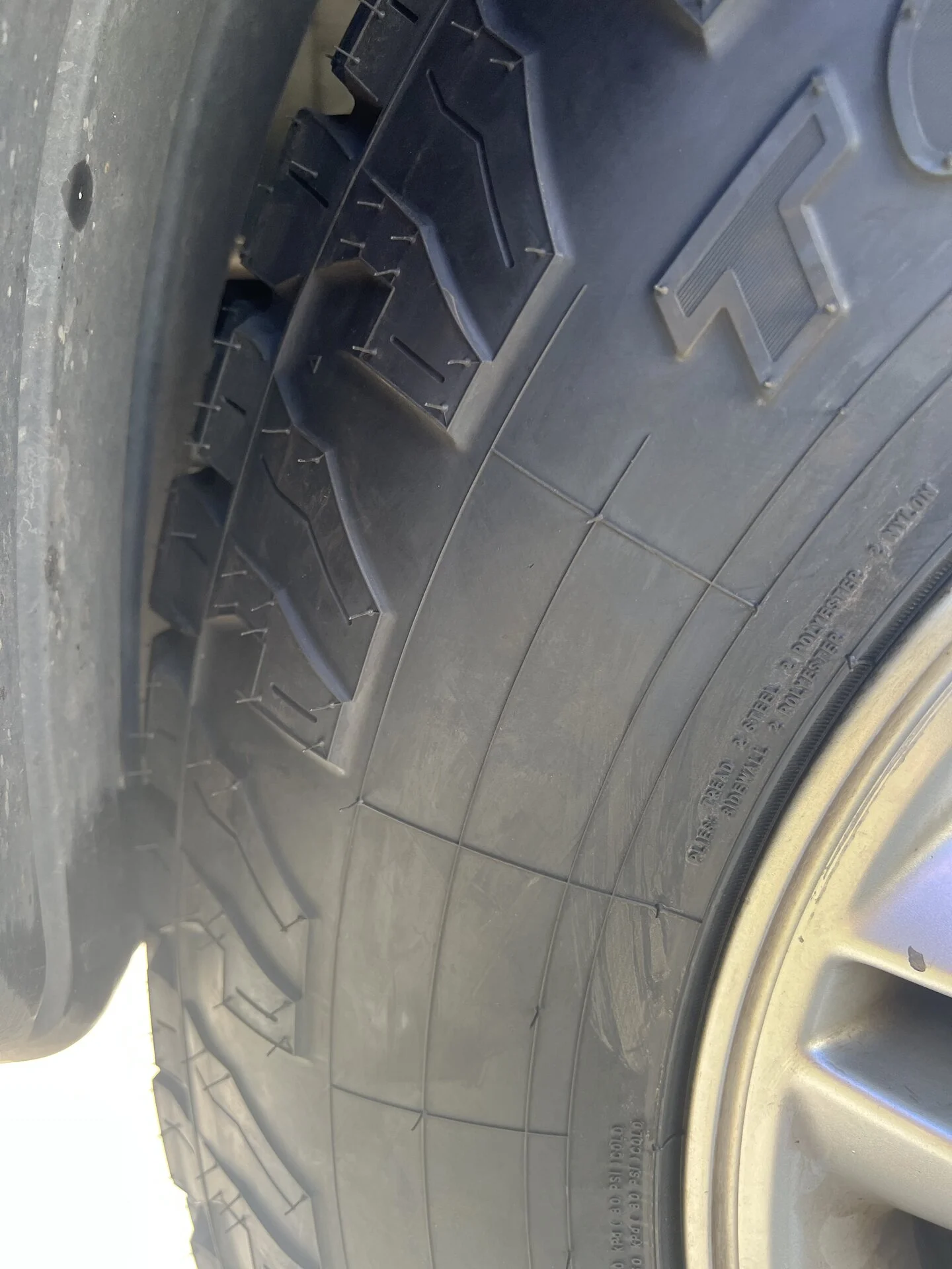

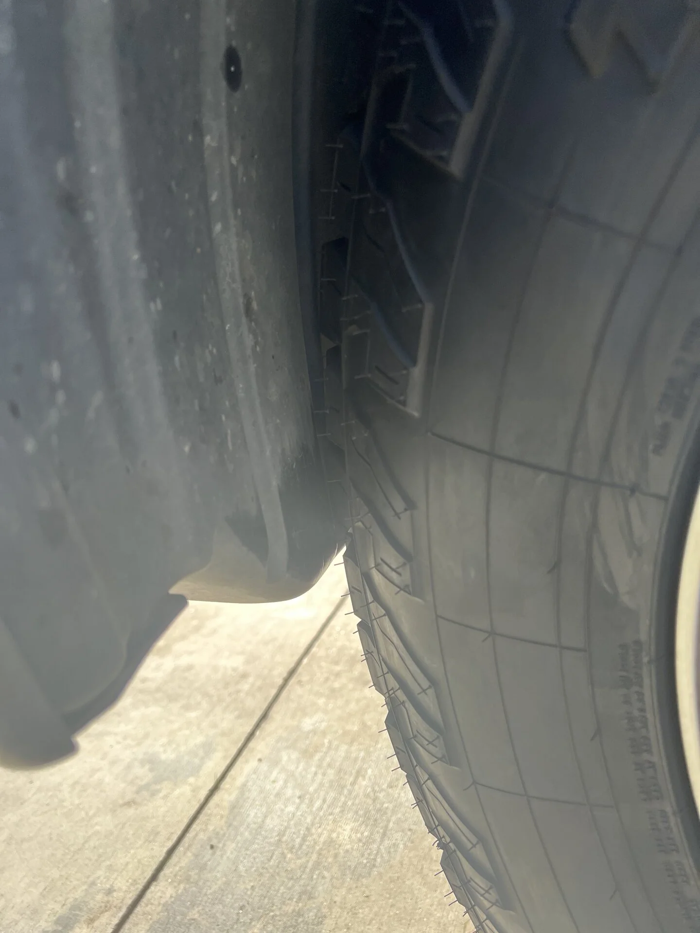

Just normal driving…haven’t flexed or stuffed. Front tire kisses inner fender plastic at full lock in reverse. Made a tight turn in forward and no rub on either side. Shouldn’t take much to remedy.
These are Toyo Open Country AT III.
Just barely touching the leading edge of the inner fender plastics at the bottom corner.
I might just Dremel cut that little section off and mould a bit with heat gun…looks very minimal to me.

I’m not sure on my spring model…it’s lie a 1” lift. I haven’t got around to trimming the plastics yet. But the do rub in reverse when turning.

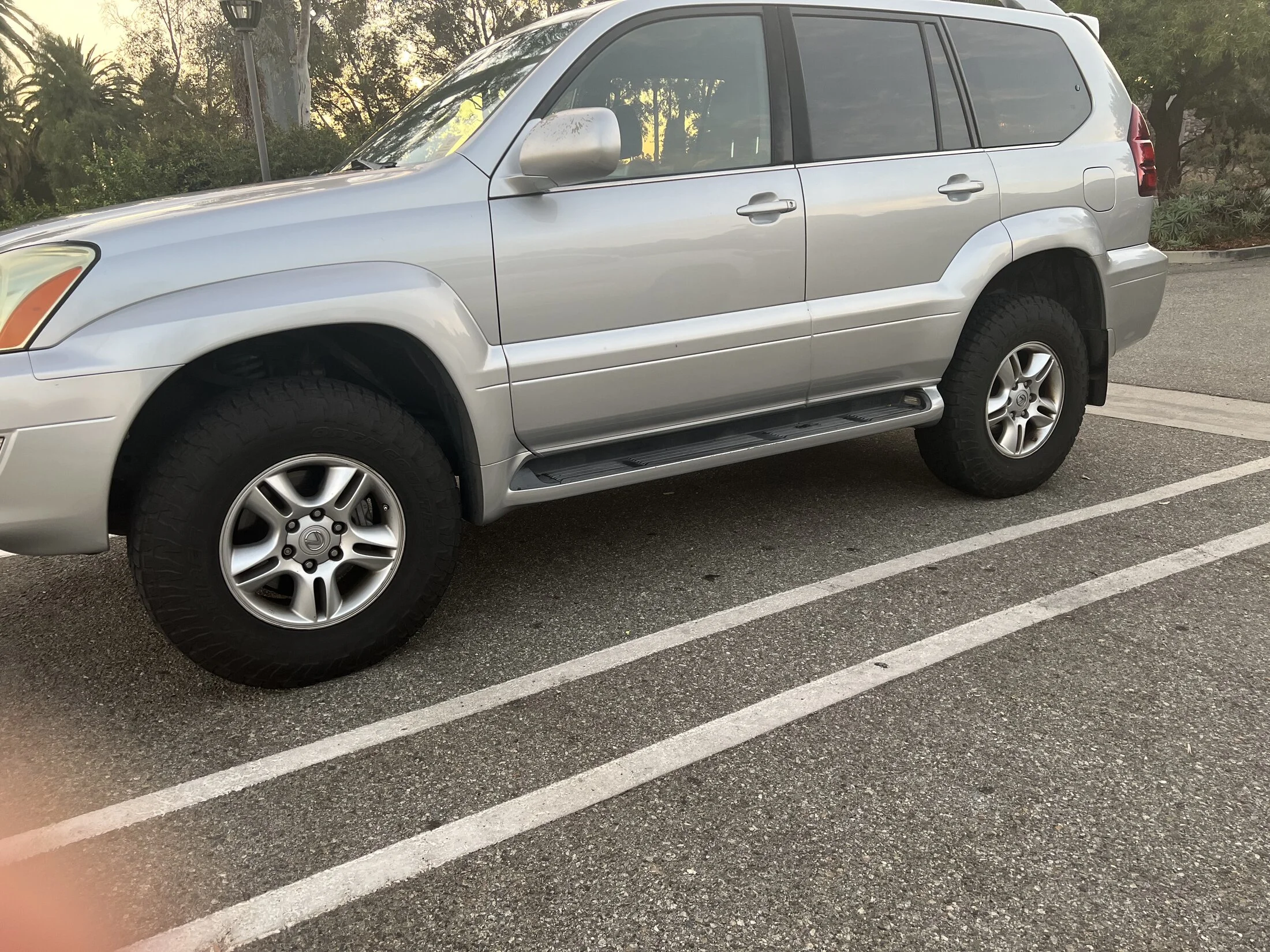

Can you post a side shot of your truck please!
I’m looking at 1 inch lift and 255/80 as yours.
Thanks!

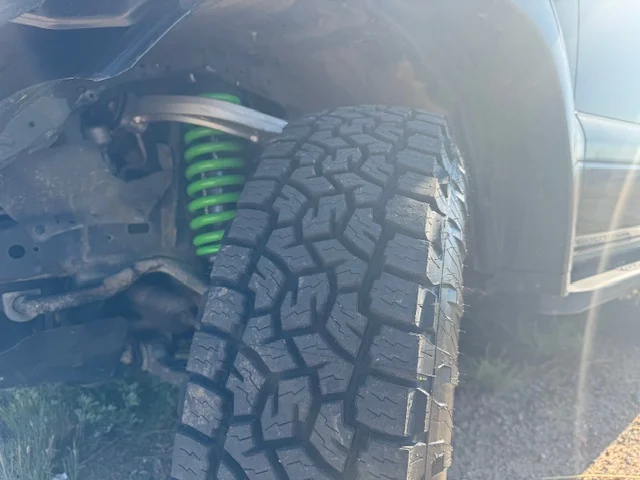

well, I'm back. Now running 255 80 r17 Toyo AT3's... also the stage 4 Iron Man lift, which is about 1" taller than the OME lift I had on there before.
one wheeling trip in the books, still pretty happy with them.

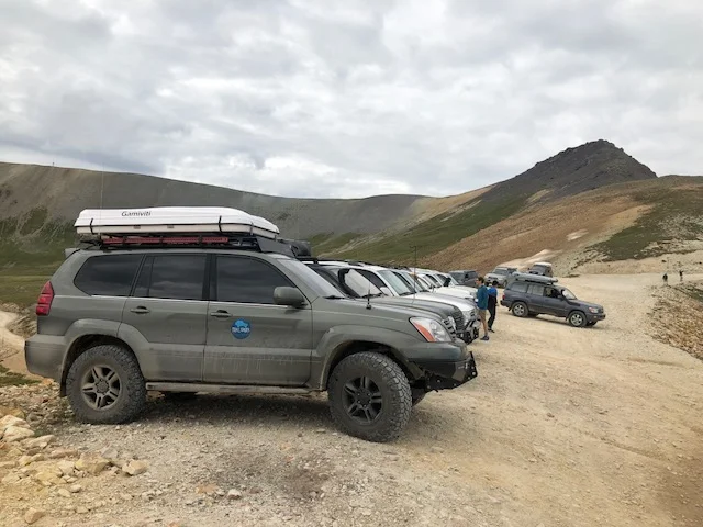

My 285/70/17s don't rub one bit. I have an ARB bumper, UCAs and a proper alignment. No BMC. ~2" lift.

Here's a vid to 'relocate' the fender liner a scosh for that rub. 0.75" levelling puck with 265*70 17s I had the reverse full lock rub. This was my fix.

And thanks for sharing the pix, nice fit on 1" Dobs lift!!!
