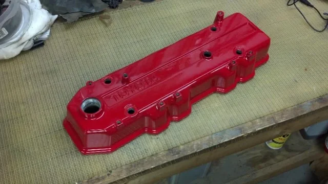

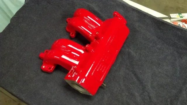

I'll toss these up here now since the discussion has drifted to powdercoating. I picked these up a few weeks ago (I also got the lower intake done and a few other things)
The valve cover does take a lot of prep to do properly. I carefully drilled off the swaged heads that held in that baffle underneath, they are actually pins in the casting of the cover, not rivets. I then tapped them for #10-32 button head screws. There was a disgusting amount of dried engine oil crud under that baffle, even a hot tank would not have gotten it out (I don't think it's a good idea to hot tank a thin casting liked this anyway). The powdercoater probably wouldn't have done it without removing that baffle, too much of a chance to spoil the finish when it got baked. Bead blasting was required, just before putting the powder on.
The intake was also a lot of work to get done. I spent a lot of time with brake cleaner, a toothbrush, Super Clean, and the pressure washer to get it clean inside. He could have done more detail on the "EFI" casting but costs go waaaay up when you start to get into that.

KLF,
good call on the tapping. didnt think of that...looks really good man
You have to be VERY VERY careful when drilling the holes to tap. I did everything on my drill press with new sharp bits. There is not a lot of depth, so you have to be careful not to poke thru the top. I had a spare cover so I could afford to give it a try, if I messed it up.
You also have to get 2 taps, a regular taper cut then follow it up with a bottom tap so you get threads cut all the way to the bottom of the hole. Go very slow with lots of thread cutting oil.
I put the cap screws in pretty tight, with lockwashers AND red locktite. I was not able to get a new gasket for the baffle, so I just used gray "Right Stuff".
