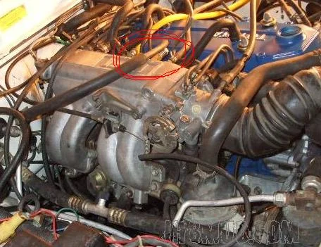

Here is what I'm looking at.

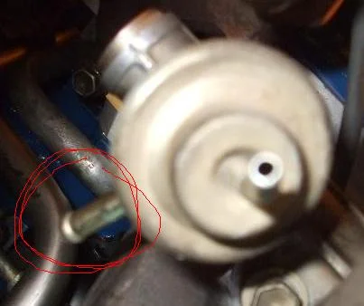

Please note that the Distributor does not a standard vacuum diapragm on the side. It does have an aluminum "pot" with two nipples on it.

And what plugs into these two nipples?
What is this thing called?

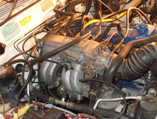

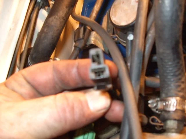

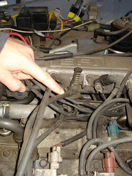

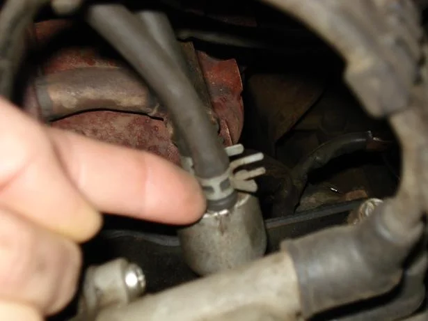

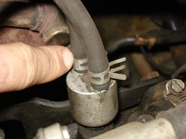

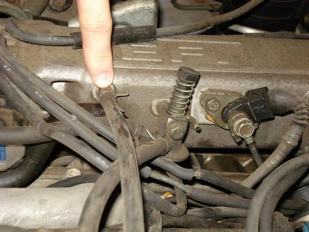

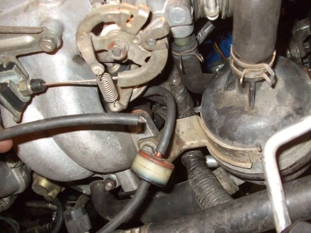

Ok here are three pics. I think this is what you are looking at. The one on facing the driverside perpendicular to the head goes to the thing next to the distributor.
The one that goes to the drivers side ends up here on mine, right behind the distributor. It is the hose on the right side in the pic
The other on goes onto where the intake tube meets the "plenum" (I have no idea what it's called lol) It's the hose with red on the end.
