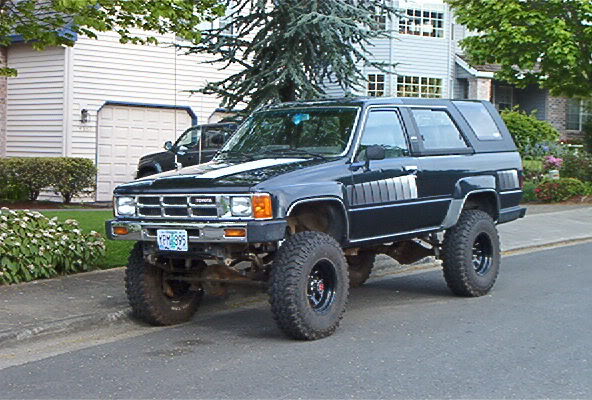

This was my daily in college:
1985 4Runner, 22RE, 5-spd, 4.88 gears, Loc-Rite rear, 33x10.50 BFGs...
Damn I miss that truck!
Yes you do miss that truck!!
