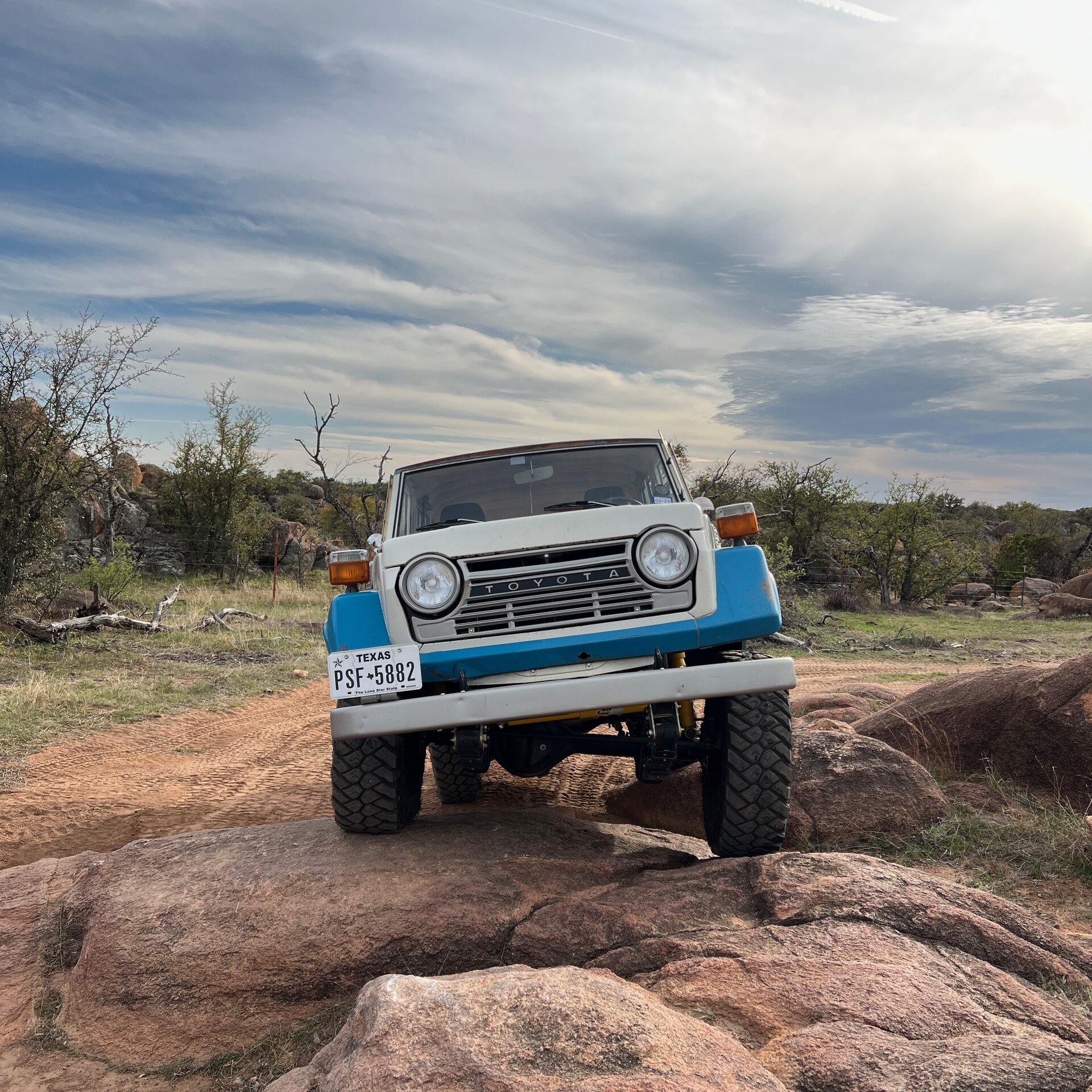

First day we drove easy trails to get a feel for the capability of the truck, and make sure the t-case and front wheels engaged. It worked great... maybe a little too well, because it made me over-confident for day 2. Poser shots from day 1...

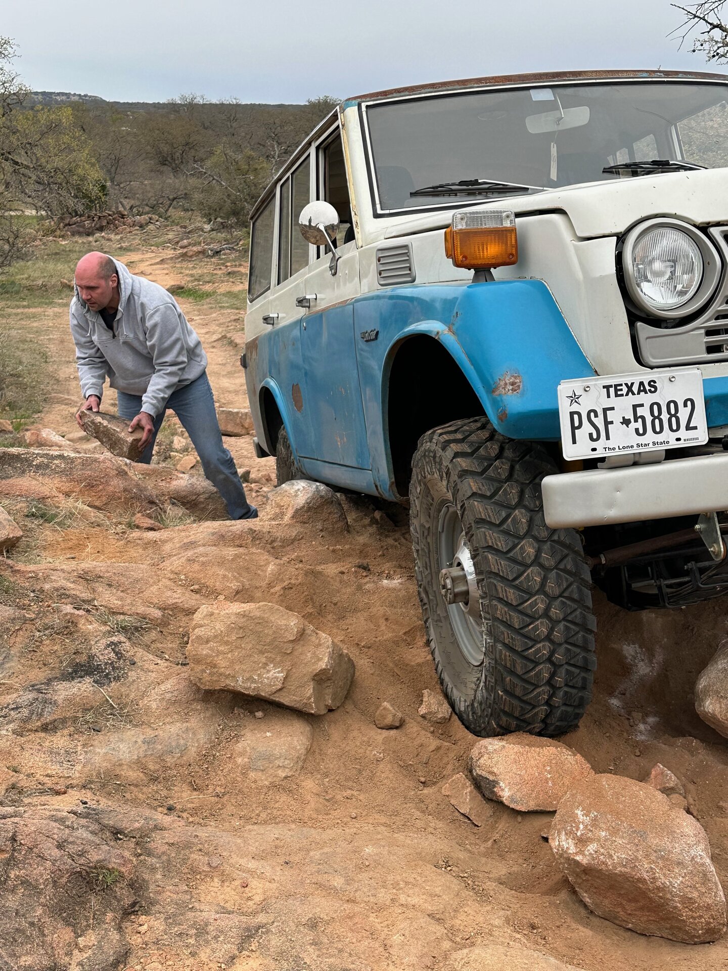

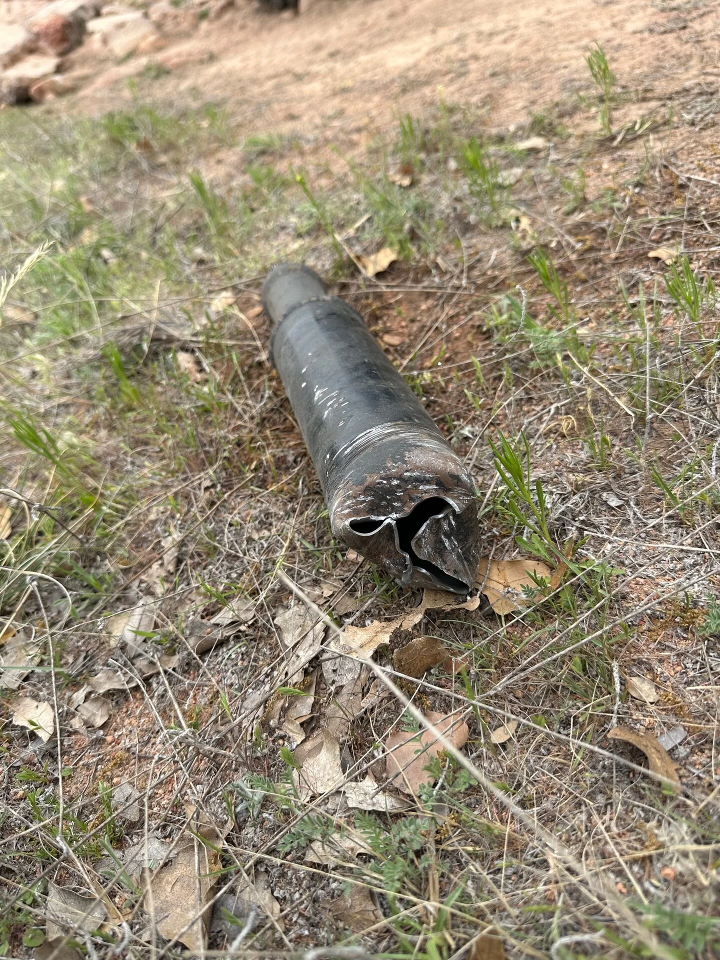

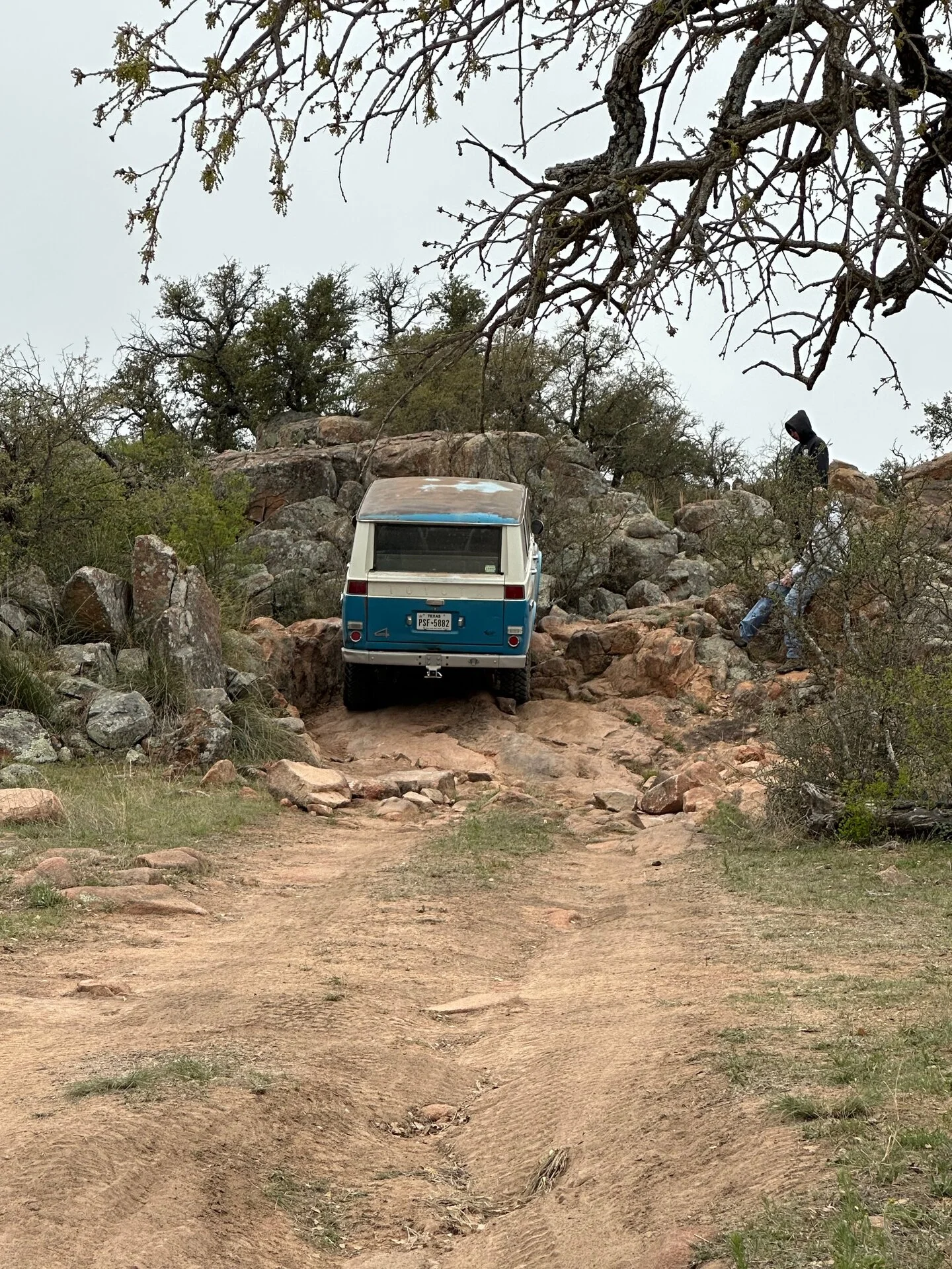

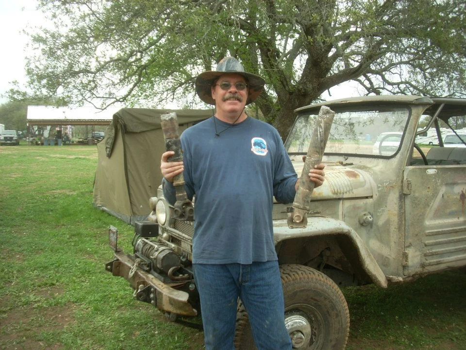

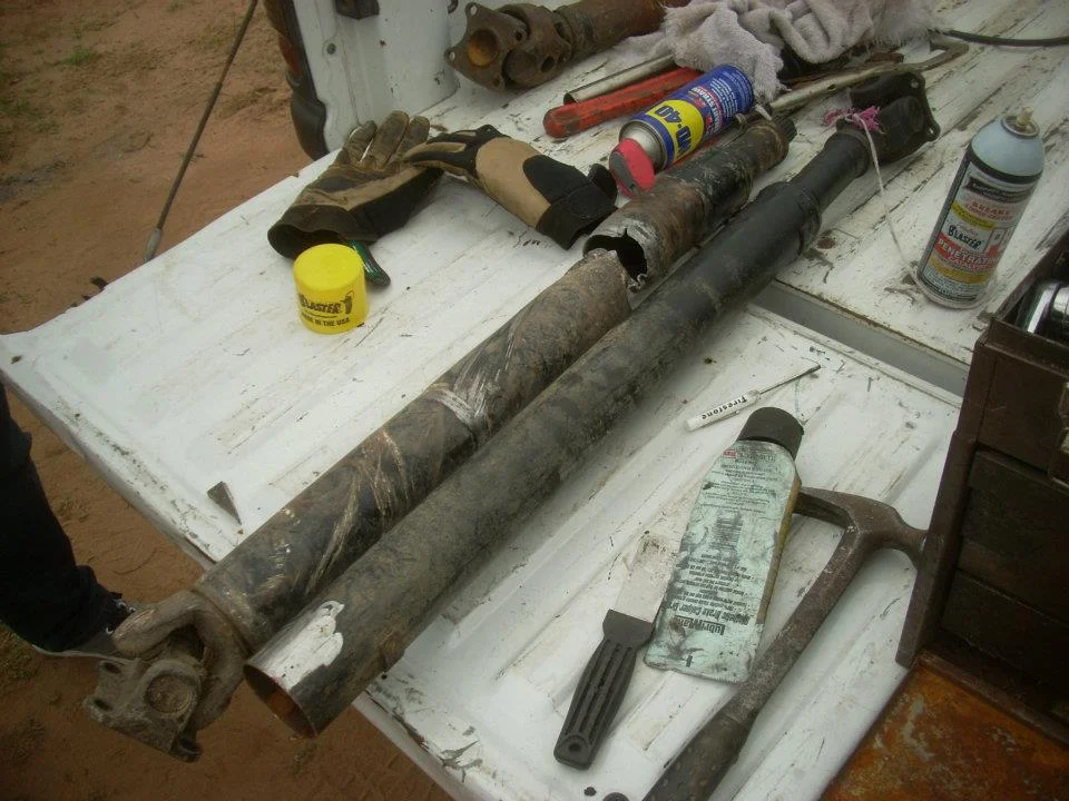

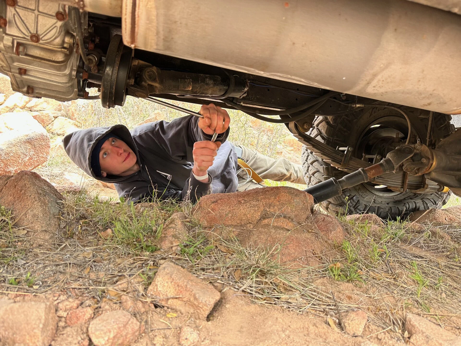

Day 2. Let son drive, and I spotted. Made it through some semi-difficult spots to make sure he could handle driving the pig off-road with the 5 speed. He's driven my fj45 and fj40 at this park, but both of those have auto transmissions. He does great following the spotting directions. We came to a more difficult obstacle, and I figured we'd give it a try. We just about had it, but when the pig went to 45+* and all the weight transferred to the rear wheels the driveshaft couldn't handle the torque when the wheels went from sand to granite, and the shaft spun itself in half. The shaft was out of my FJ45, and it had been dented in our previous trips to the park. We called @Havis to help pull us backwards off the rocks. To make sure the front half of the shaft didn't pogo stick when we came down and end up damaging the output of the t-case we used a bungee cord to hold it up. When pulling the pig back the shaft ended up cutting the fuel line. Once on flat land we quickly did a field fix on the fuel line and pulled the 2 halfs of the shaft out, then drove back to camp in front wheel drive. Got back to camp, took wife's car and ran back to parts store from day 1 and bought new fuel line and filter. Nothing else to do but hang out in camp for the afternoon and wait for the event dinner and raffle. I struck out at the raffle, but son won a cool TEQ sign and some FJ40 door panels. Daughter won a box of goodies from Rusty Nail Racing , which included t-shirt, hat, and jacket that were only given to team members, and a personally signed photo of Rob Tygart. She was beyond excited to win and get the attention. Despite the broken shaft we had a wonderful day.
Sorry for the giant block of text. Here are a couple photos (I always forget to take pics, but my wife always has her camera at the ready)...

What a Great weekend and I always have a Blast helping keep folks on the trail. We had so much fun and its Great to see your kids involved they are the next generation who will keep this Great hobby of our going. Shoot we next time we might be able to find some tube and do a trailbuild rear driveshaft ( Trust me I know LOL ) I did the same thing in 2012 my 1966 LV

As for the shaft, we got back to camp around 3:00pm on Saturday, so we didn't lose much trail time, and without a lathe to balance the driveshaft I would be worried about vibrations on the 6 hour drive home. I will get a proper one made for our next adventure. :cool:
