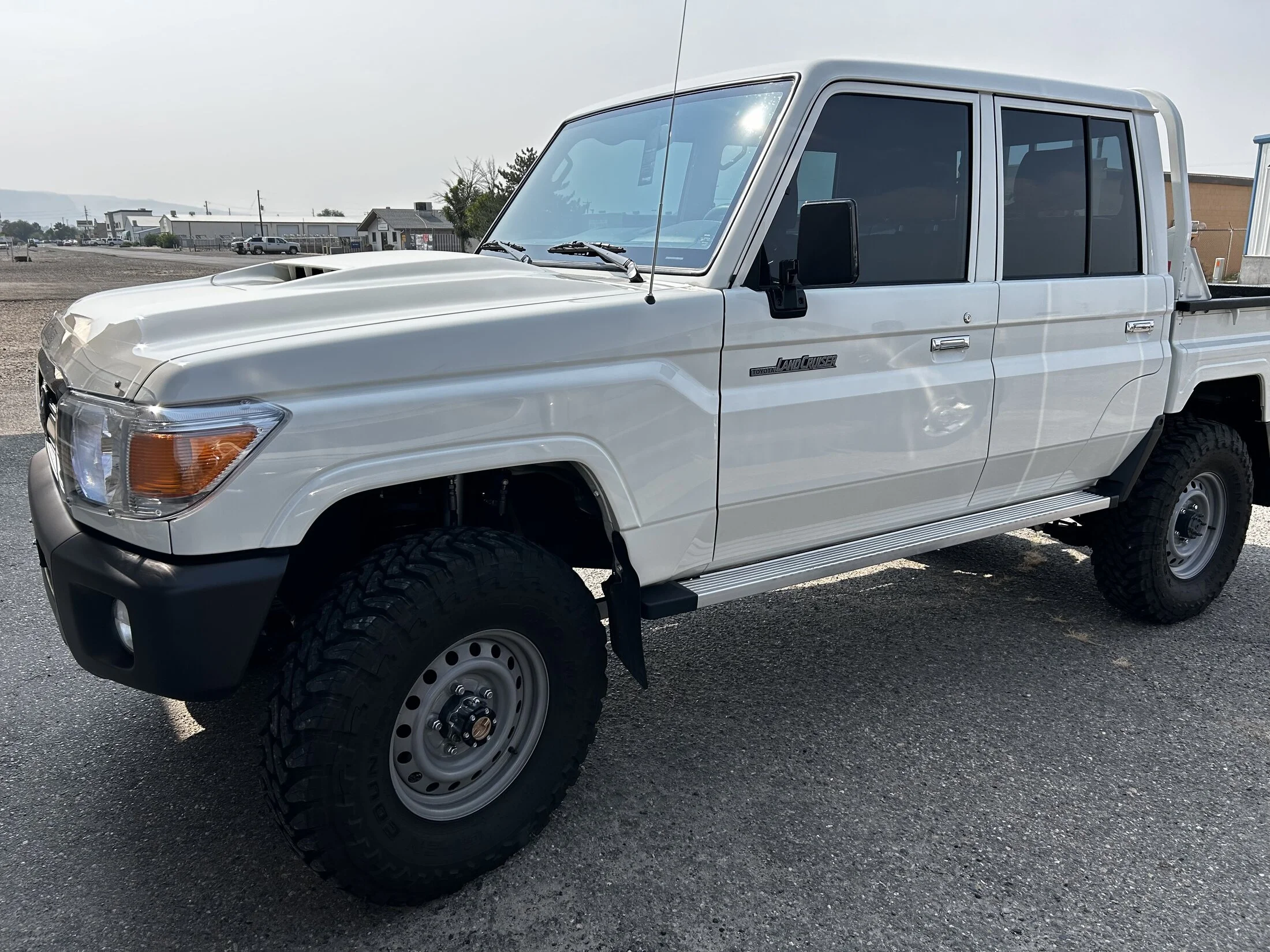

After we picked it up I installed some @TRAIL TAILOR rear extended sway bar links. I also did our first oil change, went to full synthetic at 1,050 miles on the new FTE.
Did sixty miles in it after work up over the mountains and along the river. It’s such a joy to drive and rips hard! No lack of power at all on any type/style of driving. Super good stereo, sound deadening we did rocks as well.
Hand full of things to wrap up and I may be delivering it myself to the owner in the next 7-14 days! 😆

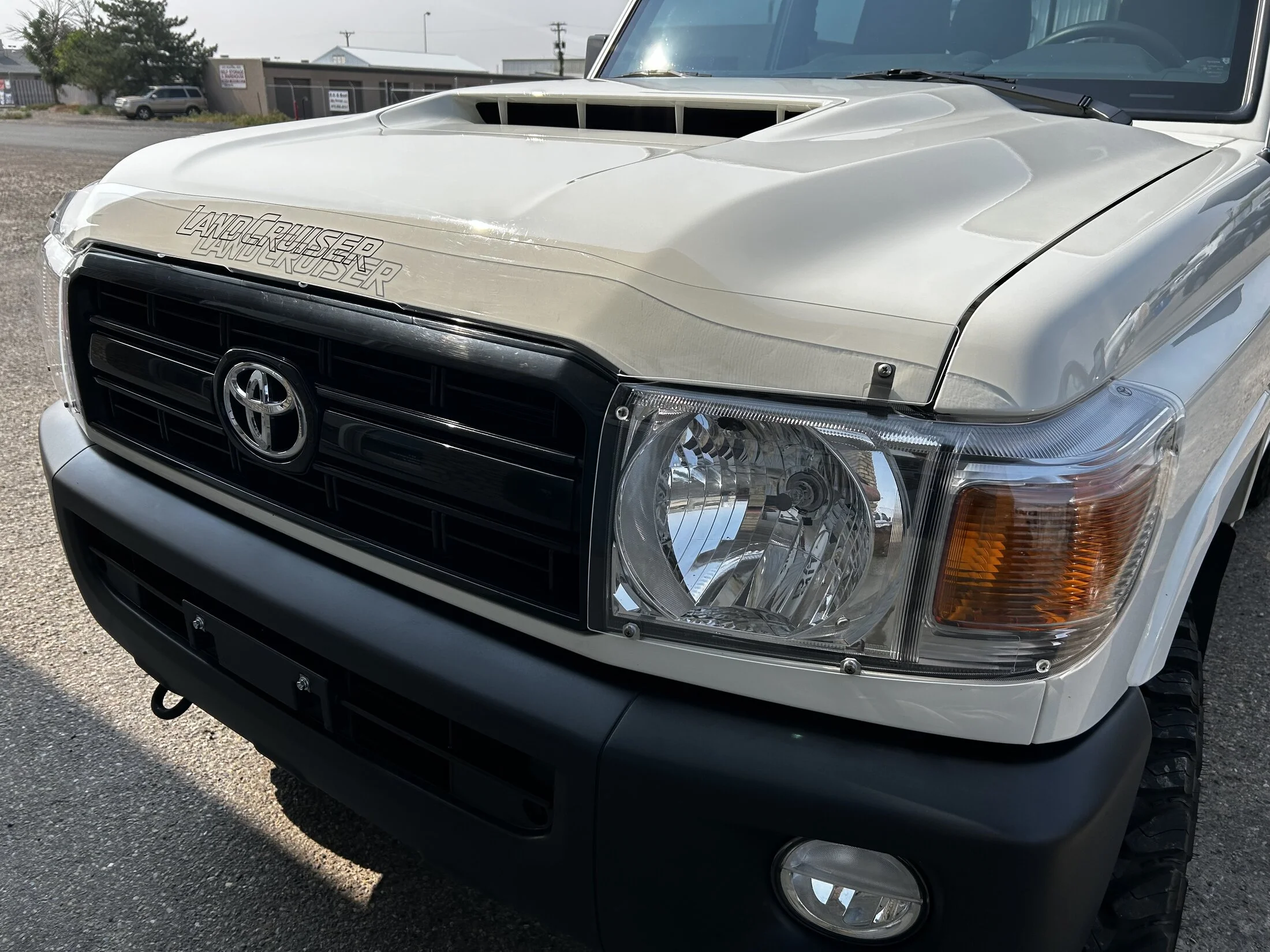

Toyota absolutely dialed the cooling system in on wide nose 70-series. I have not seen a better cooling system in 35yrs of working on cars.
When they went wide nose and the v8, the radiator got really tall. It is really the tallest radiator I have seen in any Cruiser, we don’t work on 200’s or fairly new/modern Cruisers much so I can’t comment in comparison to those. When it comes to 40/60/70/80-series though, the wide nose 70’s absolutely slam dunk the rest in the cooling system.
Something I noticed on this build we hadn’t either noticed or paid attention to in our other 70/80 FT and FTE builds is just how good the radiator and cooling system works.
For example on this build, the top hose and cap on the radiator will certainly get hot, almost to hot to touch. About 1/3 of the way down the core on the radiator you can feel it go from hot to luke warm and 1/2 down the core it is literally cool/cold to the touch. I haven’t seen the bottom rad hose get above slightly warm yet, I mean barely above cold too. Like really I can go run this Cruiser up and over a mountain, shut it down at running temps and 350* EGTs, pop the hood and put my hand on the lower hose and it is much cooler than ambient temps, nearly cold even. This is when it is 80-90* ambient temps too not to mention 30psi and +30 fuel. That’s kind of crazy, never seen such good cooling on an engine especially a diesel.
Granted we did upgrade the orange OEM fan clutch to 20k fluid but we have tested this Cruiser and FTE with a stock fan clutch and with the 20k. Not sure what Toyota puts in the orange clutch but I do know Toyota used 3k, 5k and 10k fluid. We experience no difference with stock orange clutch vs 20k upgrade. I feel the 20k fluid will come into play more when it is 100-110* ambient but regardless it’s pretty obvious the cooling system on wide nose 70’s is absolutely stellar. I contribute a lot of that to the really tall radiator.

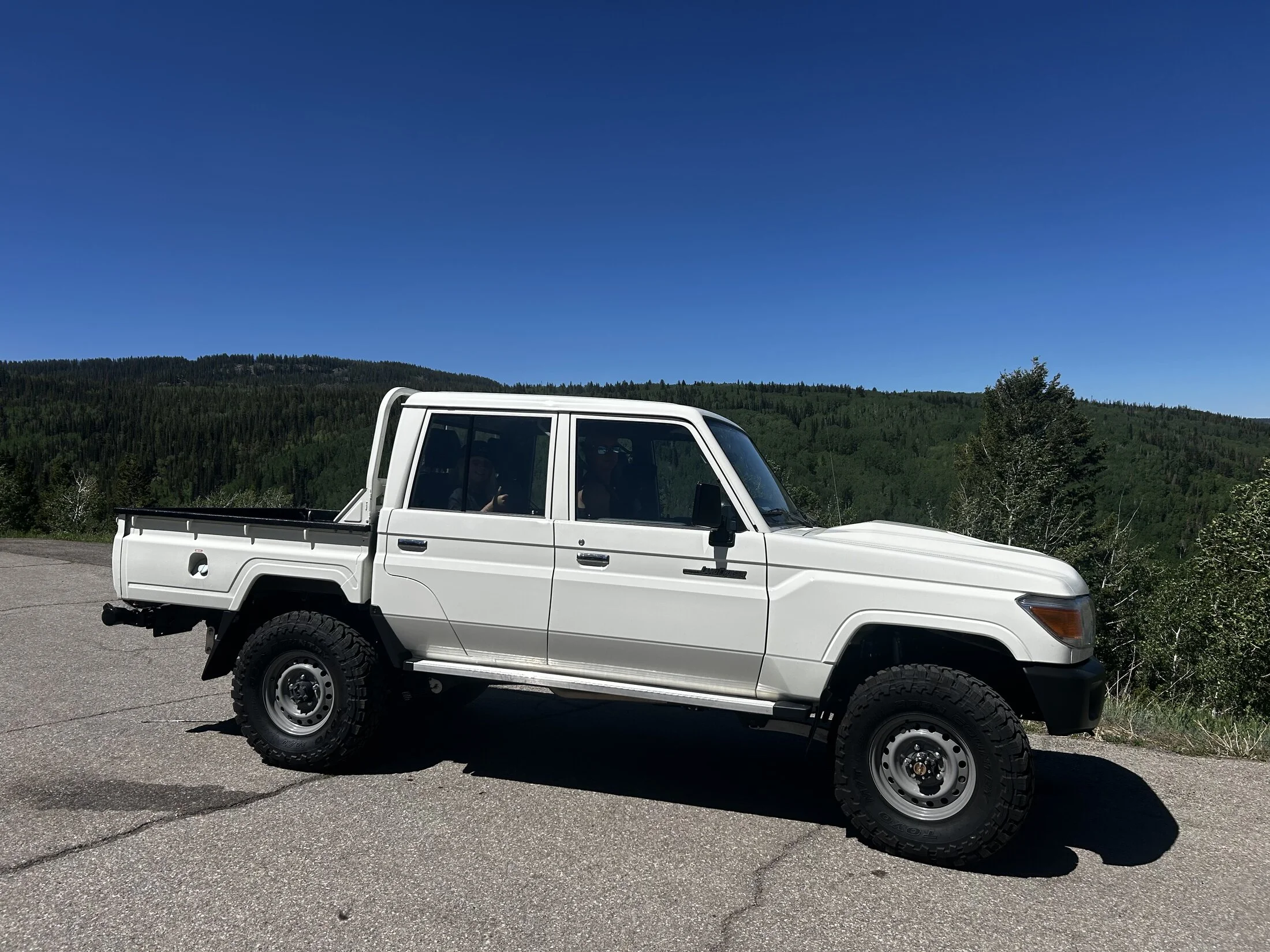

On the road for 3hrs so far. The Cruiser is rocking it!
80-85mph no probs at all, EGTs nice and cool. Comfy ride and the stereo is solid!
