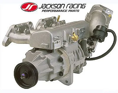

I think if I was starting from scratch I would use an Eaton TVS R1740 and relocate the alternator to the exhaust side and put the supercharger on the intake side and create an intake manifold with a built in a/w cooler like most modern SC's. Could be a pretty slick design for people that want a supercharger.

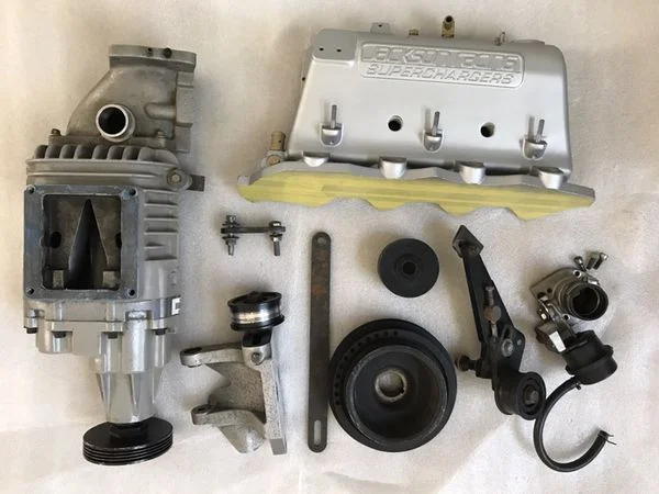

This is exactly what I have always thought. Something like the old JacksonRacing superchargers for Honda’s.
oh that’s pretty cool, yep exactly like that but with an a/w intercooler sandwiches between the blower and intake.
Bingo! I’ve seen someone do just that with the one pictured above. Pretty slick.

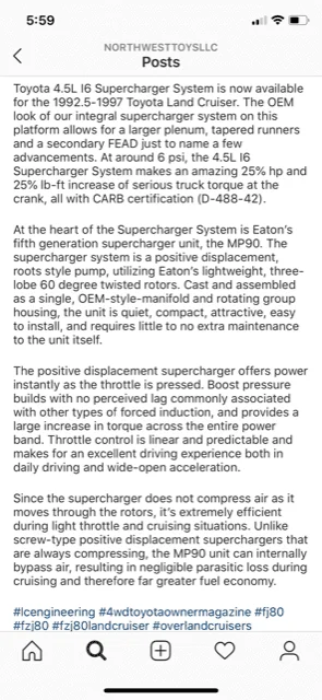

So I was on Instagram yesterday... Which I usually just check to see half naked girls and see what our vendors are building at their shops.
Then I see this post from North West Toys, LLC that says they are going to order 50 units in partnership with LC Egineering. (No clue who either of these companies are)
I see they are doing some updates to the design, I'm not technical in this department so that could be or or bad.
Then the banger retail for $6,695.00, I know the last run was $4,375.00 from Magnuson. Not sure if their improvements are worth a 53% increase in cost.
I called Magnuson and asked if I could buy a unit directly, and was told probably not as they will go threw a distributor, and that nothing has been produced yet.
The Magnuson rep that they had a meeting two weeks ago about bringing back the 80 series program and that they were still in talks.
So just based on the info I have you may or may not be able to plunk down 7K for a supercharger soon.
Please keep this a tech based convo. I know we are going to get 1000000 people scoffing at the price and saying a turbo is better.. and I don't disagree.
