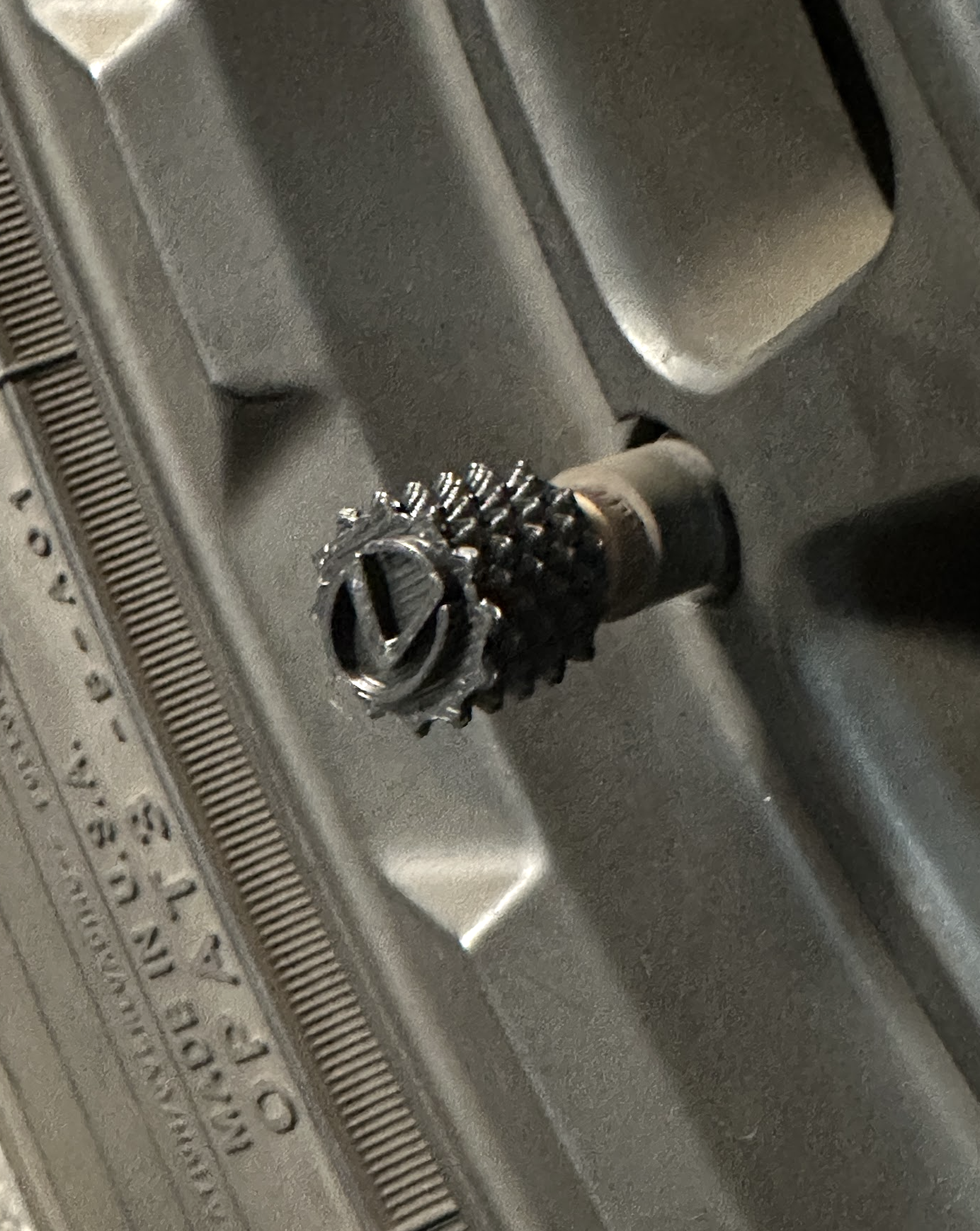

I used my son's 3d printer to print some fun little valve stem caps. Yes, I am a dork.
