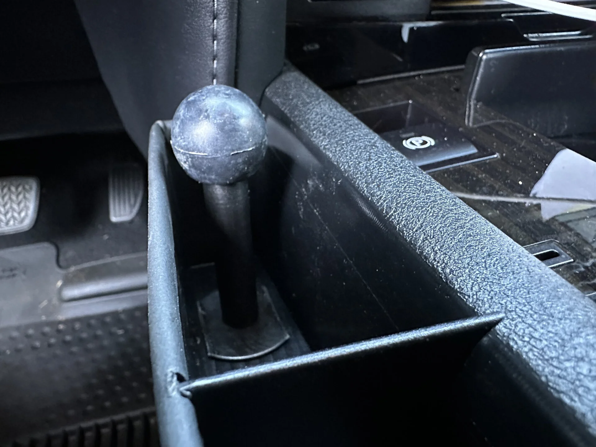

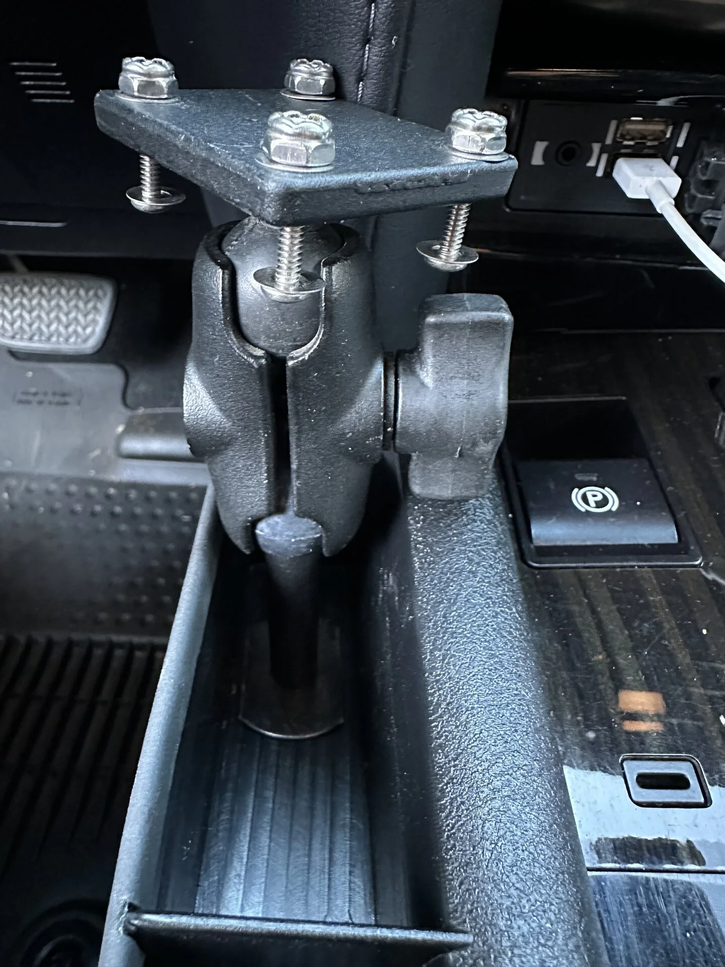

I wanted the storage solution, but I also wanted to mount phones in this location using the pro clip console mounts. This is still a prototype, but it shows where I’m going.
I used a 5/16” round connecting nut 2” long. I used a threaded insert to reduce the 5/16 thread to 1/4” and a cheap 1” rubber knob (with a 1/4” stud) to mount to the connecting nut. The plastic bottom is sandwiched with some 1.5” fender washers.
Results- perfectly adequate/strong enough to mount a phone. Not sure about a small tablet, but I don’t have any concerns about a phone damaging the plastic.
Lessons learned for the next person- fender washers are overkill. The inside fender washer is cut down to fit inside the tray. The outside washer slightly overhangs the sides but it isn’t bad. In addition, the hole looks like it’s close to the middle in the bottom of the cubbie, but it appears to be slightly off center at the top. I’m still troubleshooting this.
Plan to mount the phone next, but a 1” ball is nice and flexible. I’m also going to cut a hole in the rubber insert with a sharpened pipe. More to come ;)
Nice work!
