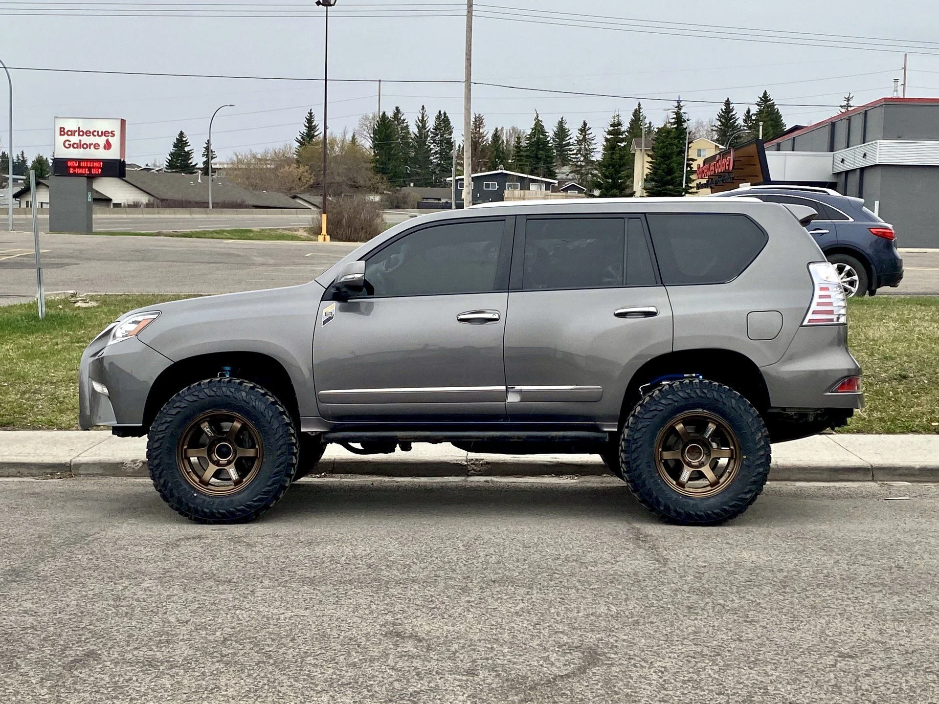

Hey everyone,
I'm sure most know about the topic, between landcruisers, 4runners and the 150, we have seen KDSS equipped Toyotas with either a lot of lean, little to none or none at all. Can any of you help me or make any suggestions.
I have tried this
It did not really do anything. On the most part I see from .75 to over 1 inch of difference sometimes.
Any help or experience would be appreciated. Pics

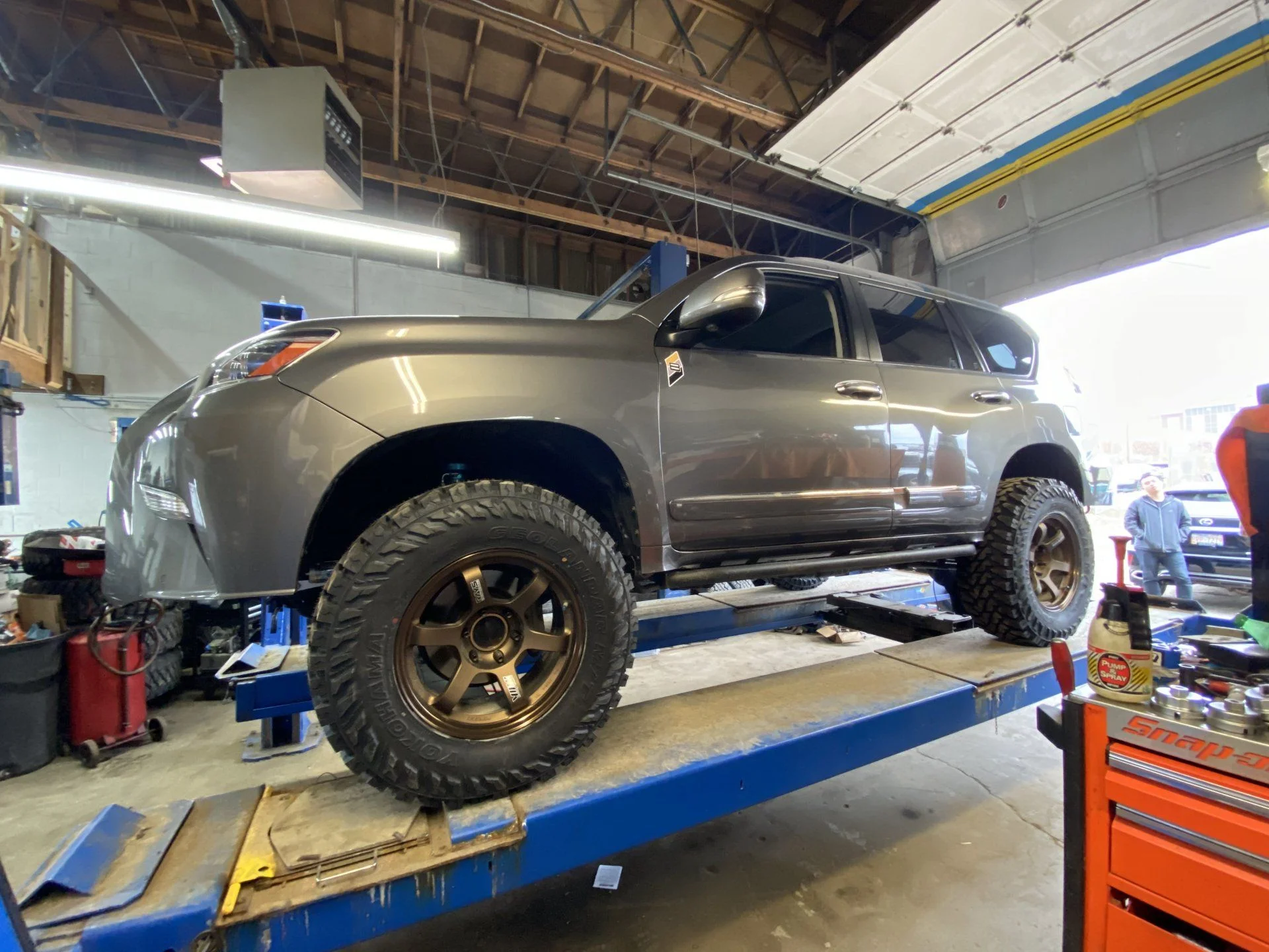

I could see a lean but waited until I drove it a while so the new suspension could settle. Before the ift I usually had a 1/4” lean in the front and 1/8” lean in the rear. I believe 1/2” or less is acceptable according to Lexus. These measurements were taken inside a garage on a flat floor.
After the lift install, parking in the same garage, I get just under a 1/2” lean. Parked on slightly uneven or sloped surfaces I can see a 1 1/2” lean. I don’t minedthe lean being so much on an uneven surface, but the 1/2” lean on a flat surface sometimes bothers me, even though Lexus says it okay.

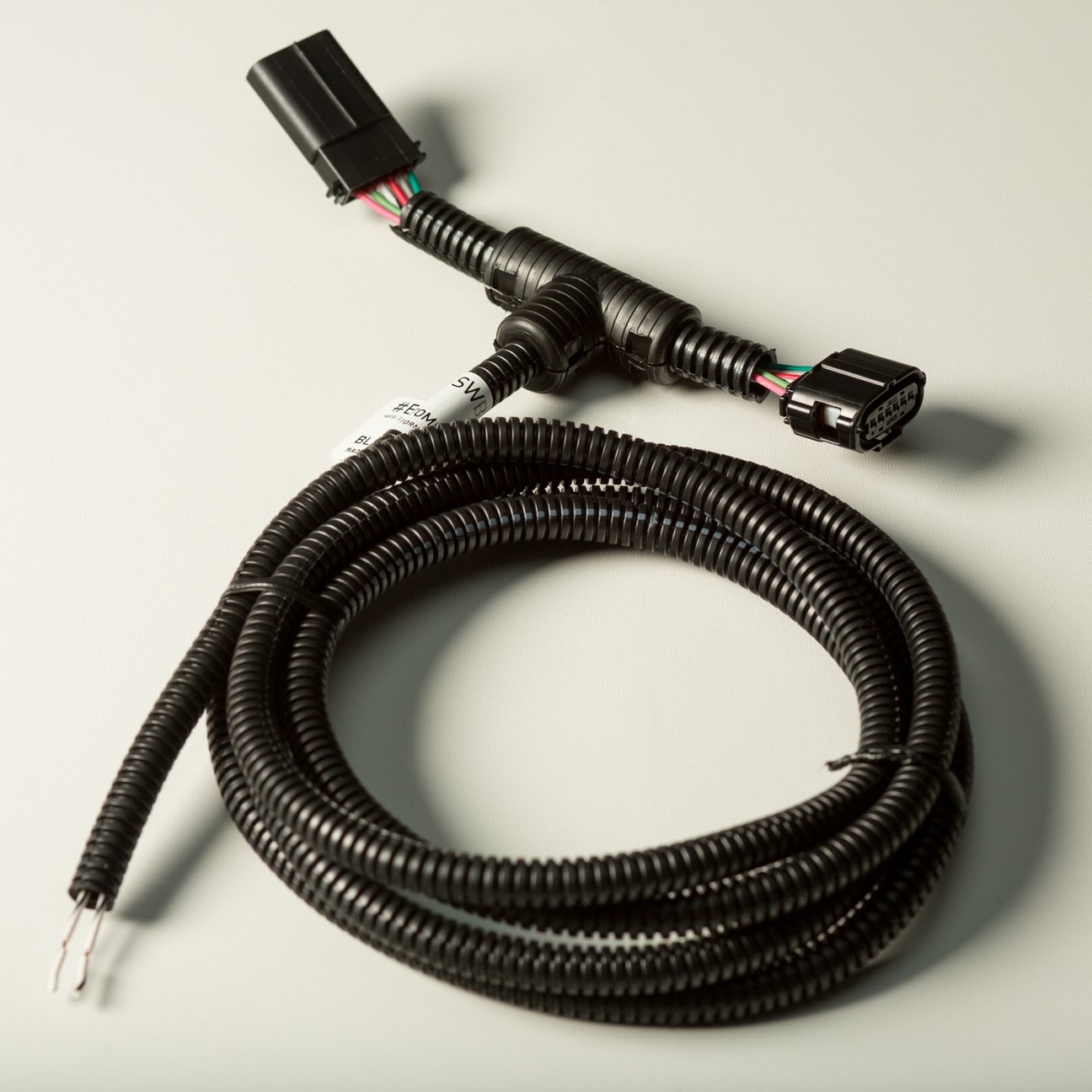

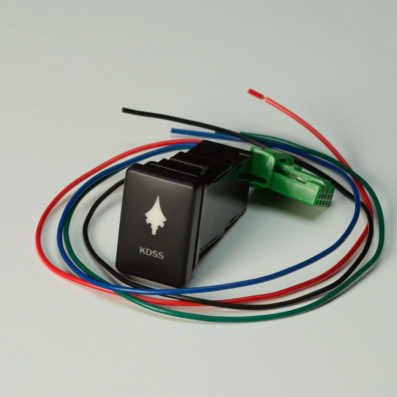

Feedback from Blackgate Customs: "We don't have full production photos yet, we're working on getting the last oem connector to make it fully plug and play. Everything else is ready to go and we've been testing a pre-production version for months now on our KDSS 4runner. @blackgatecustoms and @bg_4rnr on Instagram are where most of our postings go and we've been updating with the progress on the switch and all of our other products as well."
"And the 4Runner/GX460 are identical underneath so it will work on the 460. We don't have a 470 to test on, but we'd love to see if the connector/electrical control portion of the system is the same because then it would work. I'll head over to that group and maybe we'll be able to find someone who would be willing to either take pictures or drop by and let us check it out."
