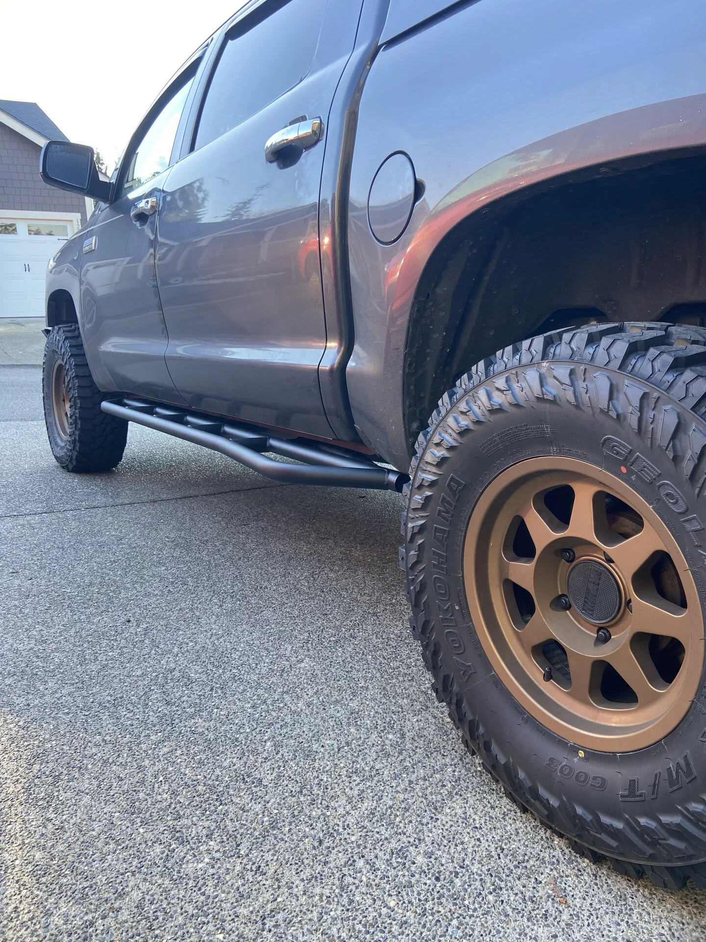

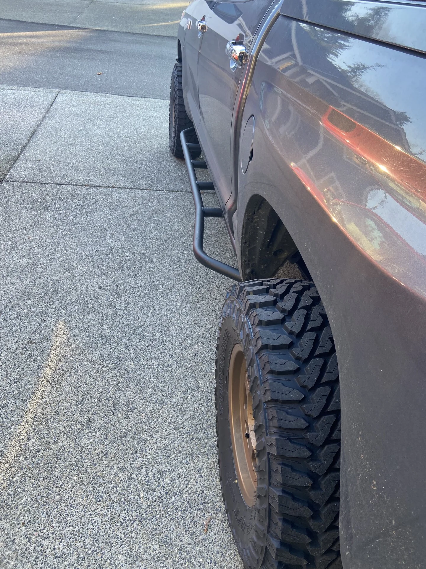

Just picked these up locally. Guy said he was drunk and accidentally ordered for a crewmax and he’s got a double cab 🤣. No wait time and saved $400 🤷🏻‍♂️
Ha-ha-ha! And you don't even have the tread plate! Just tubing.
Ya for sure. But the plate can be installed afterwards.

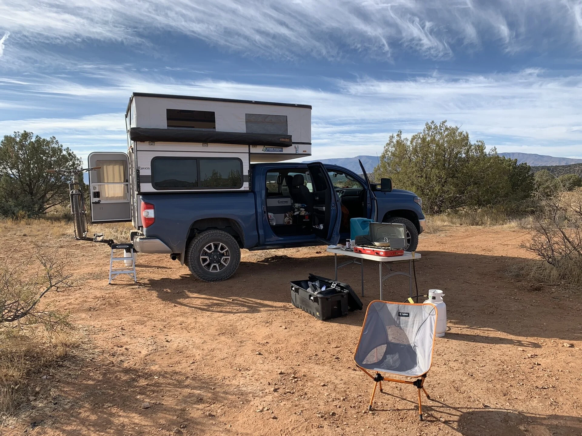

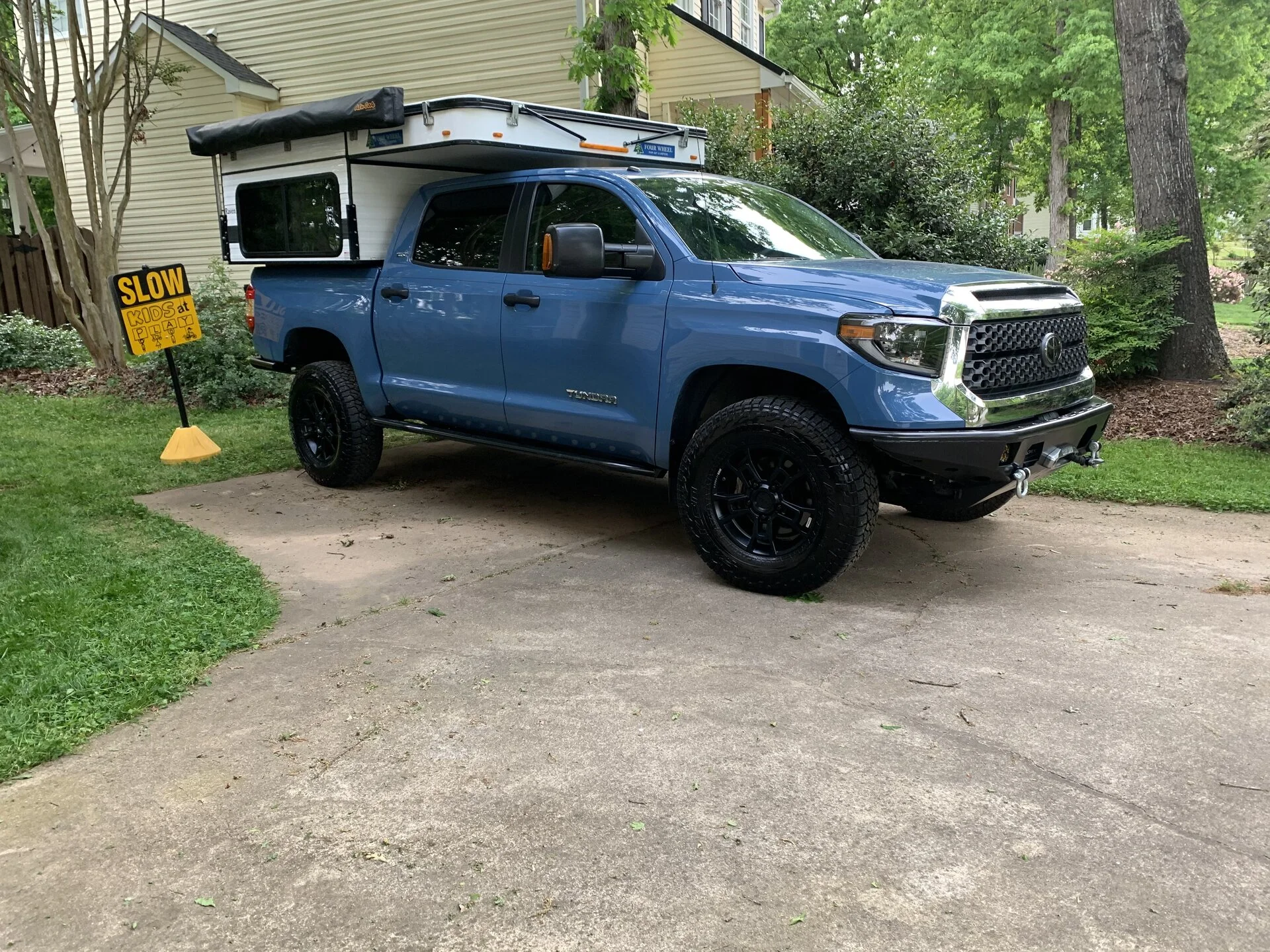

Can’t wait for my high clearance rear bumper with dual swing outs. Now I have to decide on a camper. Either four wheel camper for a 28’ travel trailer.
Must be nice to be stuck with such difficult decisions! I'd be happy if I had the space at my home for a 10' adventure trailer to put my RTT on!
