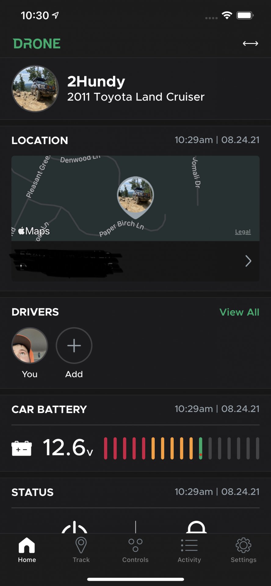

I will say Bestbuy did mine. But it’s a guy I’ve know for years and truly trust him. You can catch them on sale some times for $299-$399 installed. As you’ve figured out compustar is the “same” as drone. I’ve run compustar on many of my vehicles and never had an issue. Will say the app is great. The fact I can track my truck if it where ever to get stolen. Also I get an alert every time it turns on and off. Can do everything from the app. Also the watch app is cool too nicely laid out. and Can tell Siri to unlock or start the truck.

The app is very responsive. So far so good.

It is too easy. They will send you the cellular modem with a small harness to connect it to the remote start box. Once you plug it in you wait for the green and red light to stop flashing. Then you setup the app using the serial number off the modem. Mine came with two extra stickers containing the serial number and IMEI so it was easy to see and I stuck it in my manual so it is easy to find. The how-to video in the support portal is spot on.
