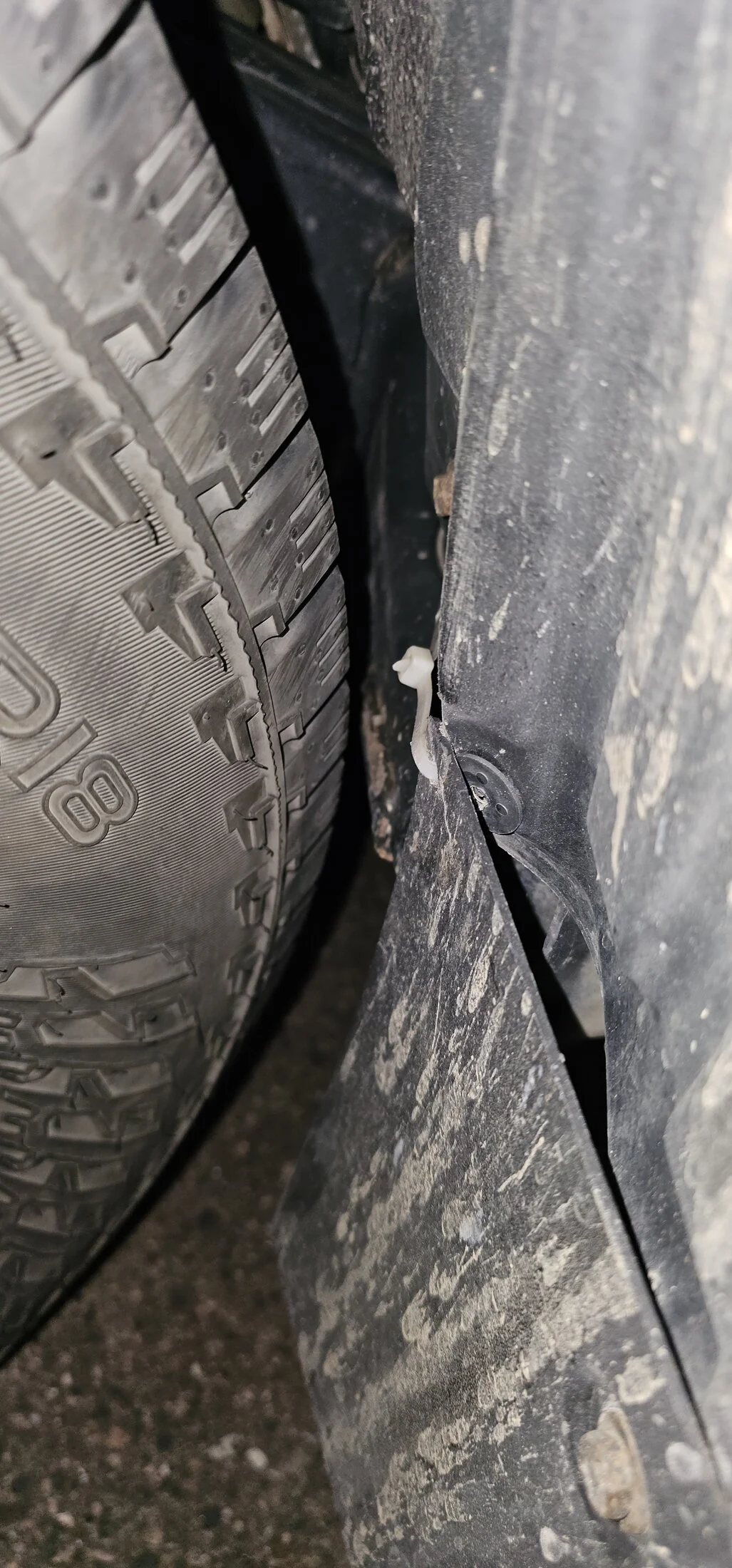

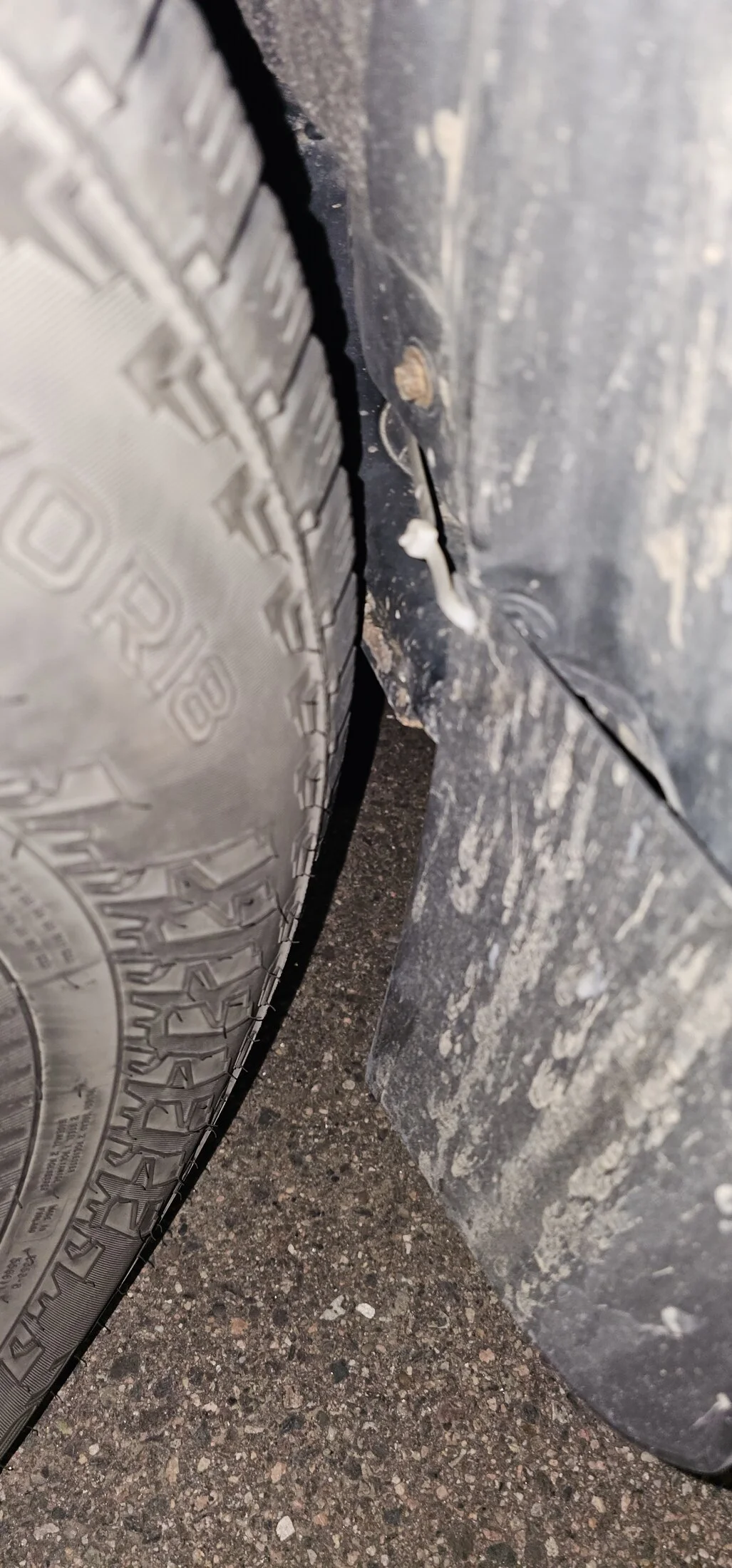

Add parts of a Finnish origin to the grab bag on my truck. Had Nokian Hakkapeliitta LT3s put on my OEM wheels.
They are a 275/70R18 which is becoming more common. It's 33.3" tall and roughly 11" wide.
Weight in around 53lbs with E load range.
They feel good, very solid. Less flexy and airy than the Revos.
Now I have 2 rigs ready to snow wheel. 🏔
I have maybe 3/8" of clearance to the Body mount with these 275/70R18s on OEM wheels.
Discount Tire is getting me back on the road for a minimal fee.

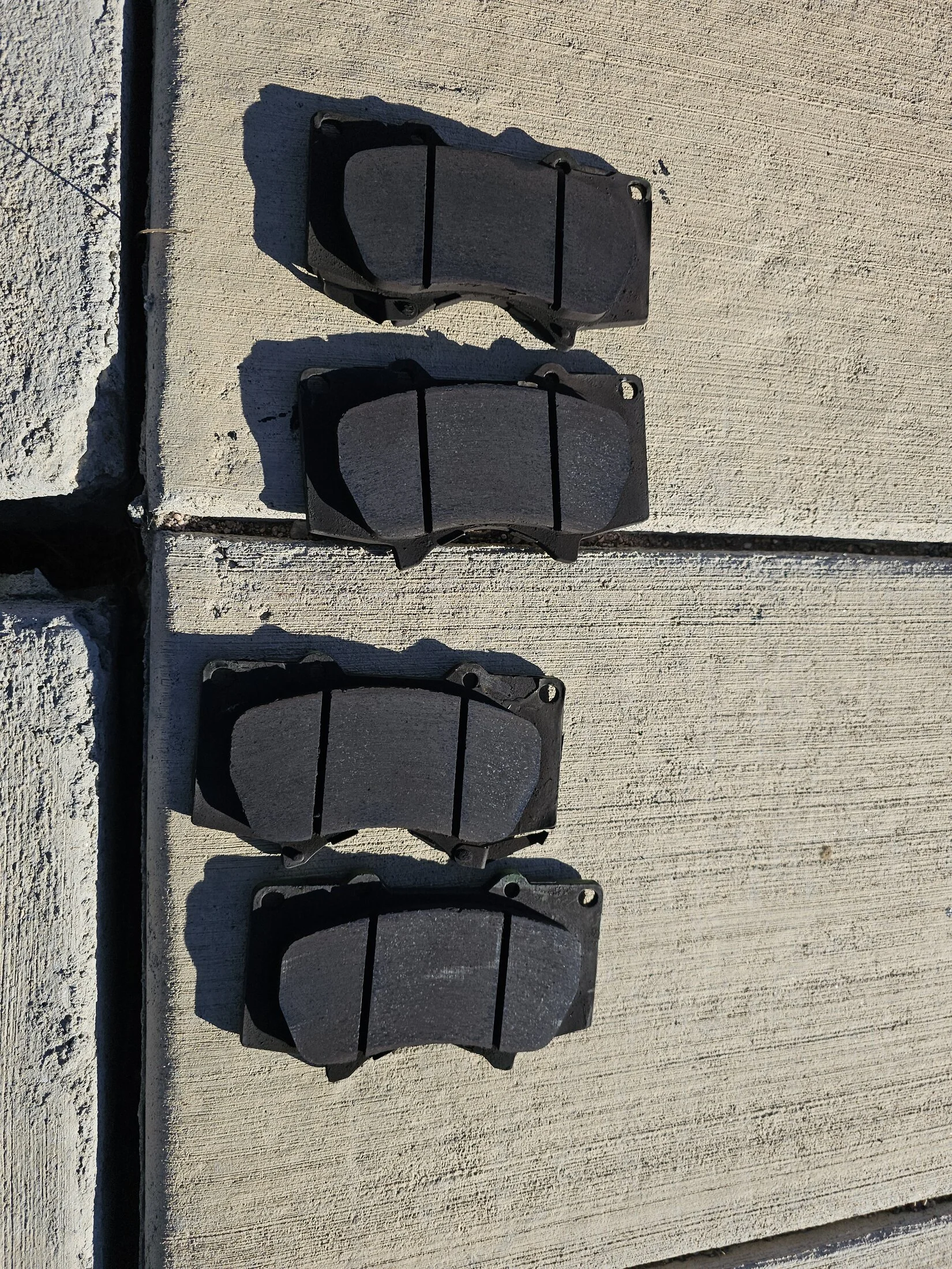

While I was waiting for my truck I ordered a set of EBC Red Stuff pads.
I smoked my green stuff pads, quite literally, dozens of times now and they are very glazed.
I take full responsibility for this one, as the green stuff pads on Alex's 4Runner are great. Even in their glazed state, it doesn't push through the brakes at stoplights like my previous brakes did.
Front pads are such an easy swap and with all new hardware it will be a quick install.
  • Like
Reactions: r2m

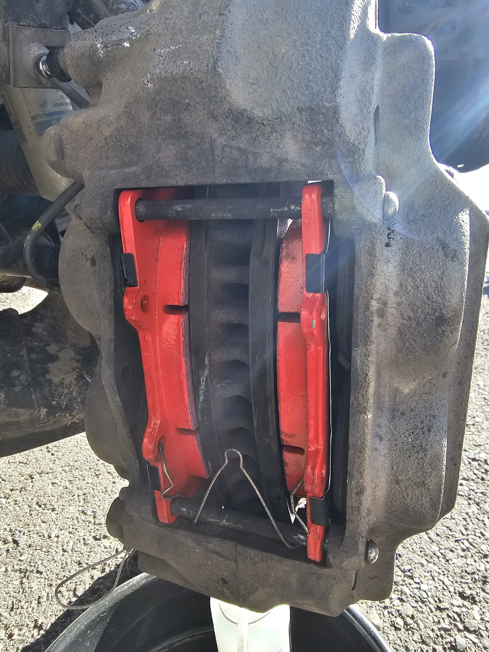

My mistake, they were the orange stuff truck pads. Should be more appropriate for my use.
Out with the old and in with the new. Pulled out my glazed Green Stuff pads. Again totally Operator caused. Excited to see how the orange stuff pads do in the mountains

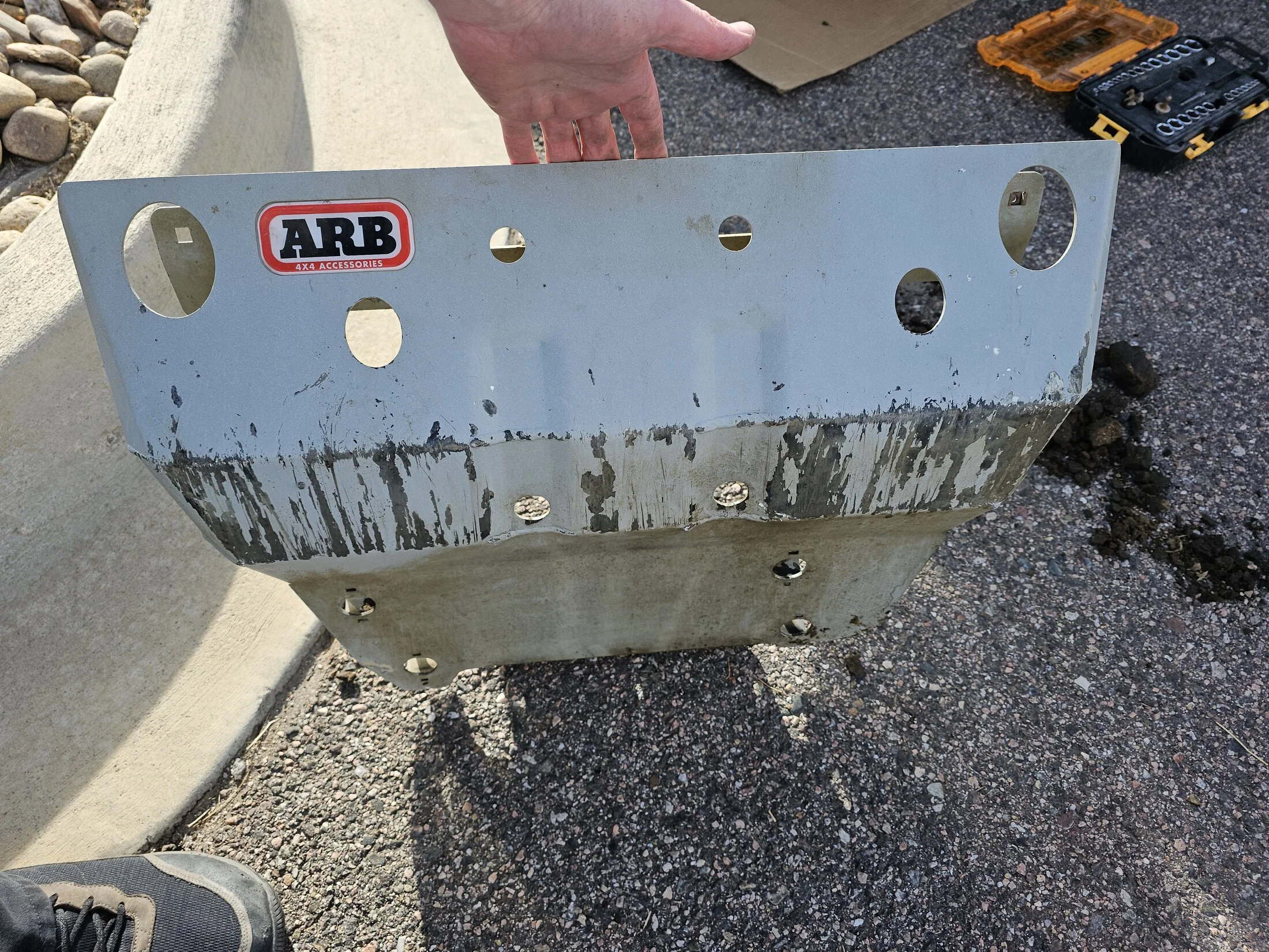

My skids are broken in.

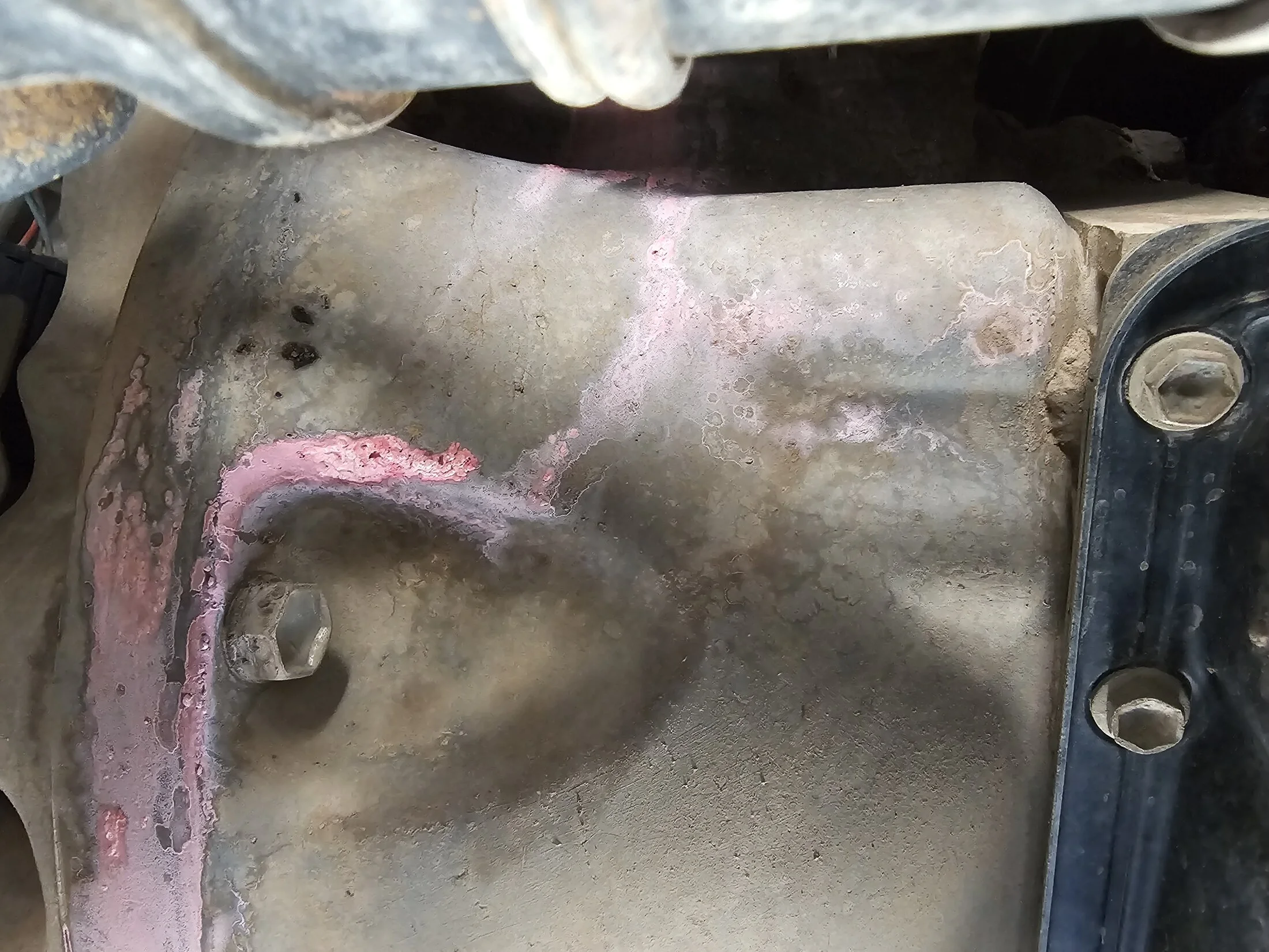

And it looks like the truck will need to go in for a valley pan gasket replacement
