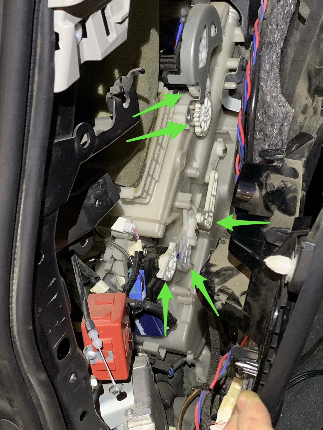

There are a surprisingly large number of plastic gears associated with the AC system. Sounds like a spinning gear with broken cogs or spinning on the motor...or something.
Have a look at the CRAZY internals behind the driver side quarter-panels for just a “few” of these gear-like toothed cog wheels & levers...
It’s amazing how much is crammed into every nook and cranny of the 200. No wonder they look a bit “pudgy” when stock.

My dealer btw is Toyota of Dartmouth (MA). I'll post solution if problem reoccurs and I learn anything new. As stated previously, tech was confident it was DVD/ NAV related but I have greater trust in the expertise on this board and Markuson's pic was pretty eye opening.
