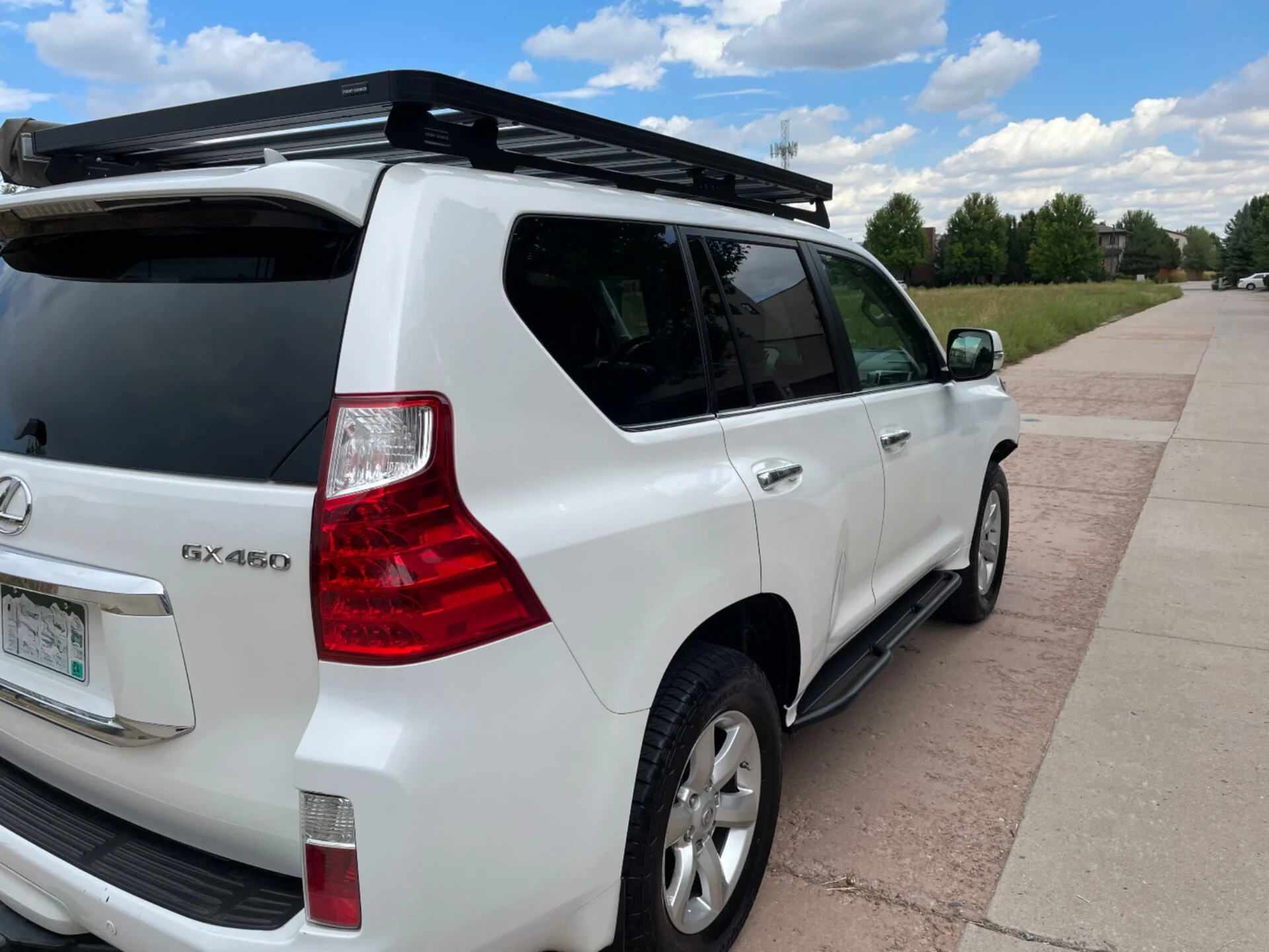

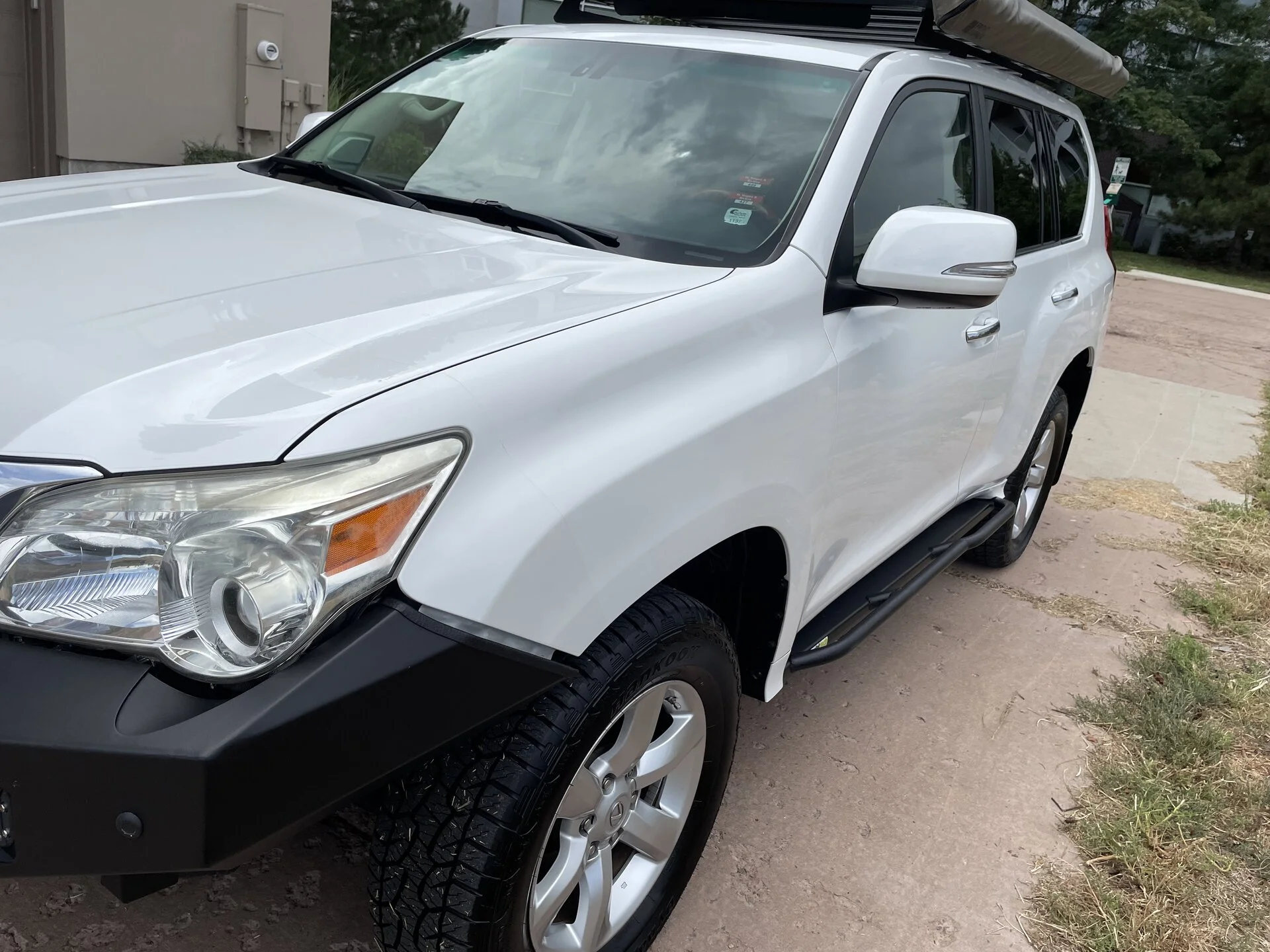

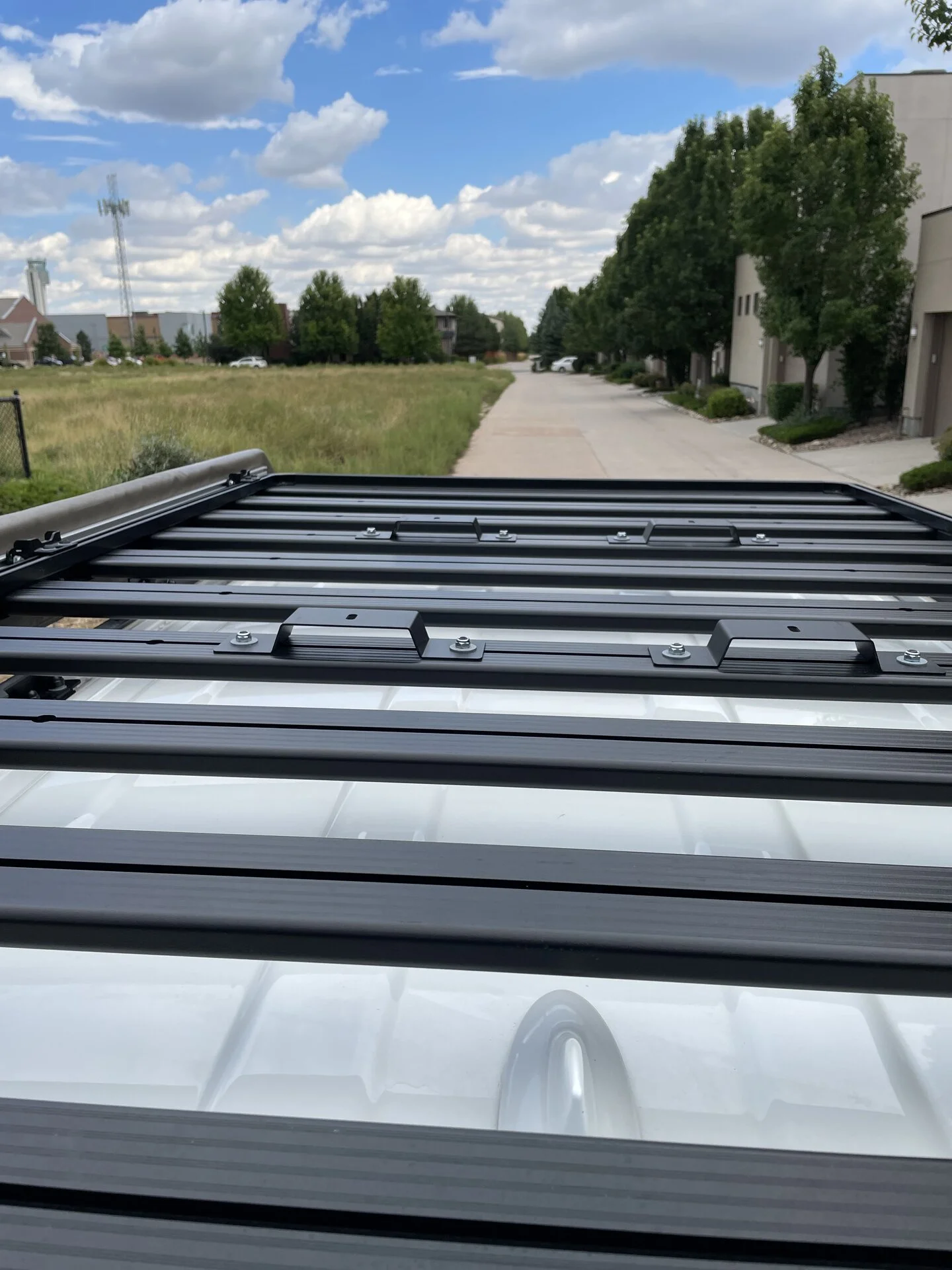

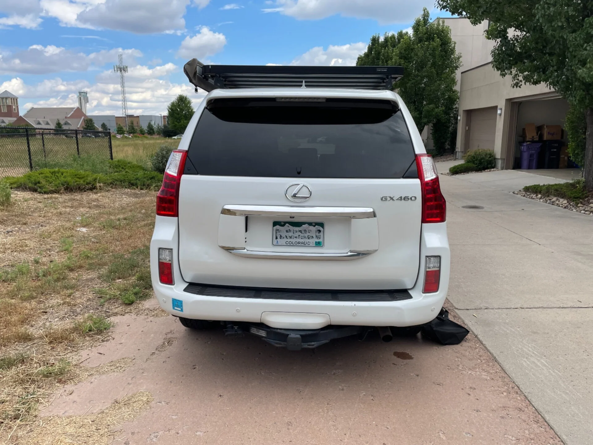

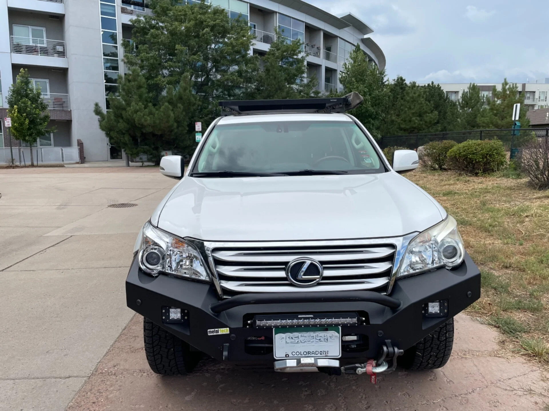

In 2020 I started modifying the 2011 GX460 I bought in 2011. Some photos are attached. In early 2021 I did some off-roading with her in Florida in the Osceola and Apalachicola National Forests. Very light going ,though I bent and had to replace the control rods after taking potholes too fast in Tate's Hell. No swamp stuff, mainly logging roads. I've had her in Colorado since June 2021 and basically used her to get to fly-fishing water and well maintained parking lots on the South Platte, White, Arkansas and Colorado Rivers and Clear Creek. A little off roading near Grand Lake and Lake George. I planned to put a tent on top and then thought I'd just camp in the GX but I haven't done it. I plan to list her for sale but first I want to say thank you for all the information. I've used it.

Looking good. I've also got the metal tech bumper. Love it.
  • Like
Reactions: r2m
Yep, my front and rear are both MetalTech too.
Albeit, I don't care for their sliders, I replaced them wider with ones, but that's my style.
I like the Metal Tech bumper too. I put a Warn Zeon 12-S winch behind it.
I trained with the winch but never had to use it. I know I can get the rope out ok in an emergency, but winding it back neatly would be a mess because I cant see the drum from outside or under the hood. So I don't practice with the winch, which is not good.
I have the Smittybilt X2O GEN2 10K Waterproof on my MetalTech and have had no issues using it or respooling the line. Just turn the lever on the clutch and pull the line out. Turn the lever back to engage and when ready to winch. When done, while wearing working type gloves, just put a little tension on the line as it spools back in, making sure you go back and forth (left and right) as it spools so you don't bunch up the line. I can see the spool fine through the fairlead.
Then sometime when you get home find a flat spot or slight hill, unspool the line again and with your wife's car (or who ever's), pull the car in with the winch so there's some good tension on the line as it goes in, making sure the line is spooling in left and right, evenly filling in the spool.
