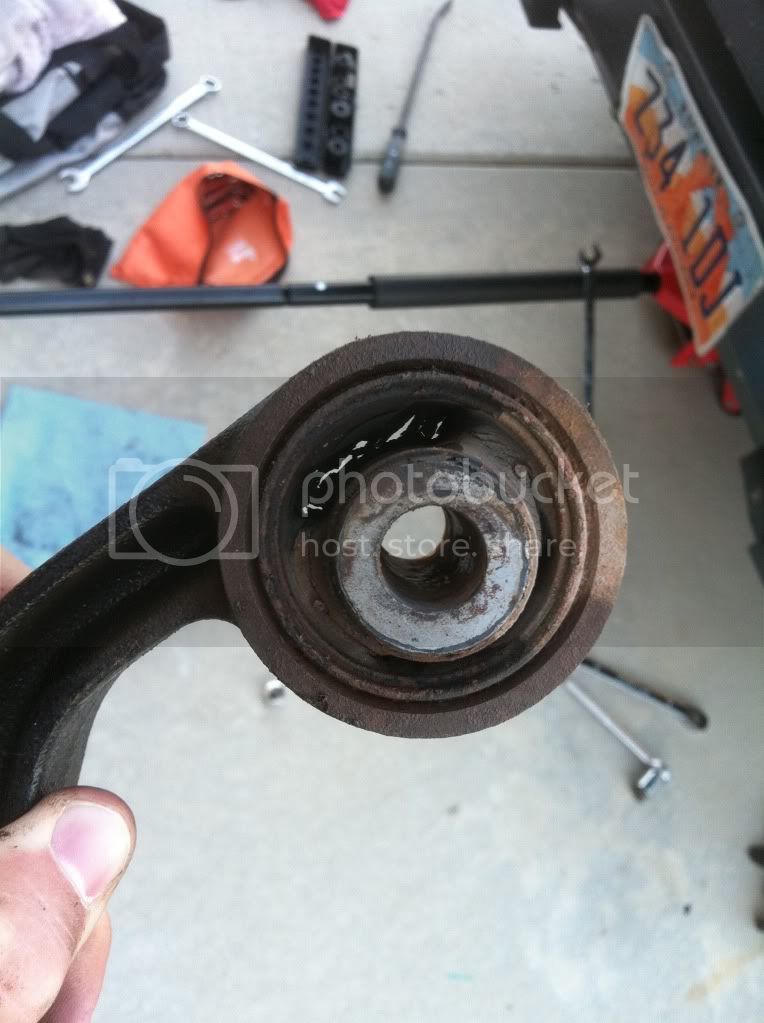

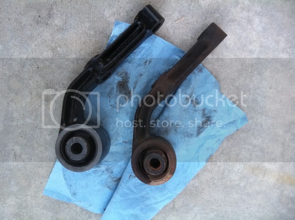

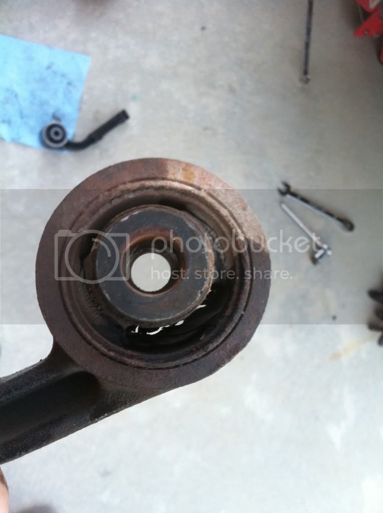

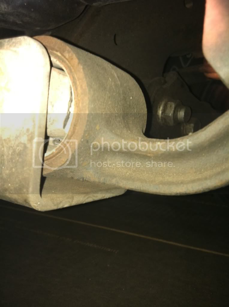

Found another 200k makeover need. Took the family into Canyonlands over Labor Day - Elephant hill to Chesler Park - but before we left I crawled under and around and found the front axle support bushing cracked and done.
Pulled it and was suprized at how easy it was to rotate the bushing. I was getting some axle movement I'm sure.
Other side
I was amazed that the bushing had moved completley off center and was pushed up against the wall of the support housing. I had to use a floor jack to move the axle back a couple of inches so the bolts would line back up with the new support and bushing. Removed more thunk in the driveline and felt solid wheeling all weekend.

Interesting that you posted that front axle support. I was looking at mine and noticed that it had a fair amount of wear. It's not completely gone like yours, but I mentally put it on the to do list. $106 for a little brace! Yikes!
$106 is a deal - I paid $123.
From Toyota Auto Parts at Toyota Parts East | Genuine OEM Toyota Parts , I'm guessing 52380-60040, but always good to doublecheck with the good folks at Camelback... ;)
BTW, these seem to be the only guys around with a site that Toyota hasn't shut down their parts diagrams on.
I've been using Toyota of Dallas when I just want to order something quick after hours and Beno's not available. Diagrams seem to be working fine. I know that toyotapartszone.com is going through a similar thing with theirs.
ToyotaPartSales.com
52380-60040 - That's the one.
Another 100-guy in our region had the other front axle support bushings wear out on him. Mine are still good but you should check them while you are down there too. Part numbers - 41653-60020 and 41654-60010.
