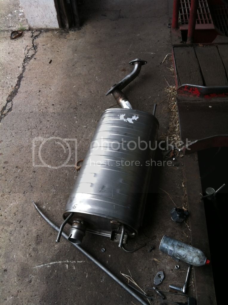

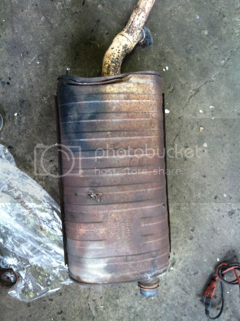

I pulled and replaced the muffler last week - put an OEM back on.
Out with the old
In with the new
I was amazed at the increase of power. I think my old muffler was so rusted and corroded that the air flow was not what it should have been. Plus the huge dent it took at some point didn't help either.

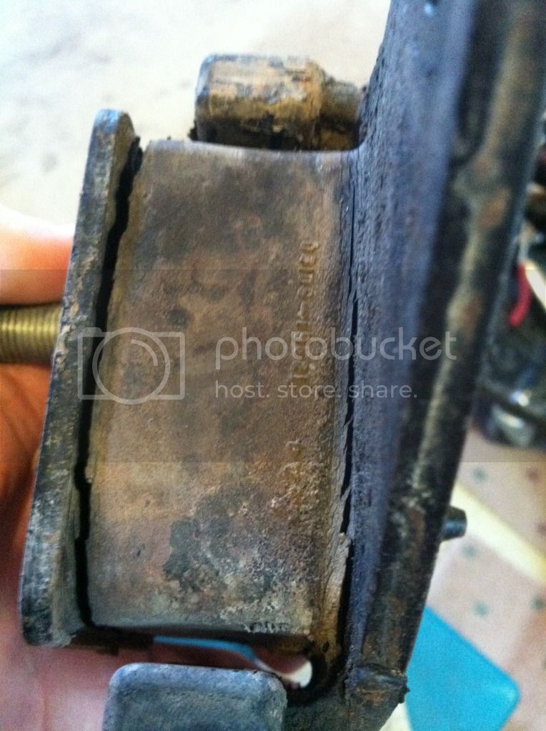

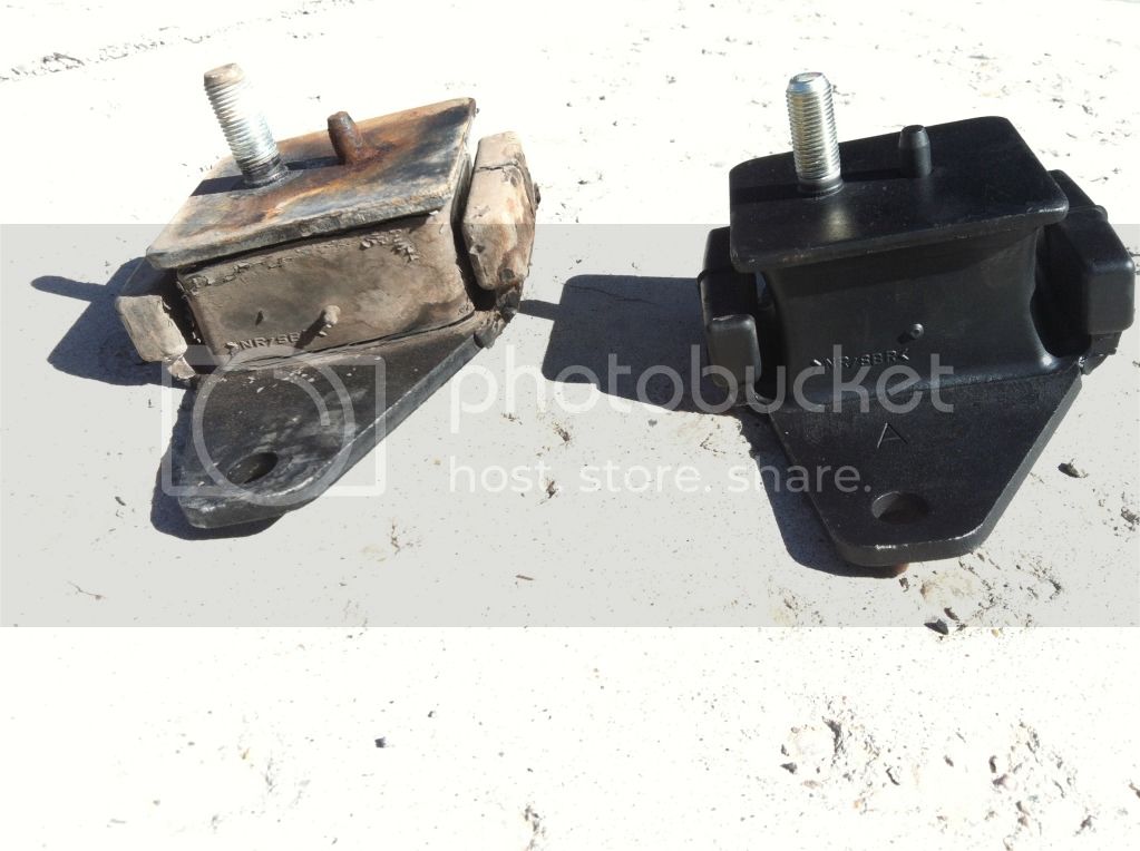

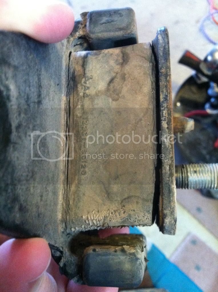

Got around to swapping the motor mounts out. It wasn't very hard to do, especially after soaking them in PB blaster. The old mounts were severely cracked and had 3-4 inches of play in them. After swapping them out - we drove to the Oregon coast and back from Utah - 2,000 miles. The difference in vibration in the truck is amazing. So much quieter. Well worth the time and money to do.
Old and new so you can compare the difference in the two. Notice the height difference.
Right side mount. The rubber was also compressed and just smushed to death along with the plate being separated from the rubber.
Left side mount
